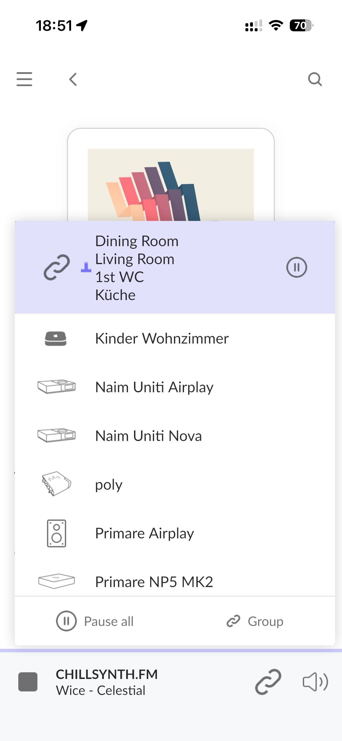

Hello everyone, since yesterday my HomePods have no longer been staying in sync with my other AirPlay speakers when I group them. The non-HomePod speakers are all in sync with each other, and the HomePods are also in sync among themselves. However, compared to the other speakers, the HomePods are playing back with a delay.

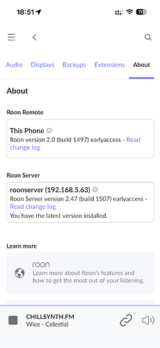

Roon 2.0 Build 1497.
First of all you should update to the current version of EA (B1507), then check if the problem is still there
Thanks for the tip. I did that and then switched to the latest stable version. The problem still persists. When I use Airfoil or AirPlay 2 directly from my iPhone, everything works—so I believe it has something to do with Roon. Is anyone else experiencing similar issues?

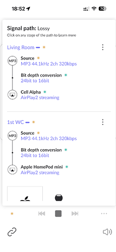

• I have a Mac Mini M4 running as my server, with an Eero 6e network.
• The Mac Mini is connected to the Eero via Ethernet.
• My HomePods (mini and 2nd gen) are on software version 18.4, and I’ve grouped them with my Syng Cell Alphas in Roon via AirPlay.
Everything worked flawlessly until a few days ago, when the HomePods started lagging compared to the other speakers. To rule out other possibilities, I tried:
• Streaming Apple Music to all speakers (including the HomePods) via AirPlay 2 from my iPhone without any issues.
• Grouping my Syng speakers with my Naim Uniti Nova in Roon via AirPlay, also without any issues.
• Grouping only the HomePods in Roon, and they stay perfectly in sync.
So everything functions as expected—except when I group the HomePods with other AirPlay speakers in Roon.

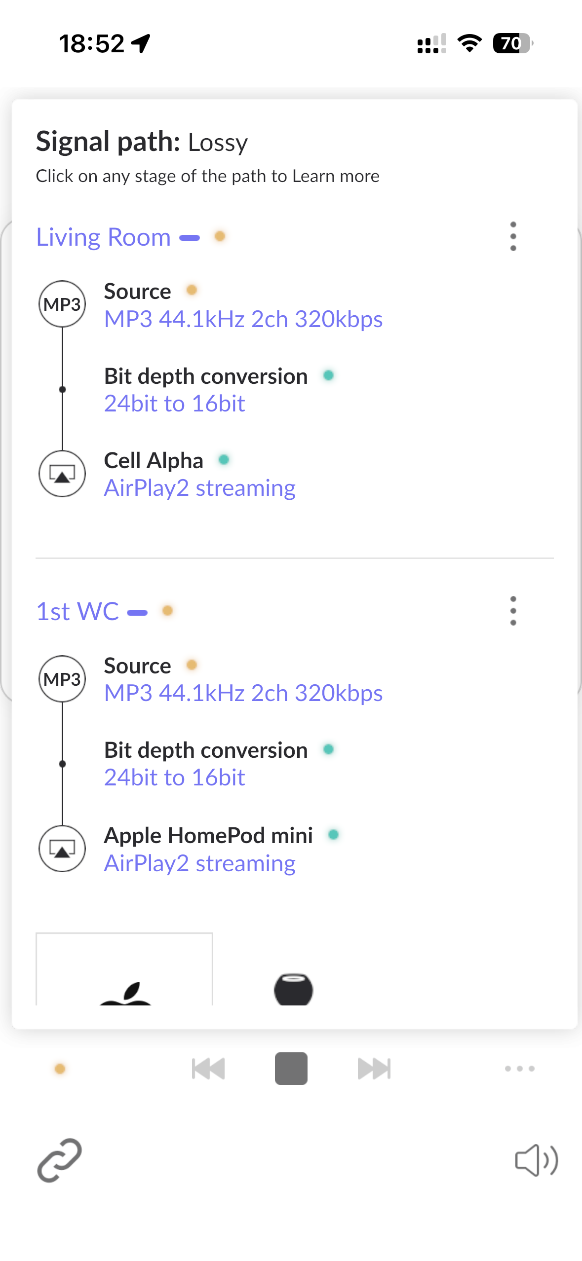

Based on your screenshot, it looks like you’re playing from a radio station - do you see this delay no matter the content you playback?
How are the Homepods connected to your router / network versus your other devices?

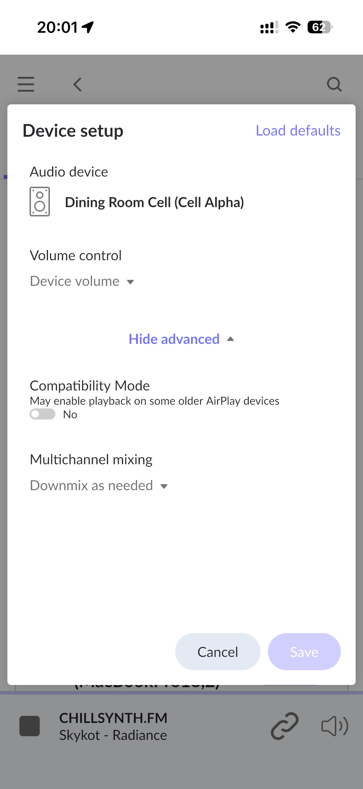

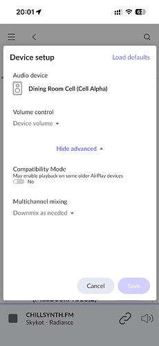

perhaps testing out using Resync delay on the other devices may help keep things in sync with the home pods. Resync Delay introduces a brief buffer before playback starts, which can help compensate for latency differences between devices.
To do this:
  • Go to Settings → Audio in Roon.
  • Find your endpoints other than the Homepods under the AirPlay section.
  • Click the gear icon → Device Setup.
  • Look for the Resync Delay option and start with a small value (e.g., 500ms).
  • Gradually increase if needed and test playback.
Let me know the results, thank you! :raised_hands:
Hi @ivan
Unfortunately there is no such option for the AirPlay speakers
