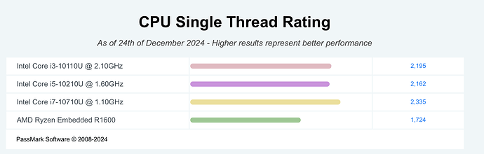

The AMD in the 923+ is still no speed demon, though, and you have a library that Roon considers as „very large“ and requiring a very-high spec system.
This is how the AMD compares to NUC10 (which isn’t the fastest NUC around) in single thread speed:

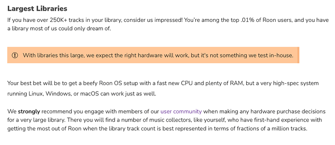

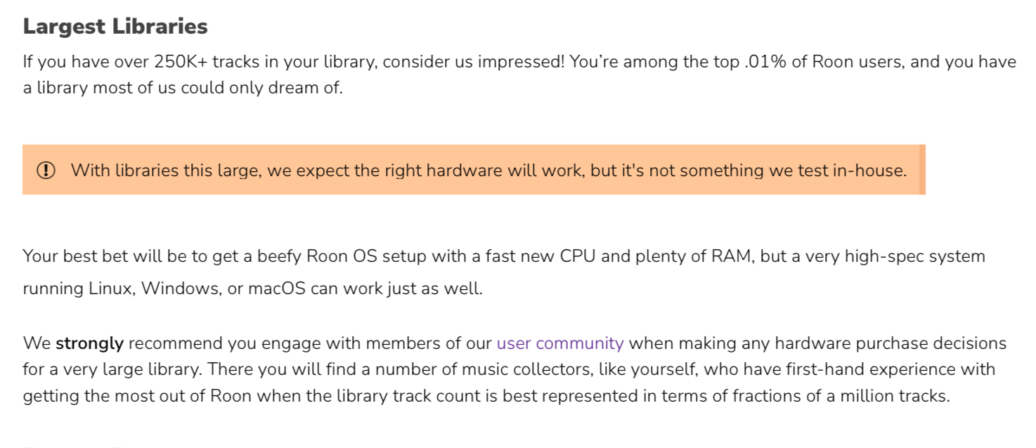

And what Roon says:
It may work for you, depending on your library, or maybe not. Maybe someone can confirm who has the same model with a library of comparable size

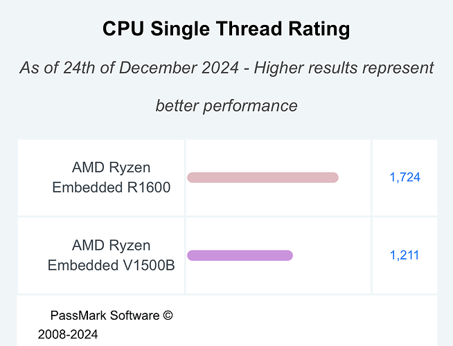

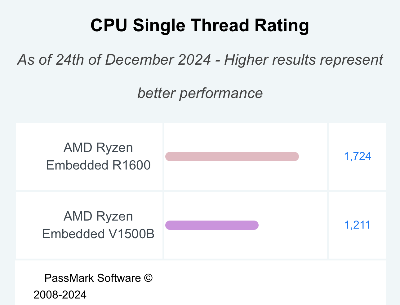

Is it? I’m not a Synology expert but according to the Synology website it has an AMD Ryzen V1500B, which seems to be slower in single core performance?
https://www.cpubenchmark.net/compare/5117vs4304/AMD-Ryzen-Embedded-R1600-vs-AMD-Ryzen-Embedded-V1500B
