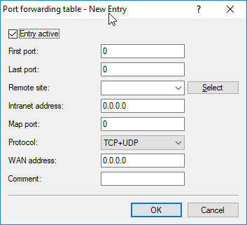

Digging around a little for instructions specific to Lancom, I believe you’ll find an index of port forwarding rules that you can manage by entering the administration page for your LAN and navigating to IP router > Masquerading > Port forwarding table. It’s known as “inverse masquerading” in the parlance of Lancom’s systems.
You’ll need to specify a start and end port. The interface should resemble the one below. These port assignments should be identical and should match the Port number listed in Roon → Settings → Roon ARC (usually in the ~55000 range). List the static IP address of your Roon Core in the Intranet address field.
You can read more here: Port forwarding (inverse masquerading)
