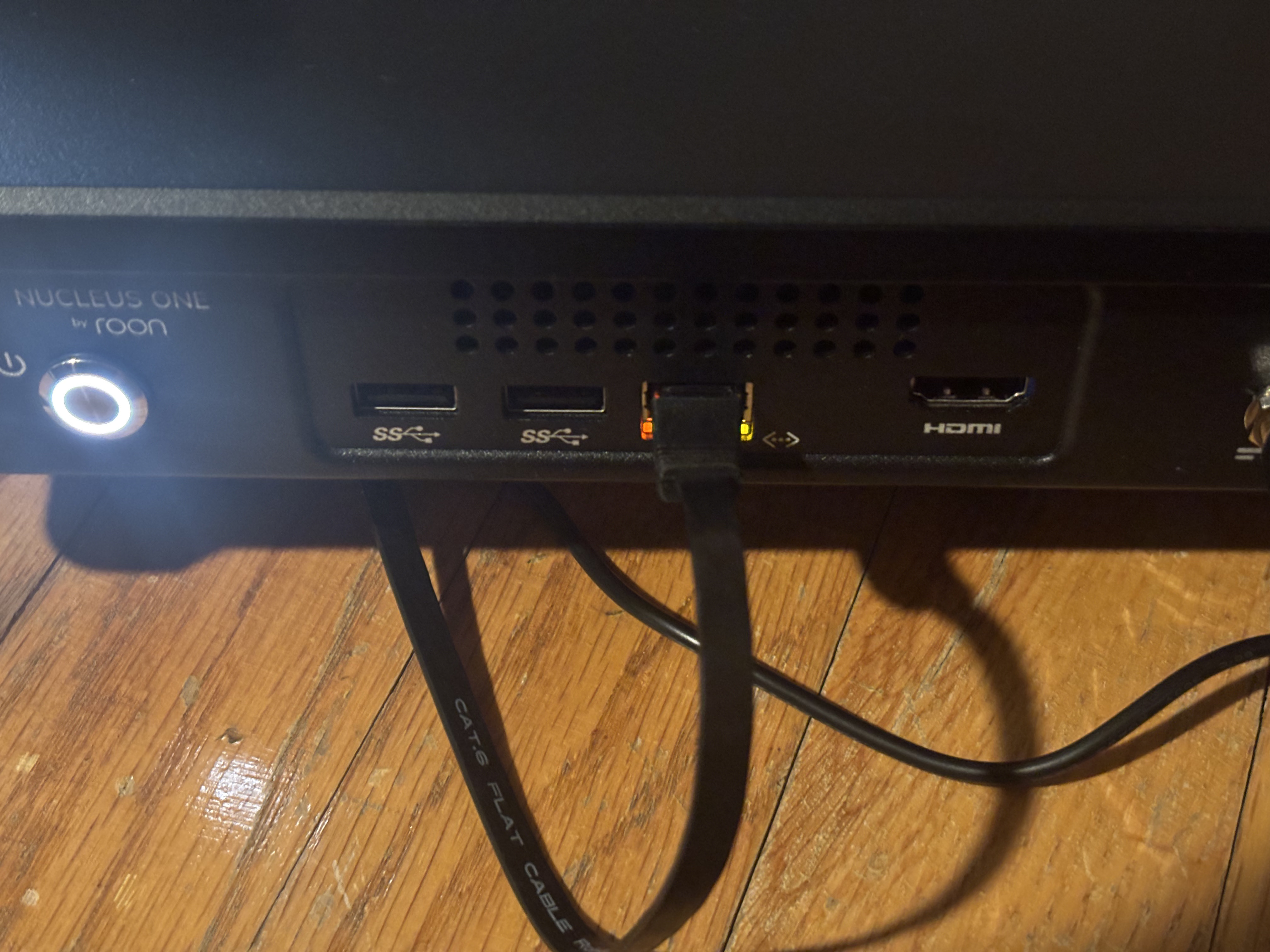

The back: The yellow light on the right of ethernet plug blinks. Show solid in photo

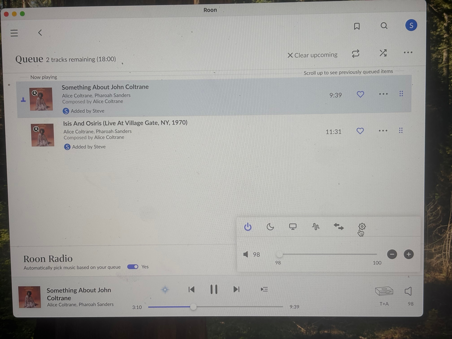

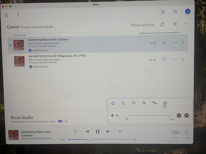

Please find a screen shot of my MAc LAptop playing with min Volume @ 98. No Sound.
Thanks again.
Steve
Hi @Steve_Summers,
Based on your screenshot, it looks like you’ve set a minimum volume limit on your Roon zone to 98, is that correct?
If so, I’d set it back to 0 just to be safe - from there you can manually adjust the volume slider to a safe level while we continue to troubleshoot.
With that, we see in fresh Roon server logs that within two seconds, the volume was commanded to jump from absolute silence to near-maximum.
  • The system unmuted (mute: false), but the value stayed at 0.
  • Then, a command was sent to set the volume to 98.
  • The "Command Storm" - then Roon sent nine identical commands (IDs 1634 through 1641) all demanding value: 98.
Caution - Volume 98 on a T+A high-end component is effectively full-throttle. If this happened while music was playing, it would have been extremely loud.
Apologies if this has been glazed over, but have you physically toggled the volume up and down on the device’s hardware remote already?
Thank you!
