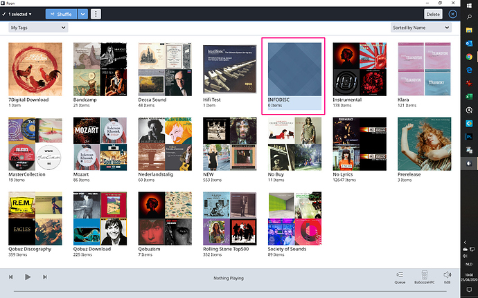

Just one more question… how can I delete tag from the tag’s list?

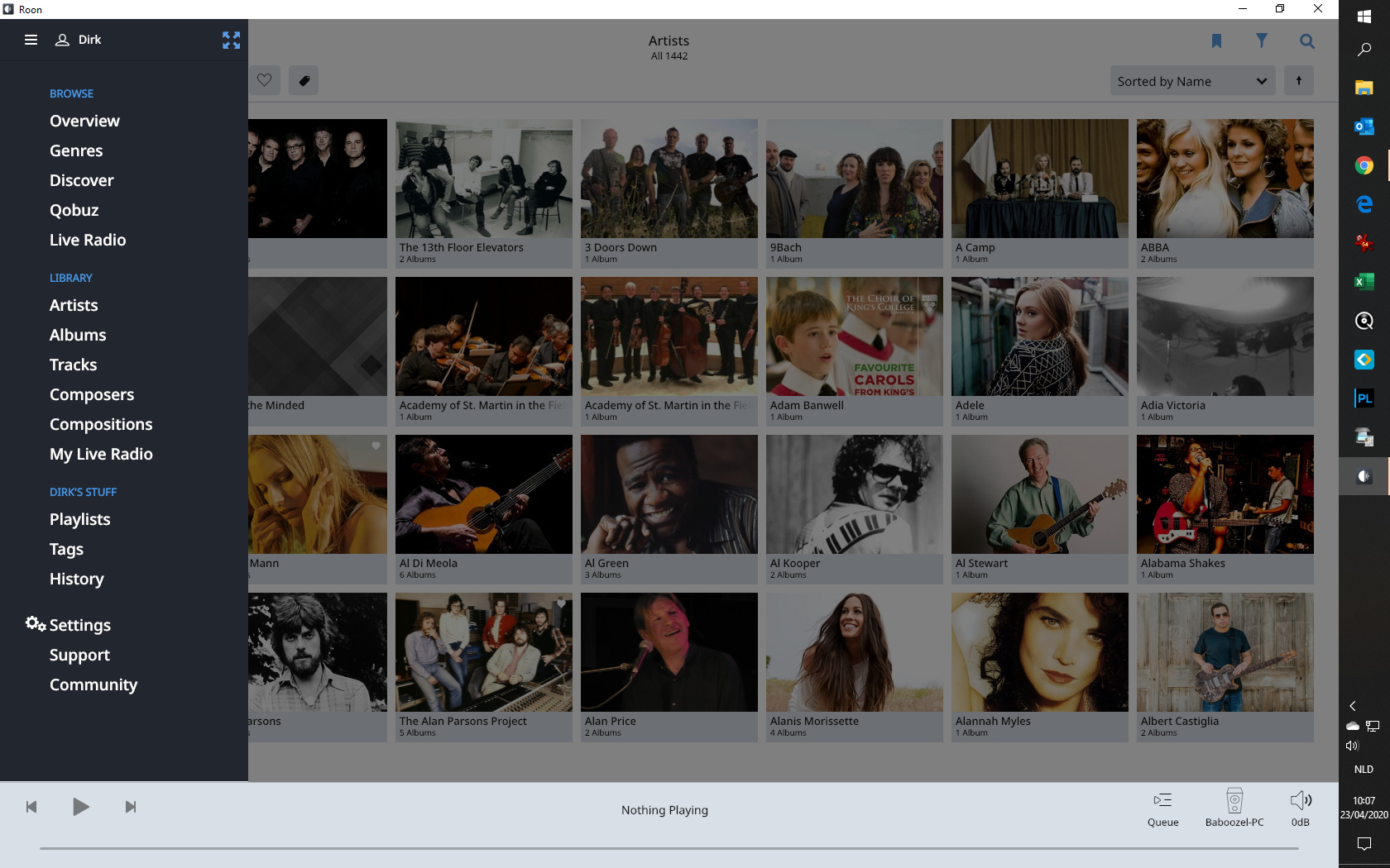

Go to Tags in the main menu

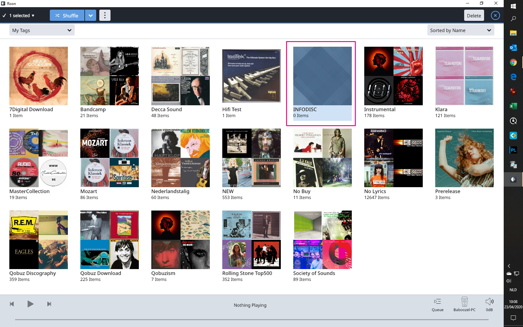

Right-click on the Tag you want to remove, so it is selected (in this example Infodisc Tag.
Click Delete at the top-right.
