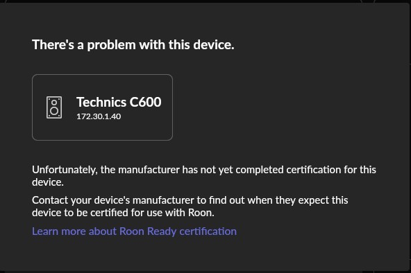

Hello,

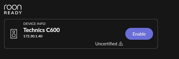

I was glad to check the news below as a SA-C600 user. However, it is still uncertified status and cannot be enabled and used in the Roon. I would like to ask if you need a little more time to finalize Roon certification process.

It could be it needs a couple more days to appear but also a question.
Since this announcement have you rebooted your Roon Server?
I know that has worked in other similar situations previously.
Thank you for your comment. Yes, I did reboot roon server.
Ok well let’s wait and see what Roon Support have to say here then.

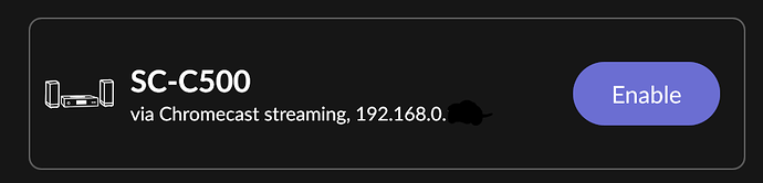

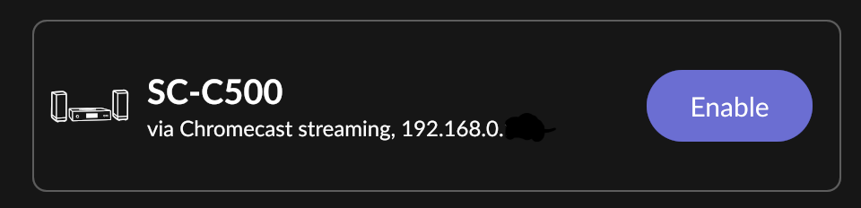

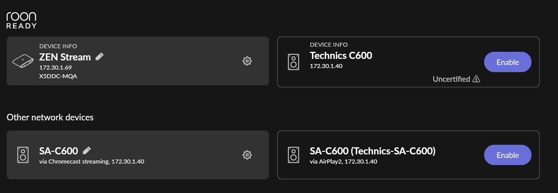

I found that SA-C600 appears as SC-C500 for Google Cast device! Is it a bug that the firmware has named the model SC-C500? :joy:
I have sent a JAPANESE message to Panasonic/Technics customer support to check for possible firmware defects.
It could be a naming issue.
Mine shows Technics C600 for Roon but Technics-SA-C600 for Chromecast and AirPlay.

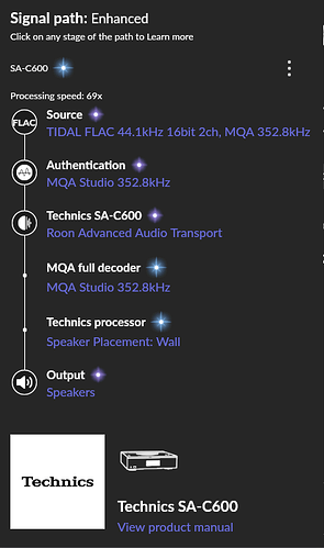

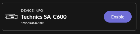

enabled
SOLVED!
Initialize SA-C600, then SA-C600 comes up! Try initialize.

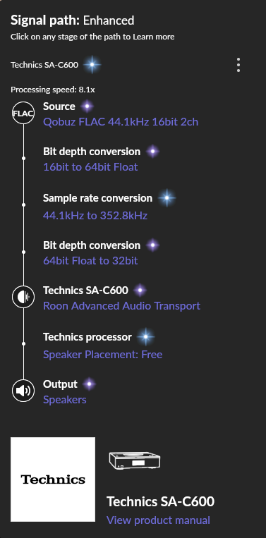

Works perfect.
Thank you. It also worked for me.
It works! Thank you
