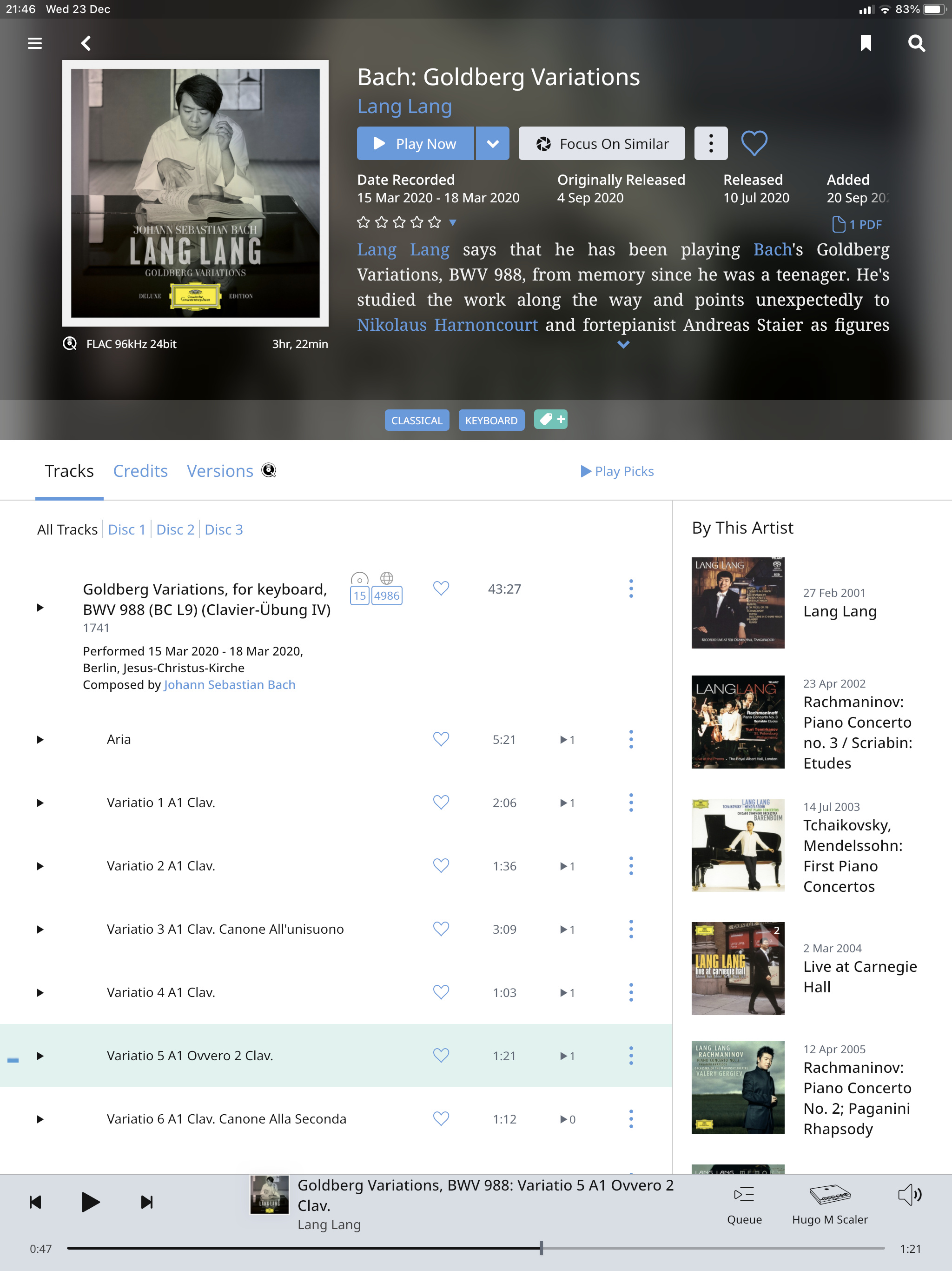

For example, I have a TT2 connected via dual BNC to the MScaler, and my signal path is as follows:

If you have a TT2 as well as MScaler (like I do), then the MScaler should be connected via USB directly to your NUC. From the MScaler, you should use dual BNC into the TT2.
The Aires G1 should be connected to your home network via Ethernet, and have no connection/communication with the MScaler.
You will therefore have two Roon ‘zones’. One will be Aires G1, and the second will be MScaler/(TT2 - but this will not show up in the signal chain).
