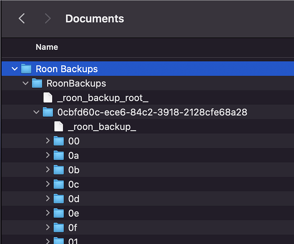

Unfortunately, there weren’t any files to extract from the folders you sent over. As a next step:
  • Can we get a screenshot of your backup folder structure from via file explorer? Here is a test example, but from my MacBook:
  • Can you try to manually search for files with _roon_backup_root_ on your computer?
I’m wondering if perhaps you have backups saved to a different location.
