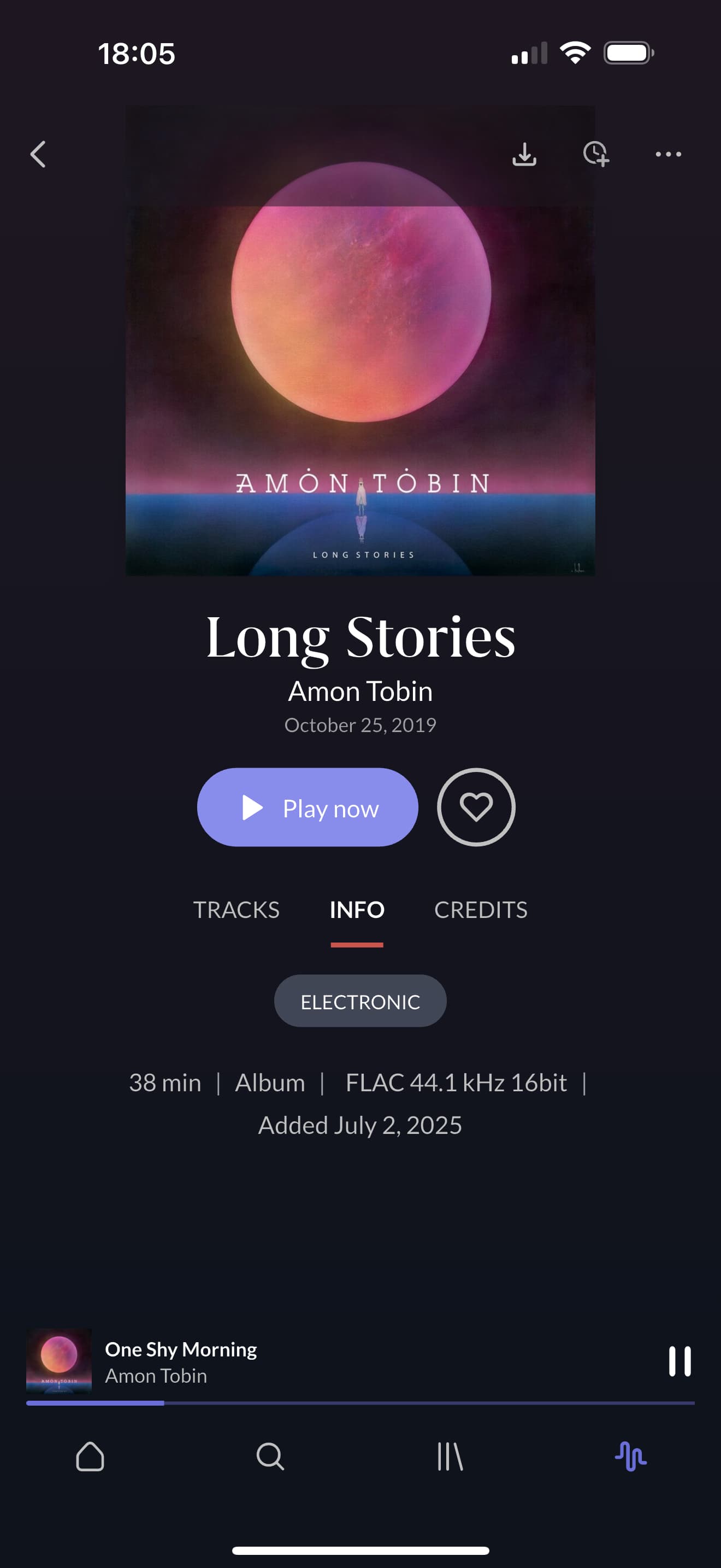

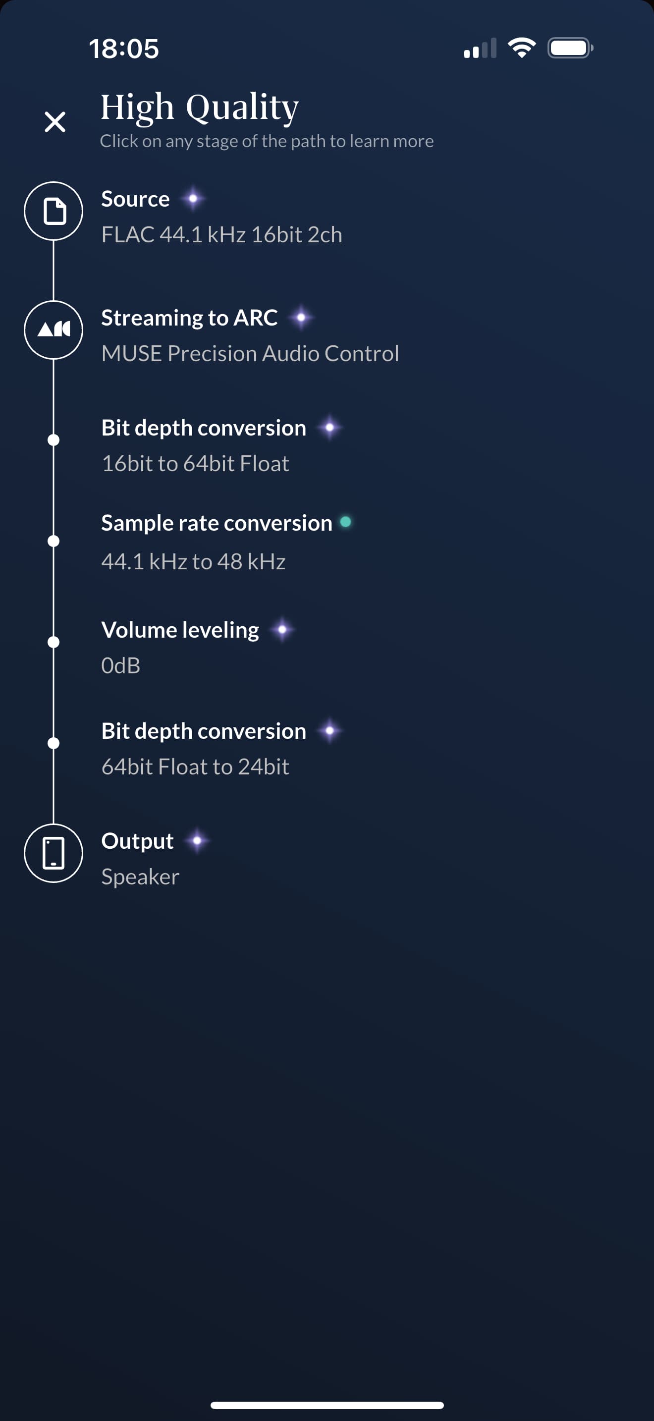

With volume levelling enabled I should have -5dB when the loudness is unknown. It remains at 0dB as seen in the below screenshots. The same behaviour is with CarPlay, Bluetooth headphones and the phones speaker. The same for Android. This behaviour occurs with streaming content locally as well as downloaded for offline use.
When the loudness is known it works ok.

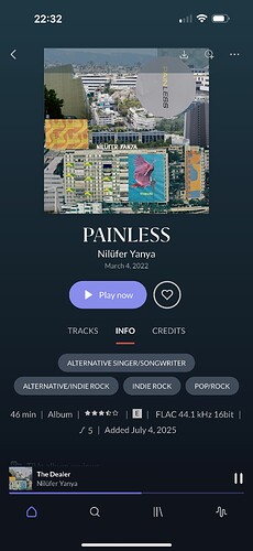

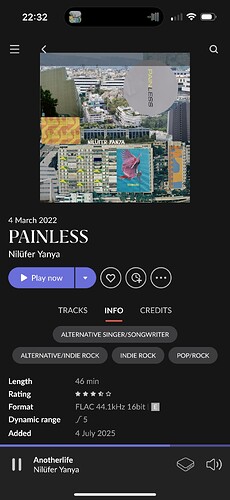

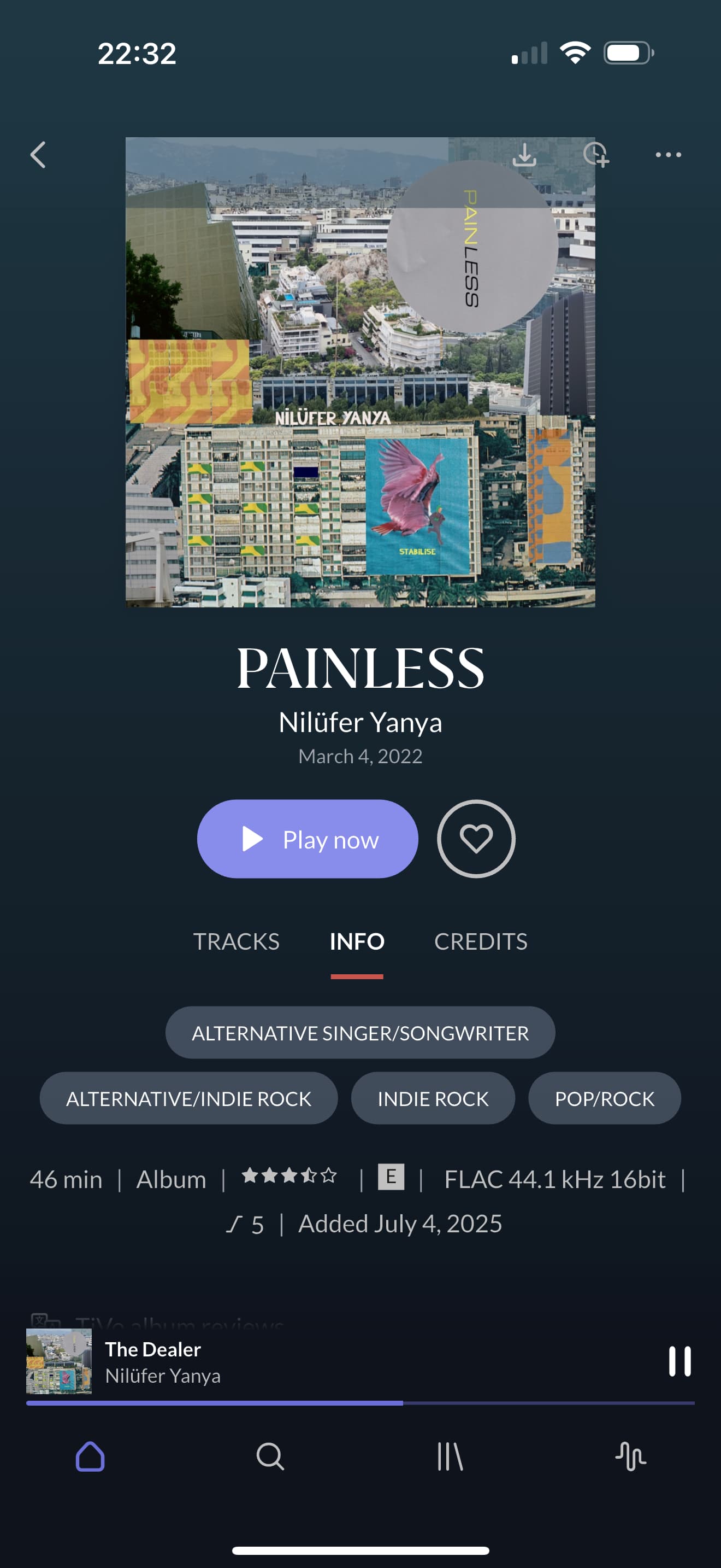

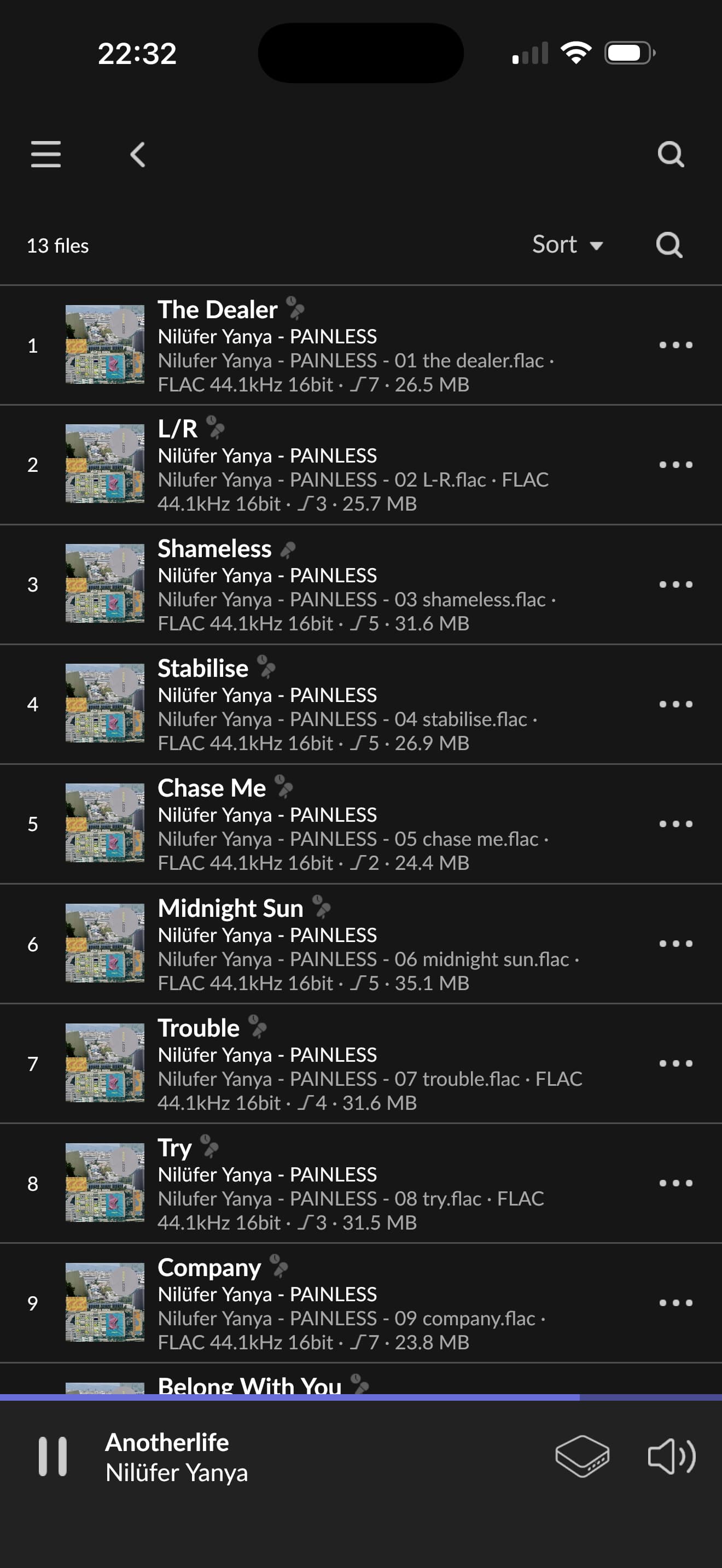

Let’s take the album ‘PAINLESS’ by Nilüfer Yanya.
In Roon the album has been analysed and Roon shows a DR of 5 for the album (each track have their own DR).
Roon
Arc

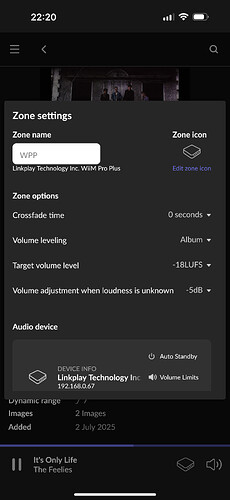

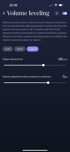

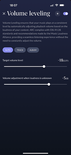

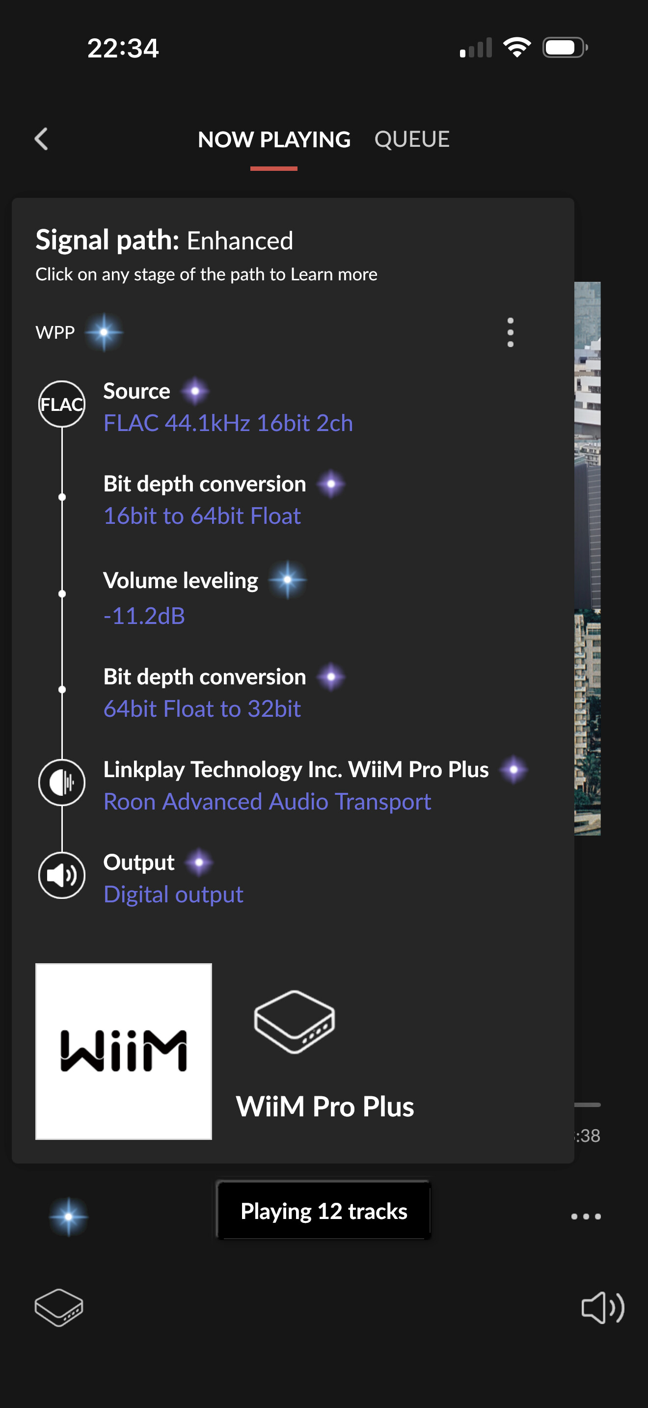

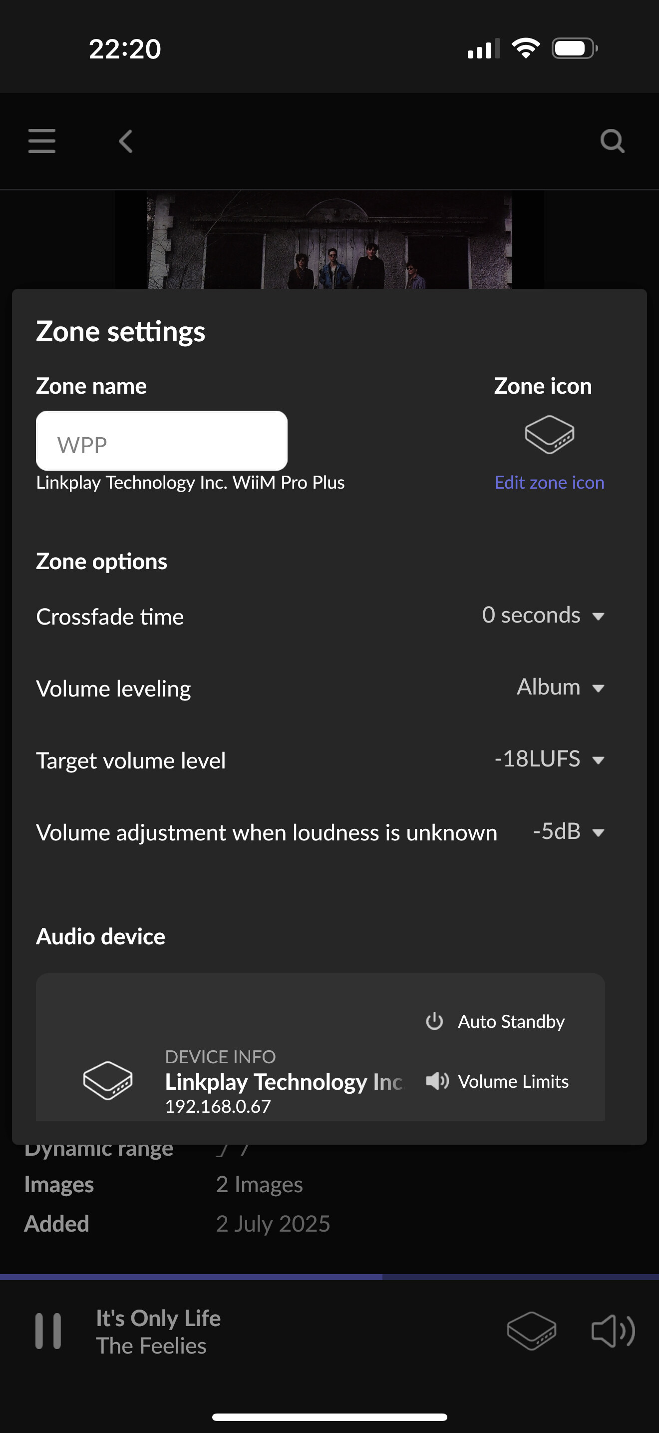

When volume levelling is enabled to a target of -18 LUFS and if unknown -5dB. Volume levelling is set to albums. The same settings for Arc also.

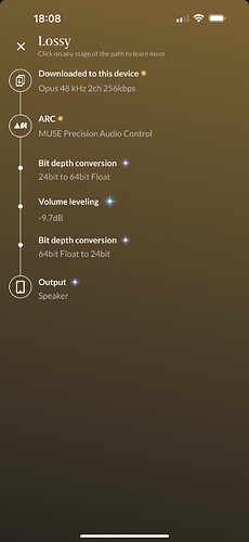

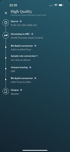

Arc
Playback on Roon: -11.2dB applied
Playback on Arc: 0dB applied

If I play an album with no known DR analysis in Arc it shows as 0dB instead of -5dB. In Roon the -5dB is applied. I can reproduce this multiple times.
Got it, thank you for the response, @Mr.Flibble. I investigated this one It appears that it’s not a recent problem, moreover, it seems to be a UI issue, the volume levelling is applied when the loudness is unknown, but it’s not reflected properly in the UI. Or do you observe inconsistencies in how the setting is applied as well?
