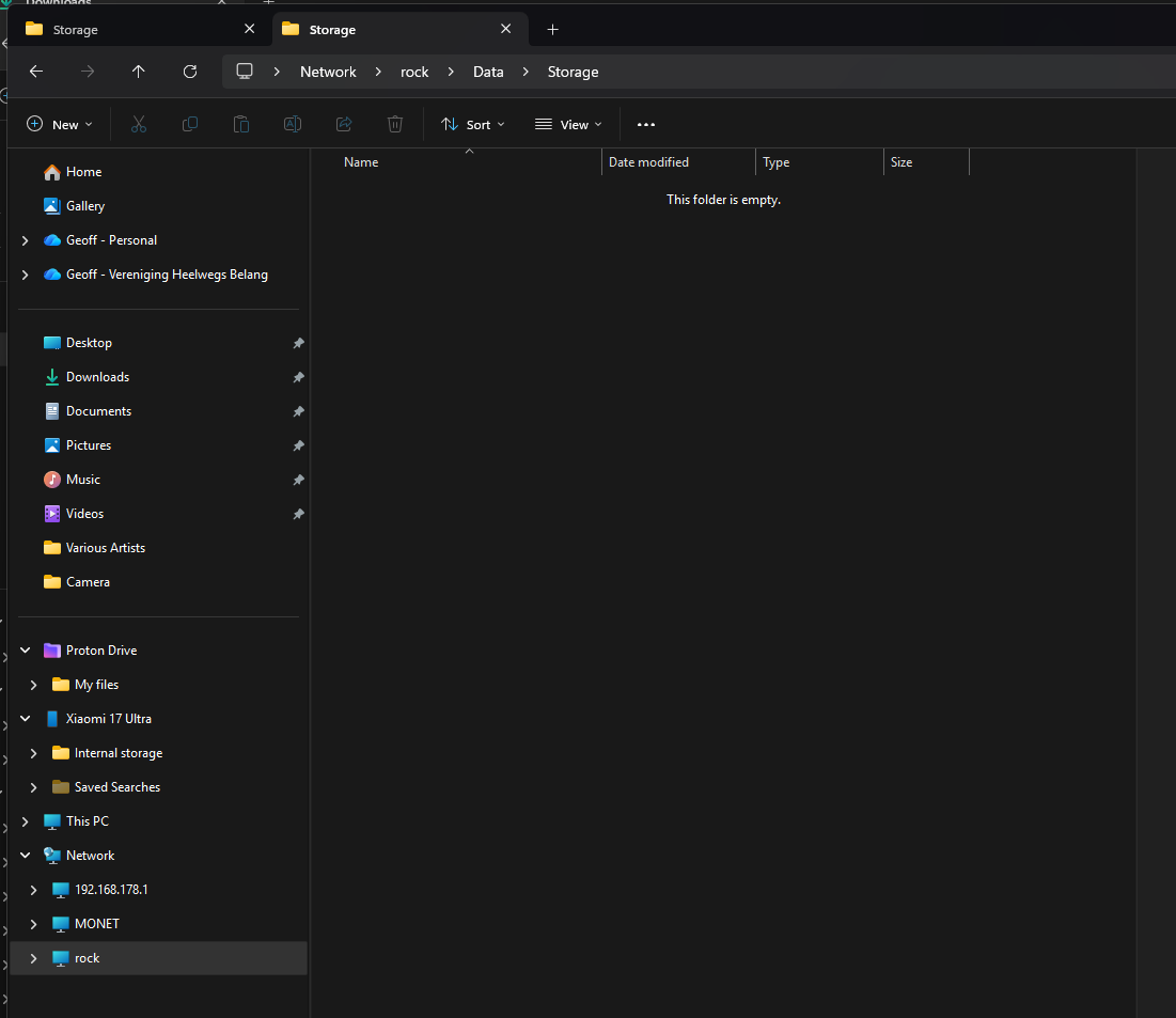

· Have installed Early Access RoonOS 3.0 on my ROCK/NUC system. Roon can access and use the local music stored on the internal 2.5" SSD, but Windows 11 File Explorer claims that the \\ROCK\Data\Storage folder is empty, while it should contain both the InternalStorage folder and a folder representing an attached USB drive.

OK, thanks, but just to be clear - the external disk is showing up in Roon, but neither the internal disk nor the external disk are showing up in Windows File Explorer - and that is the main issue here…
I assume that the [Ticket in] in the title refers to the Windows File Explorer issue, and that ticket is still open…
