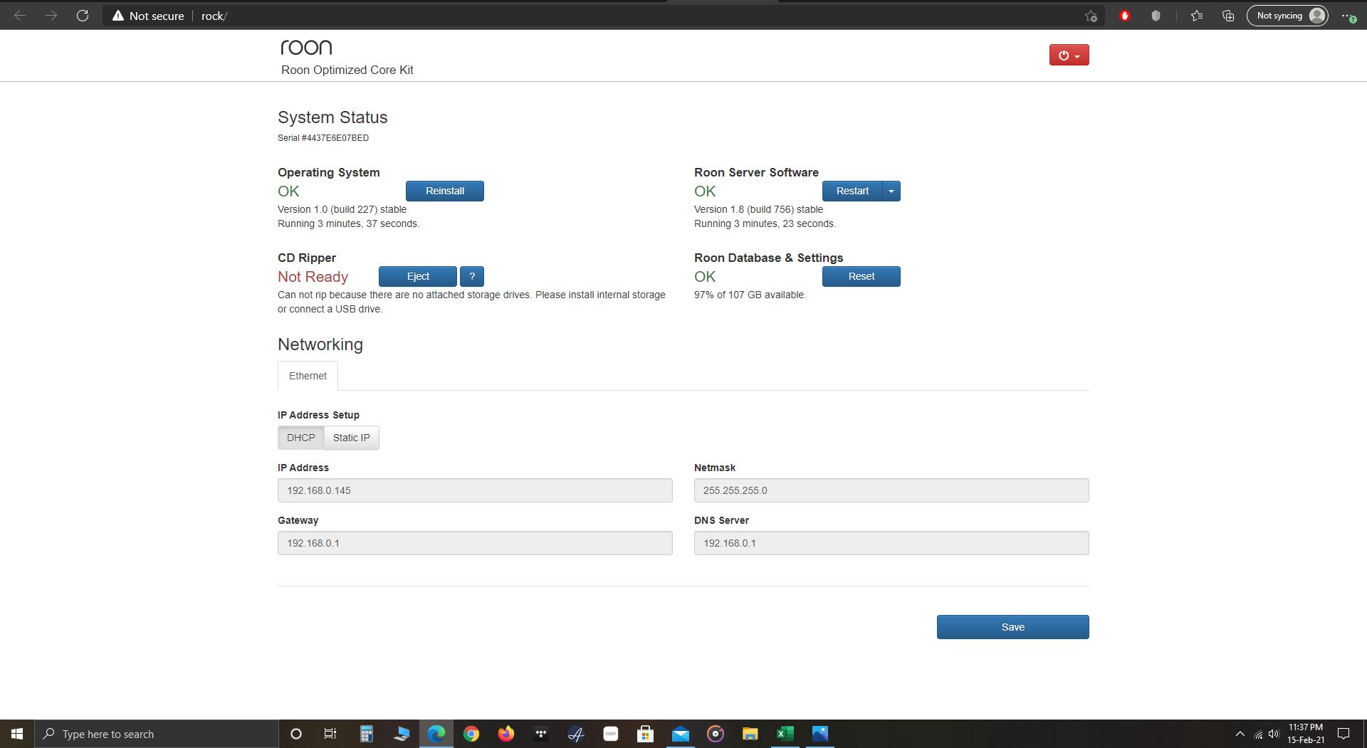

How does your ROCK Web UI look like, can you share a screenshot (especially the networking section)?

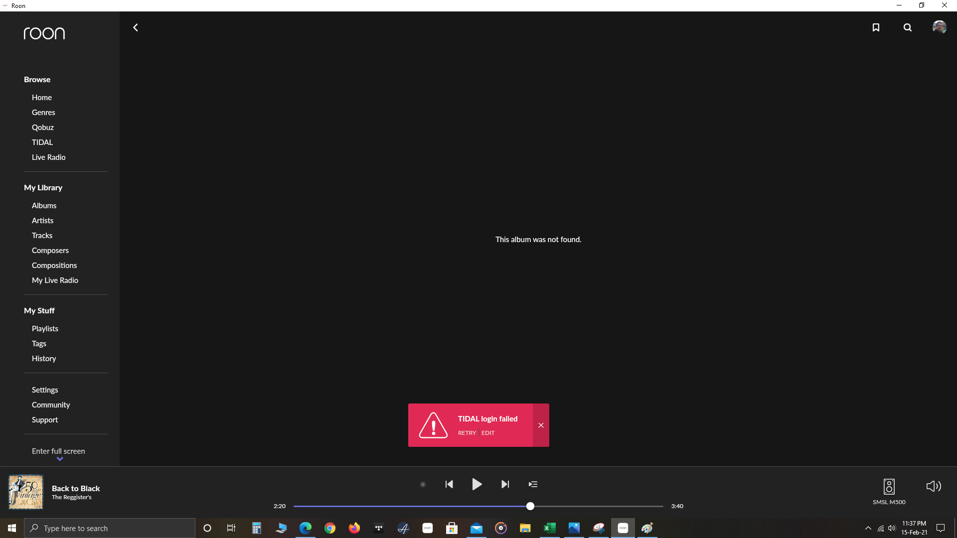

So I restarted the ROCK and here are the results (without doing the manual UI based restart as stated earlier). As you can see, the IP is taken but Tidal and Qobuz do not sign in automatically upon restart. I have to press the retry button on the red notification and then even though it seems to login…no data is fetched from the Tidal pages (see Tidal fav screen below). I think we need to reset/delete the cache from Roon’s side…so that my Roon account can be completely reset from back end. I did already change the DNSs to Google earlier. Again, to make it all work (which works sometimes)…I have to stop the server from UI and delete all the Cache files and then restart the server to get access to proper page loading and Roon radio over Tidal and Qobuz.
