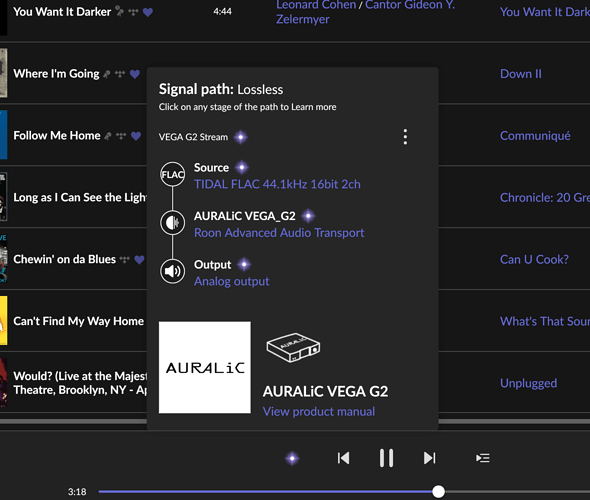

Hi @sean_clayton1
Can you share a screenshot of the signal path when playing to the Vega in Roon?
