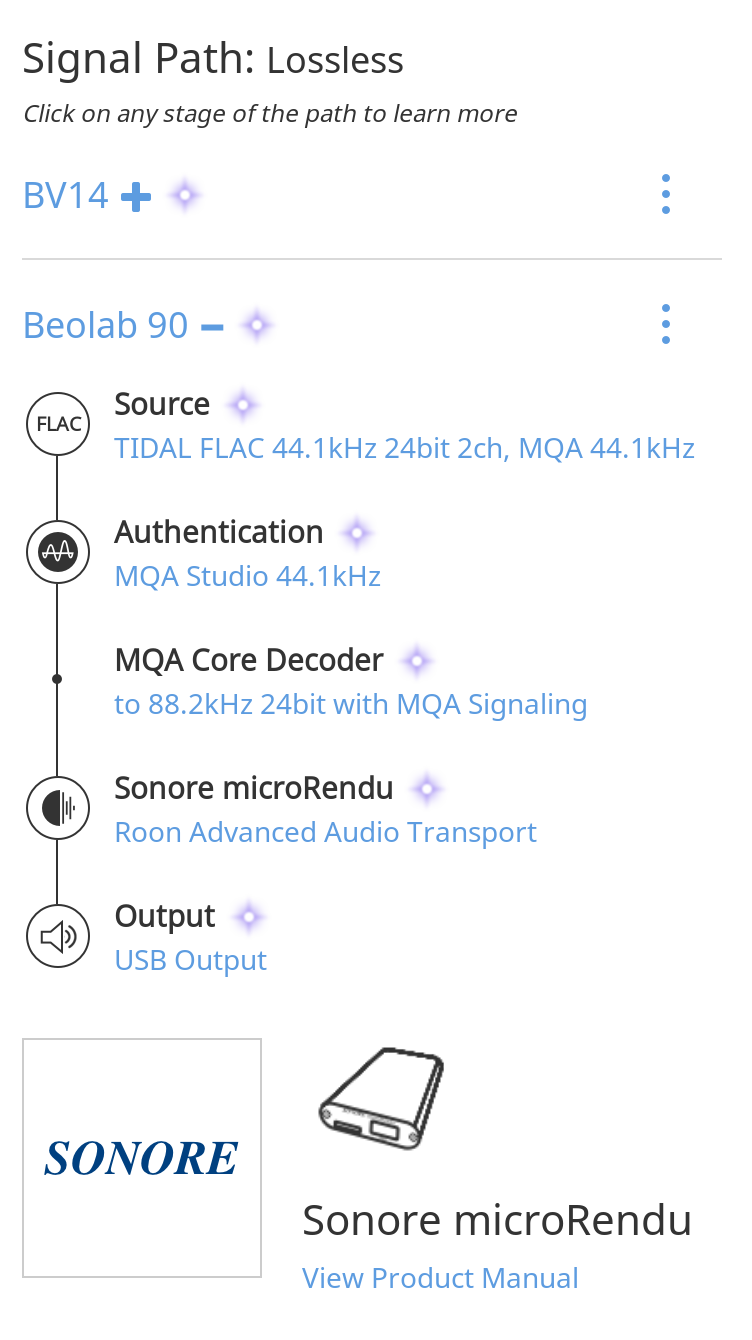

The MQA information on the track says it’s 44.1/24-bit, but when ROON decodes it seems to be upsampling to 88.2, even though the track doesn’t seem to be that bitrate? Am I misunderstanding what it’s saying here?
The output of the MQA decoder always is 88.2/96 kHz – regardless of the original sample rate. If the original sample rate is 44.1/48 kHz, it gets upsampled.
AJ
Ah. Thanks - I thought it would be the same as the source’s original sample rate.
