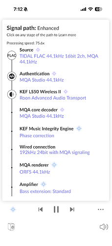

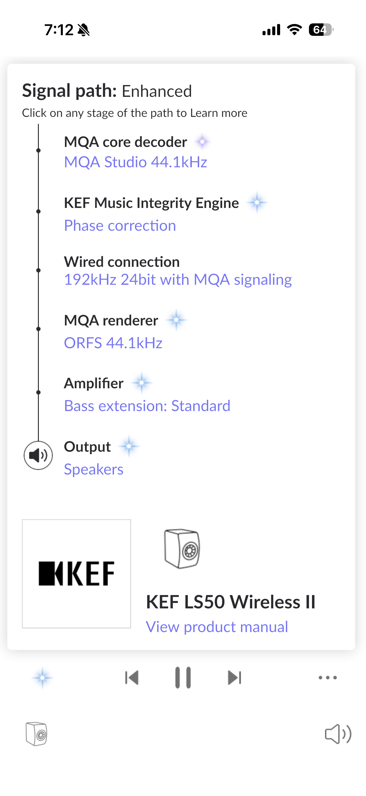

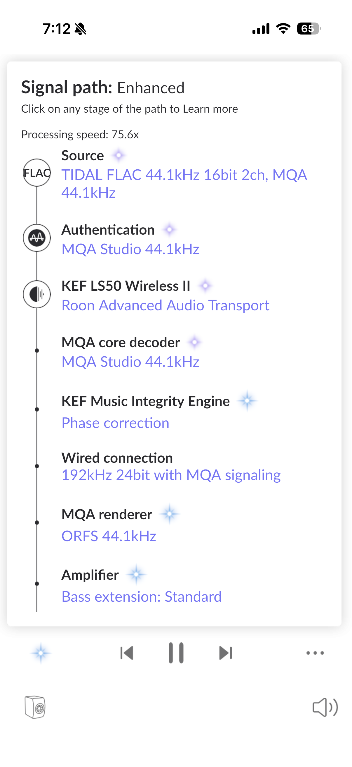

Signal path flow is shown below.
@3.14nz ,
Thanks for sharing a photo.
From it it looks like your DAC is doing MQA decoding work on its own.

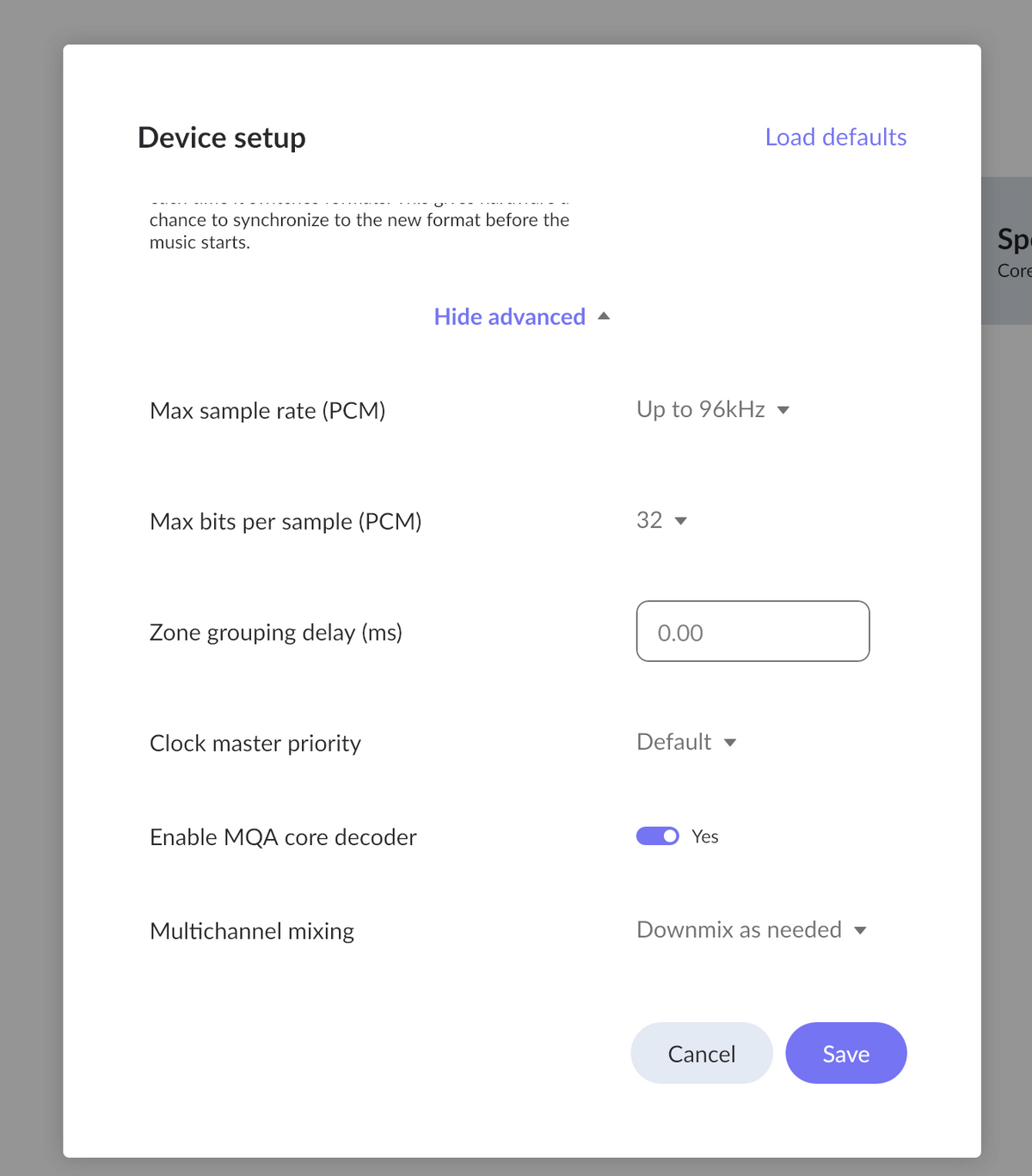

Can you please go to the Roon Settings and enable MQA decoder on Roon’s side like this ?
This allows Roon to manage MQA unfolding and might improve the situation.
Can you please try that and let us know if that’s making things better for you ?

Same issue here that just started with the recent March 2026 kef firmware update. I tracked it down to some high resolution Mqa songs from tidal. They sounded like they were underwater, kind of warbly.
This roon support suggestion fixed it for me, but I also had to specify mqa render only for the speaker.
