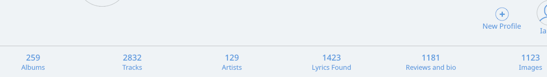

  1. Can you let us know how many tracks total are in your library? You can find this by going to Settings > Overview

I think my library has 2832 tracks in total, if this is the Overview section in question.
