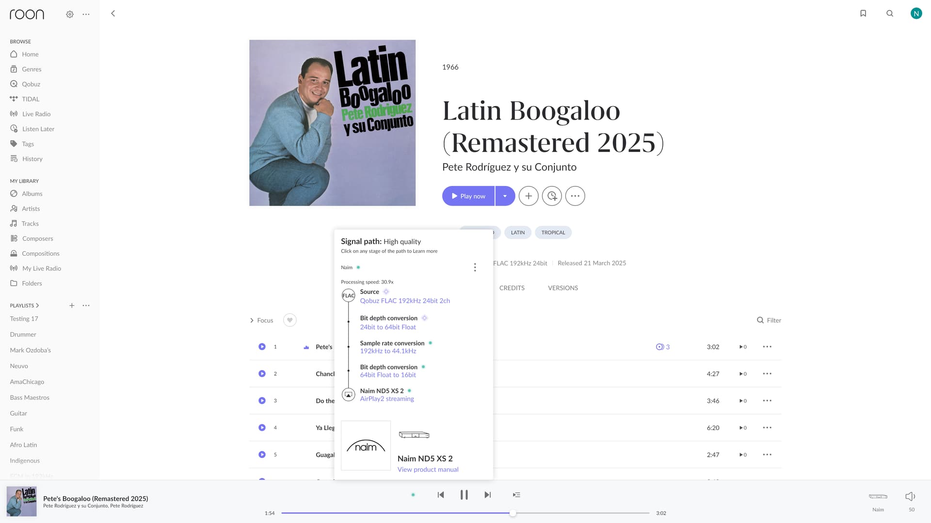

Could you please share a screenshot of your signal path when this is happening?
I’ve attached the signal path screenshot. I do not have this problem when I play Qobuz or Tidal on the Naim Focal app.
AirPlay can’t do hi-res
Hi @Norman_Khumalo ,
As @Jaap74 mentioned, Airplay is limited to a lower sample rate. To get the higher resolution output, you’ll need to enable Roon Ready mode for the device under Roon Settings → Audio and then switch to the Roon Ready output using the zone picker. Let us know if this solves the downsampling behavior!
Thank you very much. The solution worked.
