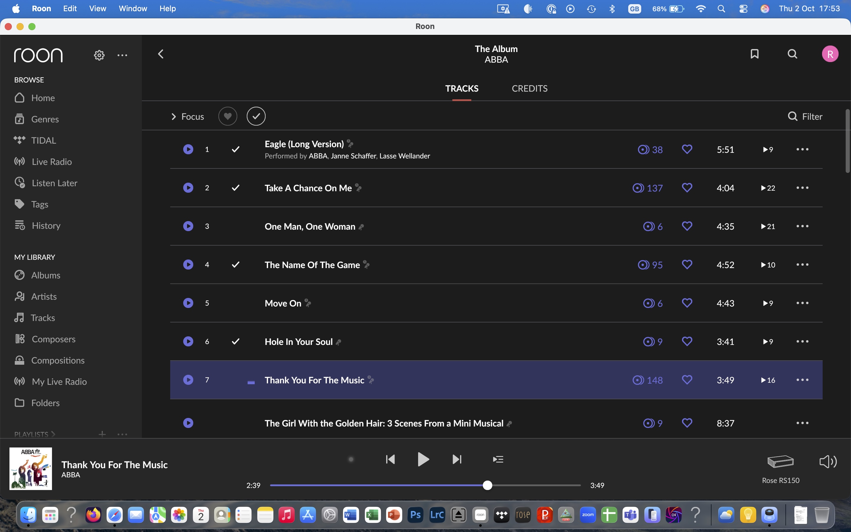

I had a problem with my local network 3 weeks ago. This has been resolved. The only way I could get my RoseHiFi 150B to work was a factory reset. The firmware (Rose) then also had an upgrade. Since then, when streaming Tidal through Roon no song ever plays in full. Half way or two thirds through a song it stops and goes to the next track. At first I thought the damaged Red Sea cables might also be an issue. However it is now 3 weeks on and I still have the same thing. Rebooted Rose a few times and rebooted my computer (Roon core) a few times as well, no change.

Hi Conner, I am still having all the same issues. I am not sure about the drop outs. My MacBook Pro is my Roon Server and I only stream Tidal through Roon. When these drop out happen it I scan it on both the Rose 150 screen and on my laptop. The song just stops playing at random times, then every thing is quiet for a short while and then the system skips to the next song.

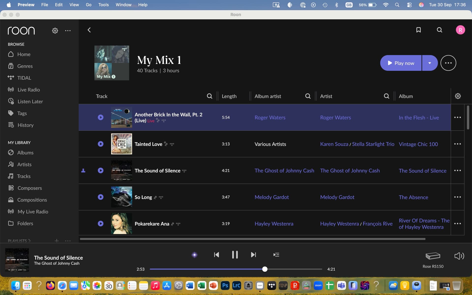

Hi Noris, I logged on at 17h34 local time (Dubai). I chose a Tidal My Mix to play. Clicked play, dead silence for a while, skipped the first and the second song altogether. The album art appeared on the RoseHiFi 150B but the song did not start. then it started playing the third song.
It just stopped playing at 2 minutes 53 sec in. Unlike previous times it did not skip to the next song, but showed the music queue is empty despite the playlist having 40 songs in it.
