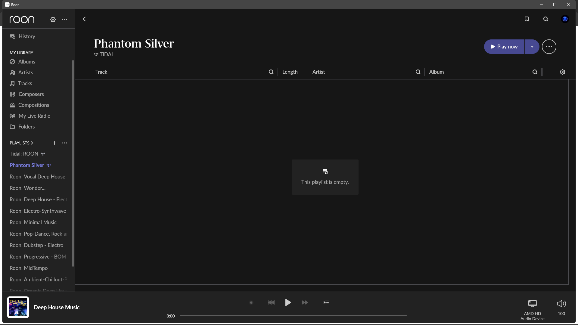

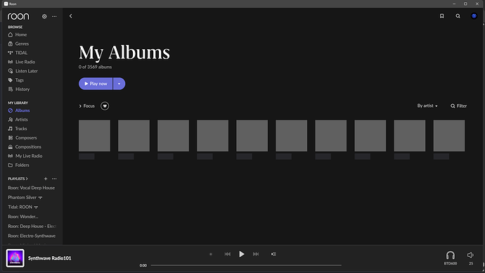

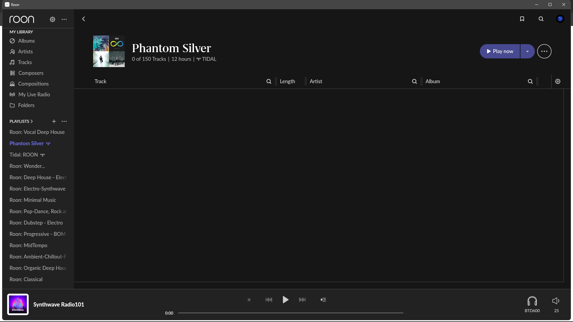

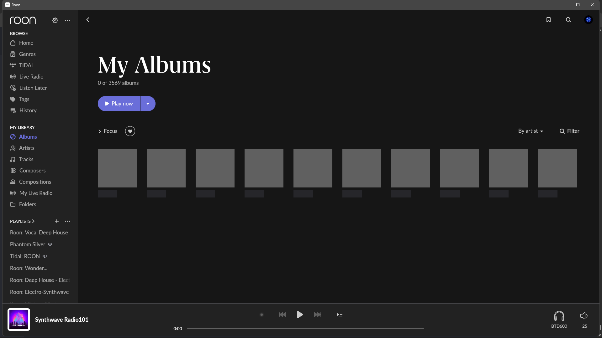

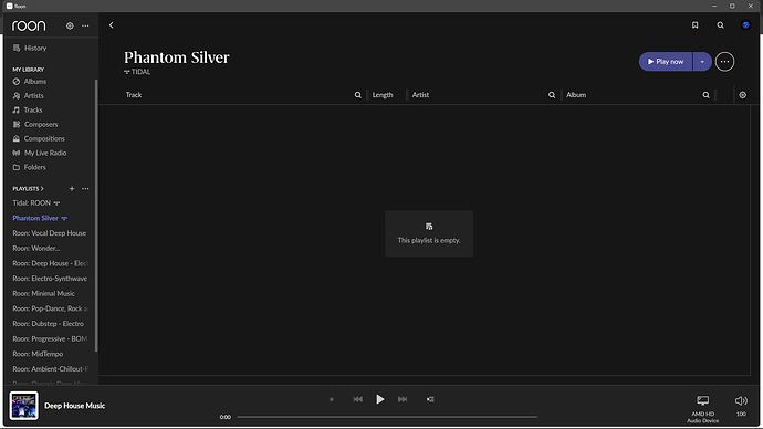

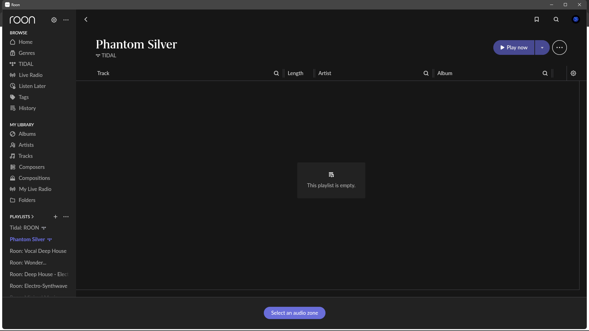

I followed your instructions exactly, and now the playlist is completely blank, displaying 0 tracks.

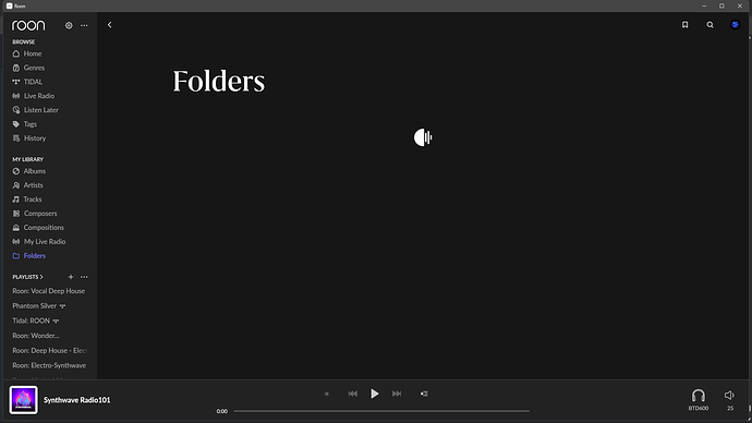

Now the local directory scanning is completely broken as well. The “Folders” section is stuck in an infinite loading loop.

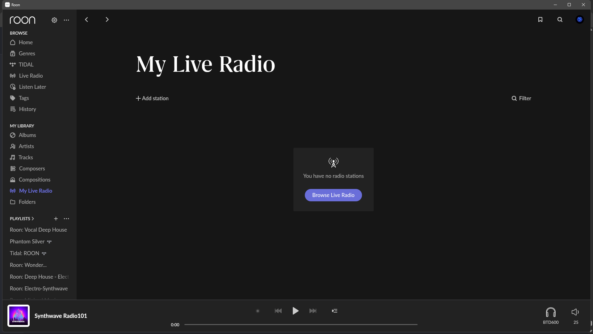

Even the “My Live Radio” configuration has been completely wiped out now.

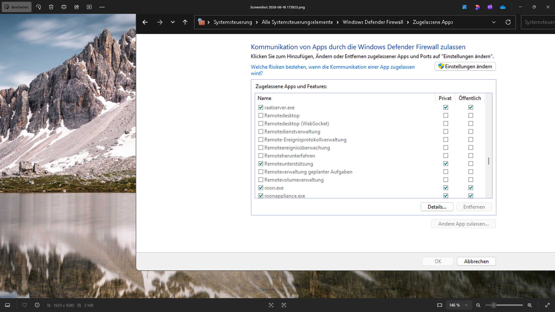

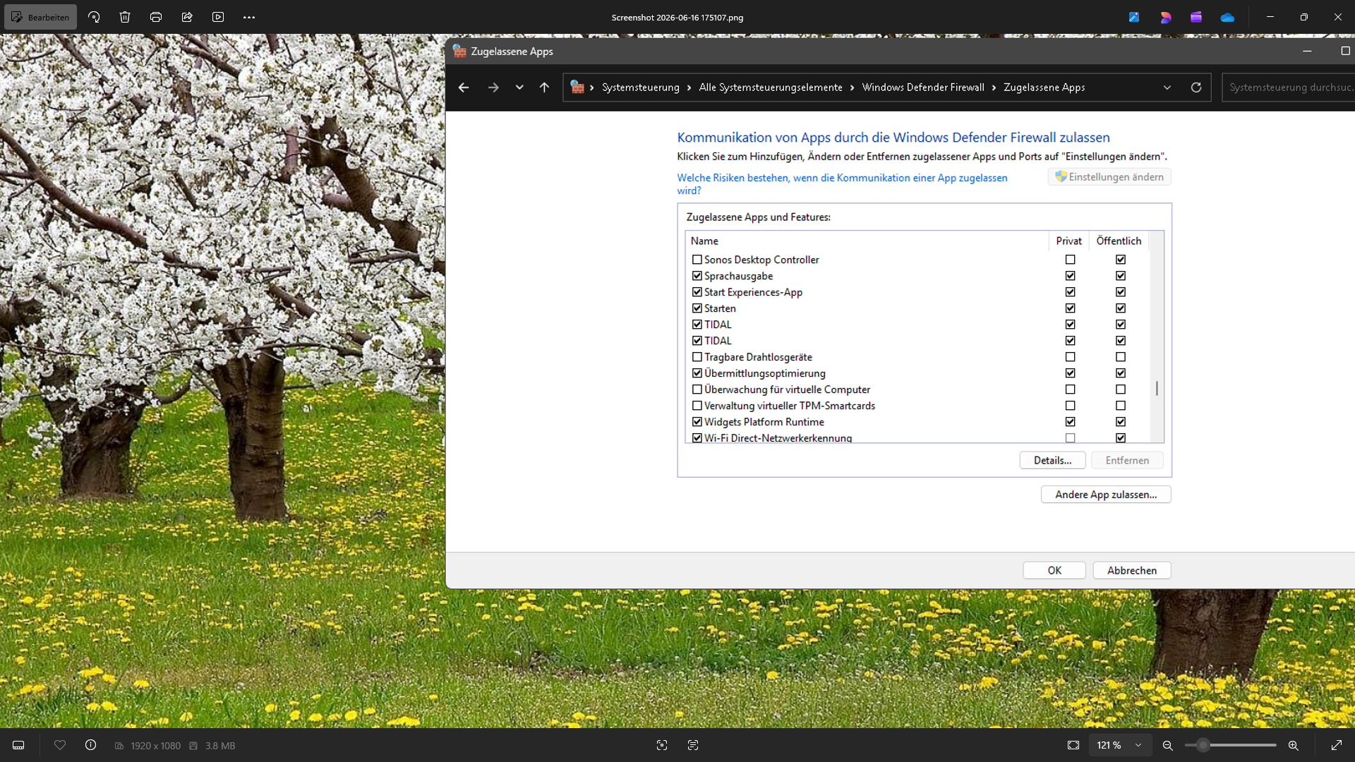

Please verify that the Microsoft Defender firewall has RoonServer.exe and all other Roon-related processes safelisted.

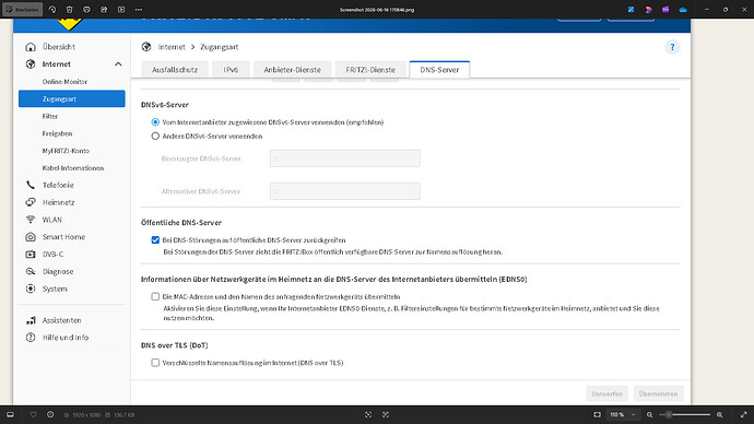

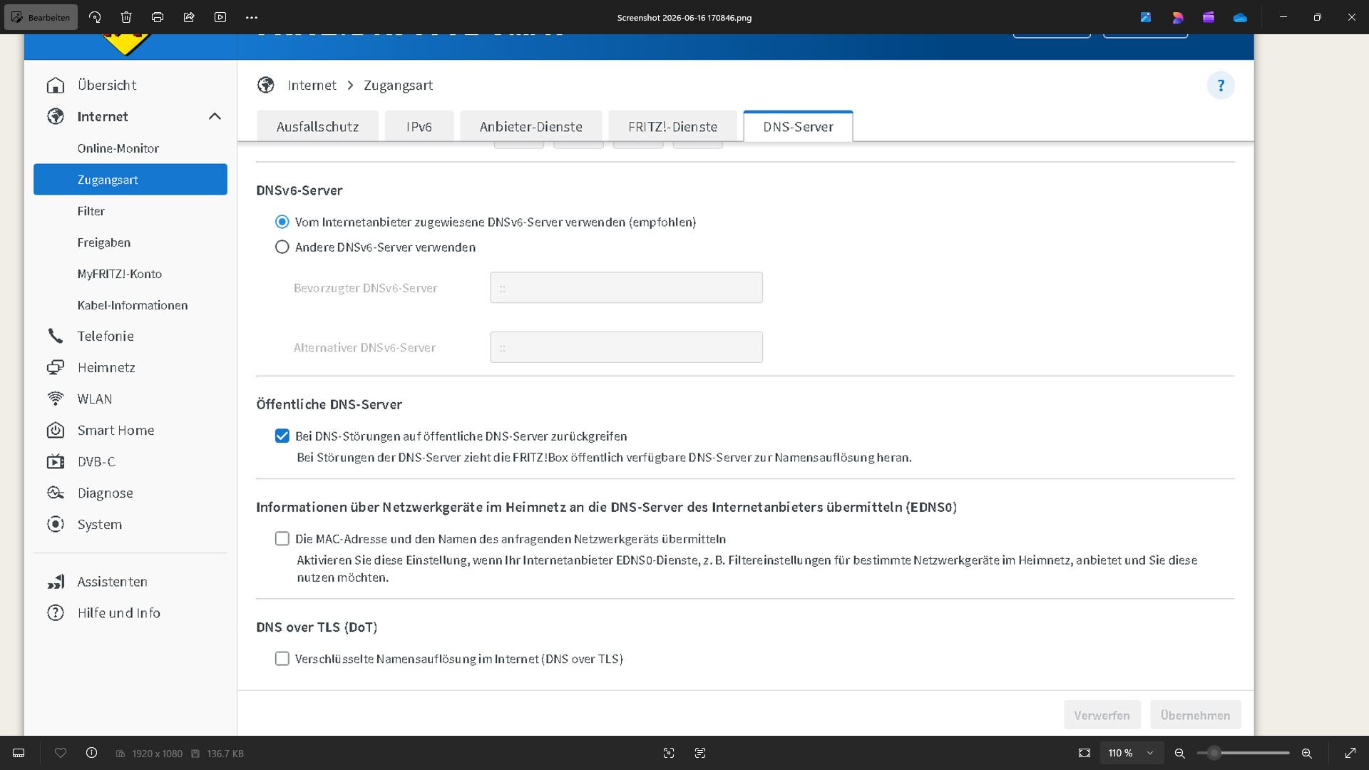

In your Fritz!Box settings, do you have DoT (DNS over TLS) enabled in the DNS section?

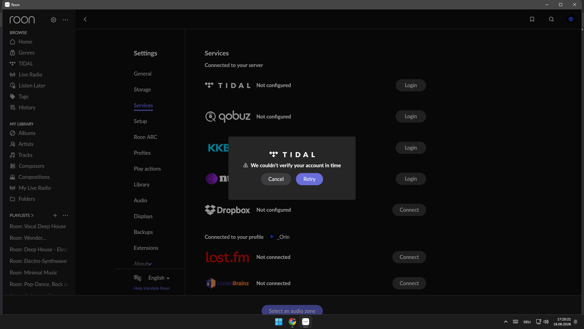

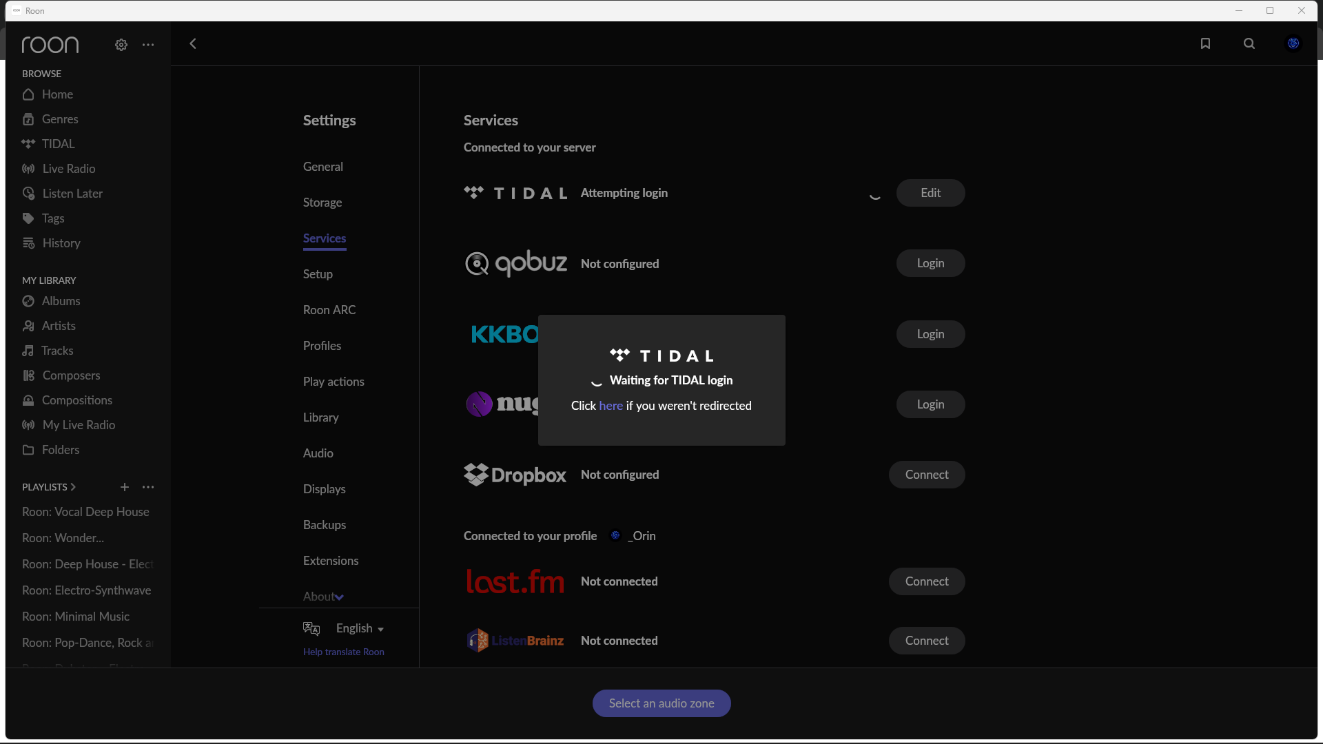

At 16:42 PM, following your recommendations, I performed a complete clean log-out, fully closed Roon, and did a full hardware restart of my workstation.

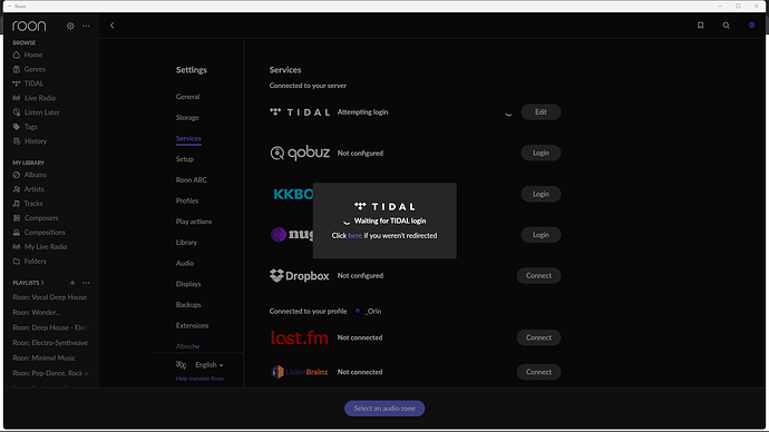

At 17:12 PM, I booted the system fresh, opened Roon, and initiated the TIDAL login sequence.
After 5 to 7 minutes of continuous looping, the interface froze on the “Waiting for TIDAL login” screen.

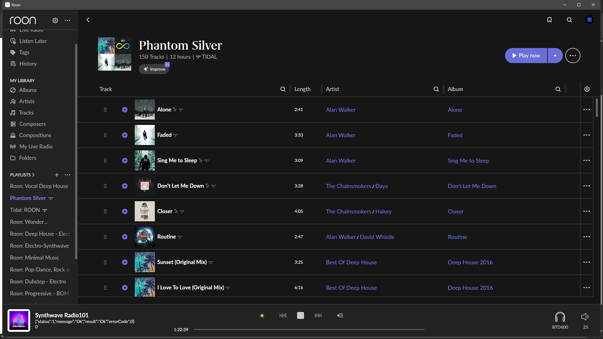

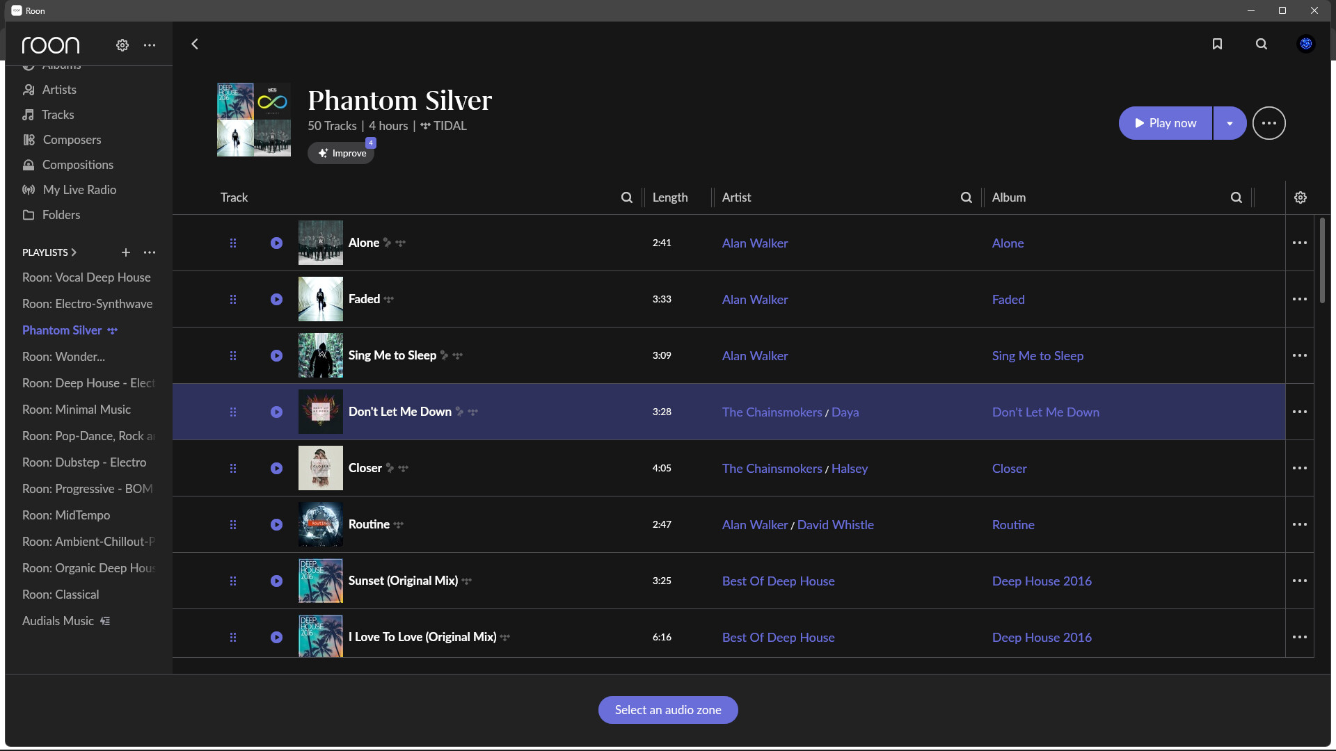

Update on current status:
I have since clicked “Retry” and finally managed to bypass the login screen. However, the synchronization result remains entirely broken. Inside Roon, both my TIDAL playlists—“Roon” and “Phantom Silver”—continue to display as entirely empty.

Firewall Authorization: RoonServer.exe has 100% full incoming and outgoing clearance on both Private and Public network profiles within Windows Defender Firewall.
Fritz!Box DNS Configuration: As proven by my FRITZ!Box 6591 Cable interface, the “DNS over TLS (DoT)” feature is completely unchecked and disabled. My network path is entirely unrestricted.

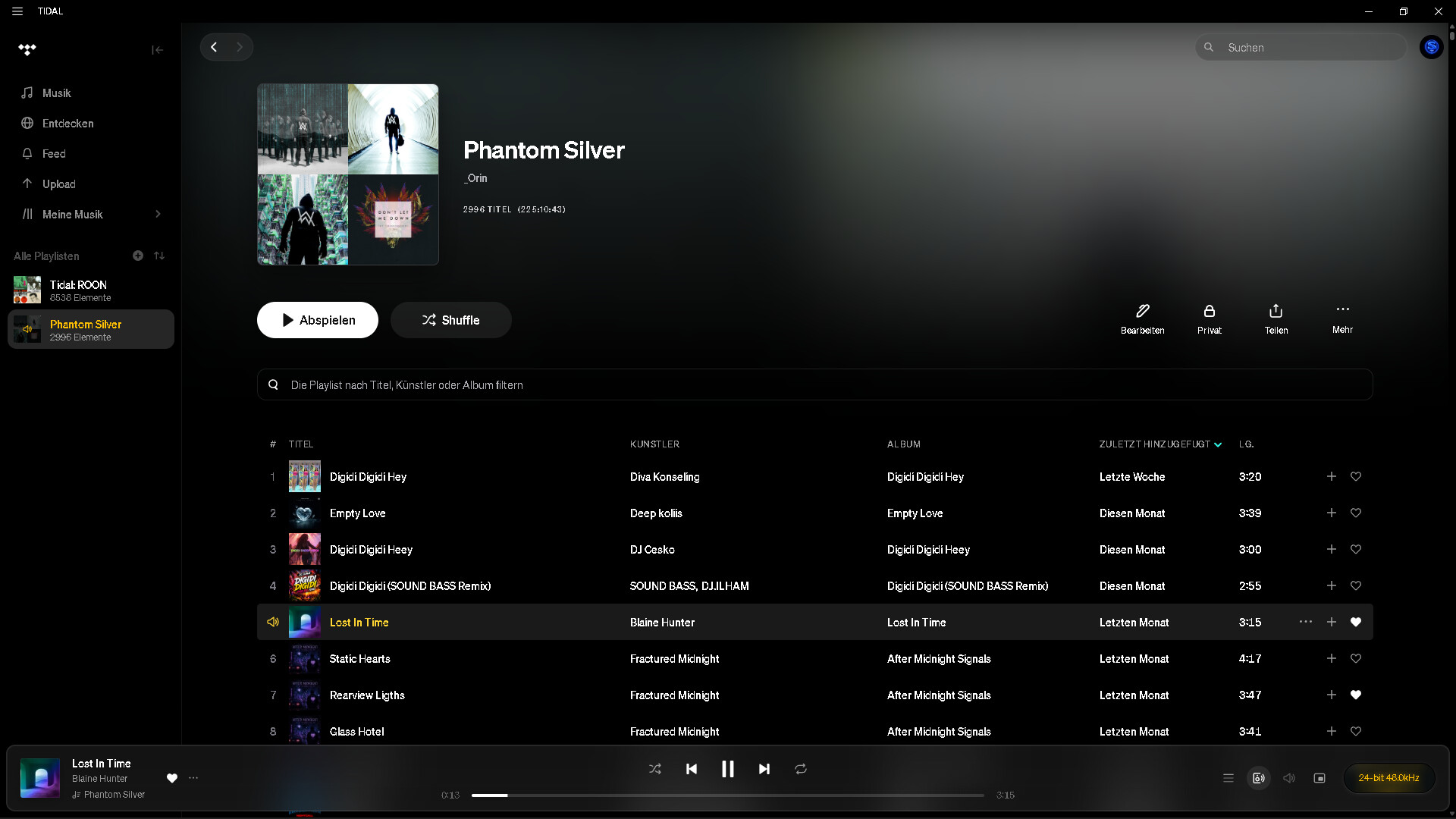

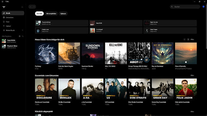

Inside the native TIDAL application on this exact same network, both the “Roon” (2,996 tracks) and “Phantom Silver” (8,537 tracks) playlists function flawlessly, displaying all tracks instantly with complete stability. This diagnostic loop definitively proves the bug is an internal cloud metadata synchronization regression within the current Roon infrastructure. I expect your technical team to address this core software issue directly rather than searching for external network factors.

The firewall screenshots, the disabled DoT, and the no-VPN statement are all reasonable to provide, but none of them rule out the actual mechanism. They confirm RoonServer.exe isn’t blocked outright (consistent with the logs, many TIDAL calls do succeed at 200), but the problem isn’t a hard block; it’s intermittent mid-stream resets on long-lived TLS connections to one host, similar to what @connor has mentioned above.

Inside the Roon ARC mobile application, the playlists appear fully populated as text items. However, during actual playback, only about a quarter of the tracks can be successfully streamed.
The remaining tracks appear as simple, inactive titles on the screen with no audio stream. This behavior is identical when trying to sync the integrated TIDAL service within Roon, even though the native TIDAL application functions flawlessly on all my devices and streams any playlist instantly.

As requested, I have conducted the isolation test using a mobile hotspot connection ( _Orin network, 2.4 GHz band). To ensure a clean testing environment, I logged out of TIDAL, stopped the Roon Server process, restarted the core, and re-authenticated the account.
The behavior remains identical. As shown in the attached screenshots, the ‘Phantom Silver’ playlist appears completely empty within Roon. However, when opening the native TIDAL application on this exact same machine and connection, the playlist loads immediately with all tracks fully populated.
The testing confirms that the local network, router, and machine are functioning correctly. The issue appears to be strictly isolated within the API synchronization layer between Roon and the TIDAL database during playlist queries.

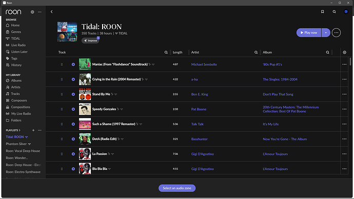

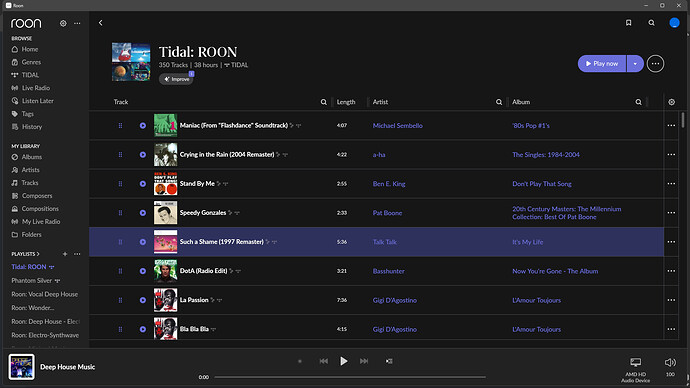

The master playlist ‘Phantom Silver’ (which contains exactly 2,996 tracks) is fetched by Roon but completely truncates at exactly 50 items (4 hours).
This indicates a rigid API page limit failure where Roon processes the initial token page but fails to request subsequent cycles due to metadata overhead timeouts.
The secondary master playlist titled ‘Tidal:Roon’ (which contains exactly 8,538 tracks) has completely disappeared from Roon’s sidebar indexing layer entirely after the database refresh.
The fact that your support team previously accepted my inverted numbers without verifying the images proves that the validation is operating on scripted templates rather than audit-logging the actual image evidence provided.
Crucially, the native TIDAL application on this exact same machine, connection, and German ISP path populates both databases instantly with all thousands of tracks intact and playing seamlessly in High-Res format.
