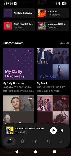

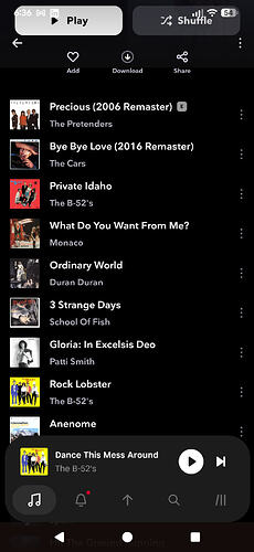

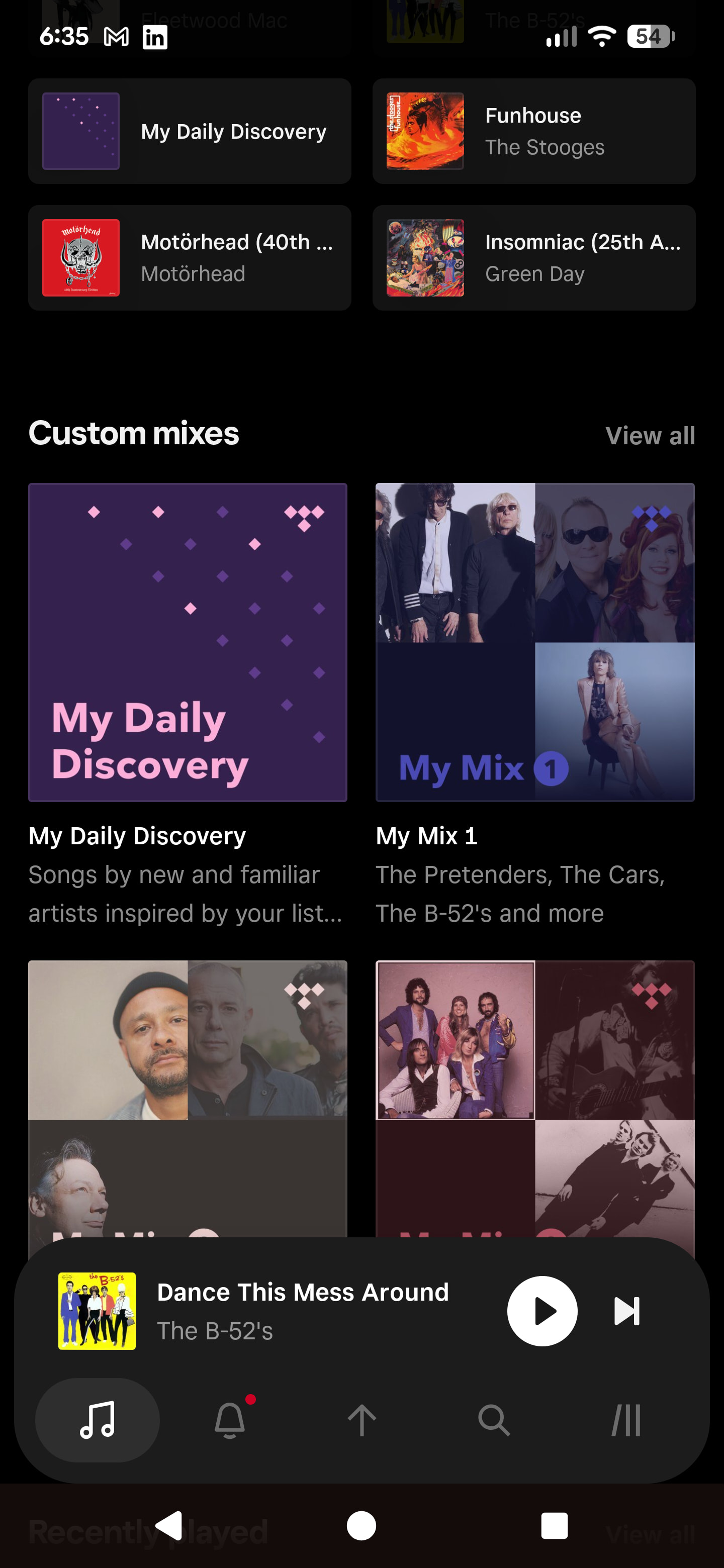

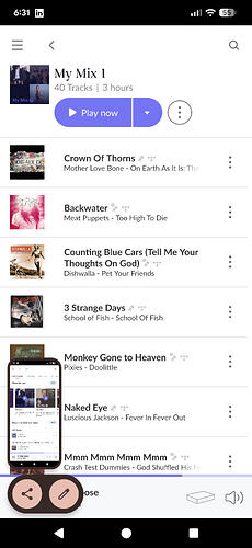

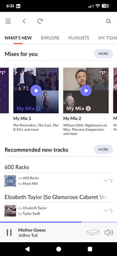

Actually, I think I spoke too soon: the issue still persists. To be more specific the titles of Tidal playlists get updated in Roon, but not the contents.
See attached
First is a playlist in Tidal app and its contents, next is the same playlist in Roon and it’s displayed contents. If I try to play the playlist in Roon what gets played is the actual tracks that are present in Tidal app, but the display in Roon doesn’t show them.
The auto-generated playlists don’t display contents properly in both my Android app and Windows 11 Roon client. The issue seems to come from the Roon server itself
