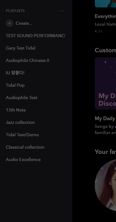

My Tidal playlists not visible in Roon. The first pic is my Tidal playlists, there's 11 in total.

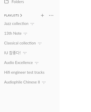

Roon playlist view
This is my Roon playlist view. Only 7 out of my 11 Tidal playlists are visible.

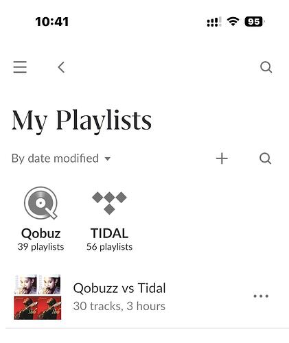

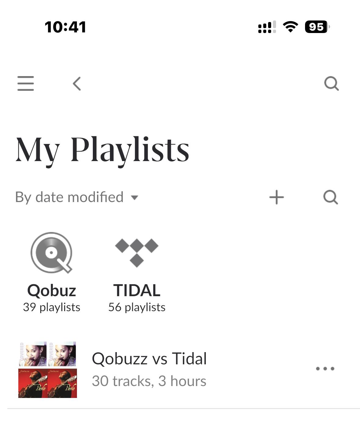

Out of the 7 visible, only one of them is created by another Tidal user, the rest of the 6 was created by me. The 4 Tidal playlists not visible are also created by other Tidal users who shared them with me and I have added them to my library. They used to be visible in Roon until 3 days ago. I tried creating a new playlist in Tidal, the new one is also not visible in Roon. It is not an issue with the number of playlists as my friend’s Roon has more than 50 visible in Roon. See picture.

The 4 playlists are:
  1. TEST SOUND PERFORMANCE, BEST TRACKS, selected by WiSound engineers
  2. Gary Test Tidal
  3. Tidal Pop
  4. Audiophile Test
