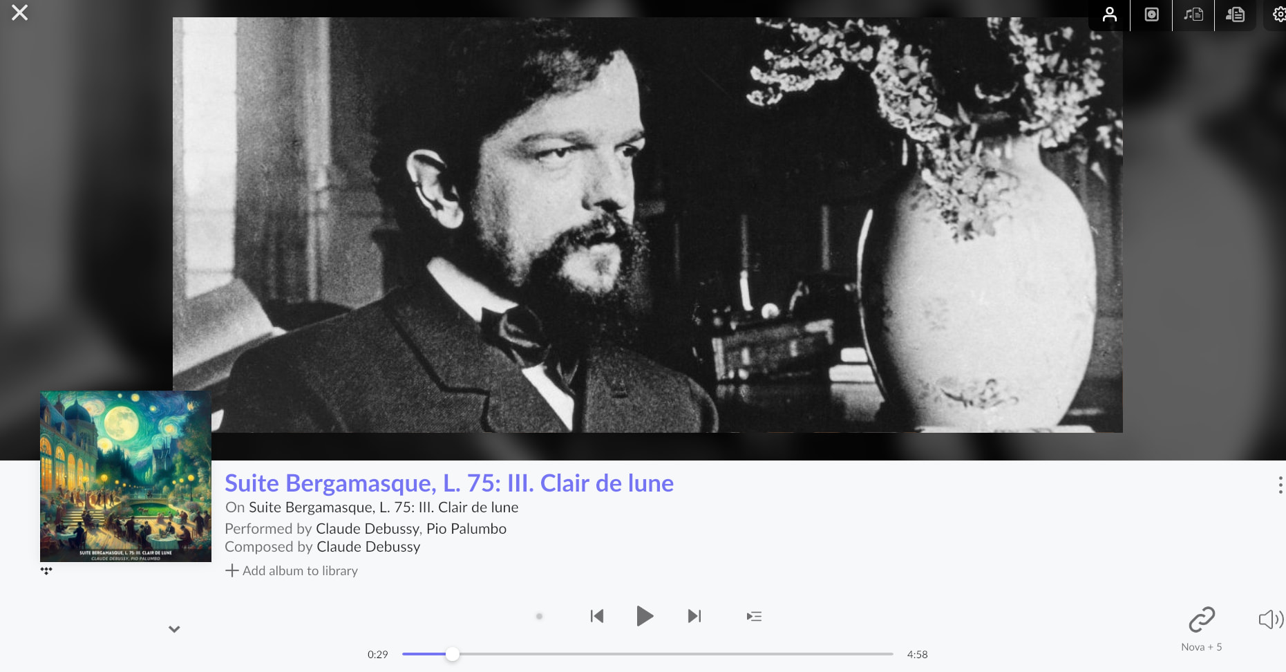

Here is one track that I have deleted several times from my Tidal Classical2 playlist. I have just double-checked, and this version is simply not there. Tidal on Roon has substituted a piano version for an orchestral one. If Tidal on Roon can’t find the same version, I would rather not have a substitute.

Thanks for the screenshot - that’s really helpful.
After looking at your Jun 16 diagnostics I can see what’s happening. Roon runs a set of “playlist improvers” on your Classical 2 playlist each time it detects a sync change. One of these, called UpgradeQuality, automatically swaps tracks for higher-quality versions available on TIDAL. On 14 Jun at 08:06 it accepted 36 such upgrades for Classical 2 – the Pio Palumbo piano version of Clair de lune was almost certainly one of those swaps, because it’s available on TIDAL in a higher-quality format than the orchestral arrangement (John Rutter/Manchester Camerata) you originally had.
This is also why the deletion doesn’t stick: when you remove the track in Roon, the delete may not be fully propagating back to the TIDAL copy of the playlist, so on the next resync the Pio Palumbo version is still there on TIDAL’s side and comes back.
Here are the steps most likely to fix this:
  1. Delete the Pio Palumbo track directly in the native TIDAL app (not via Roon), confirm it's gone there, and after the next playlist improver iteration, it should be gone.
  2. Re-add the specific orchestral version you want (Manchester Camerata / John Rutter) by finding it in TIDAL's own search and adding it to the Classical 2 playlist in the TIDAL app.
Let us know if deleting via the native TIDAL app resolves the reappearance issue.
