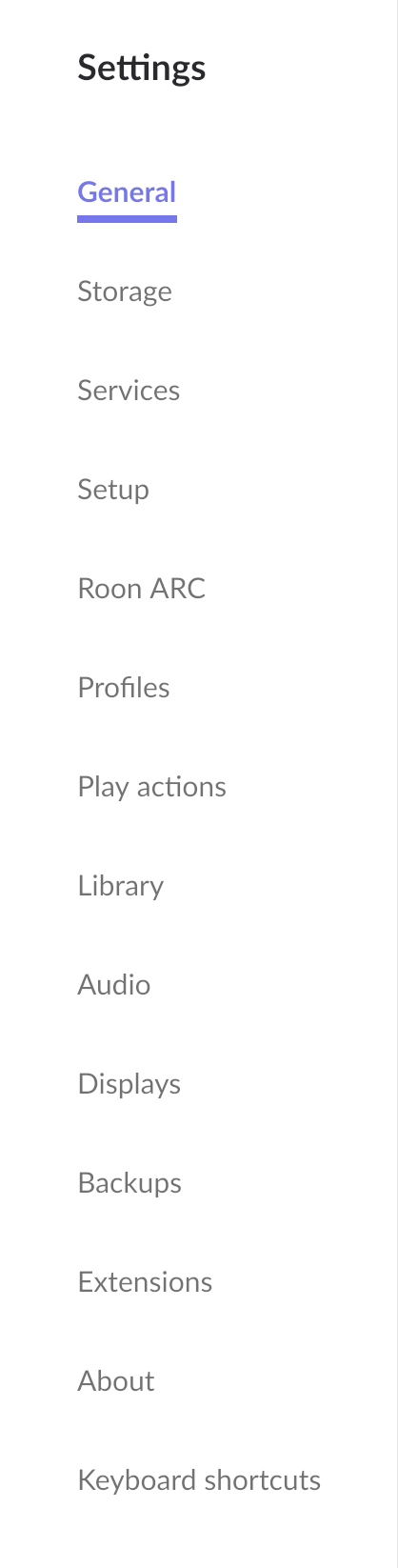

@noris when I was testing this over the last couple weeks, I found that the issue occurred less frequently with non-grouped zones. When I lower the resolution by playing a version of an album that is lower resolution, it definitely helps. But I was hoping to be able to play at the higher resolution rather than at just CD quality. I’m not able to find that specific setting though. There’s not a “Streaming” tab in my Roon settings. Here’s the settings option in my Roon:

Thanks for that additional info. Apologies, the correct path is Settings → Services → Edit (next to TIDAL) → Streaming Quality. You can try to lower that, but as you mention it will limit your ability to play higher resolution content.
