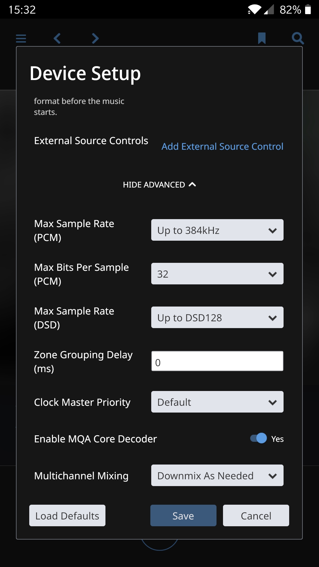

Can you post your signal path that’s showing in Roon when playing on the iphone. click on now playing and the coloured dot on the right to reveal this and post it on here. Do you have enable mqa core decoder enabled in the audio settings advanced section?

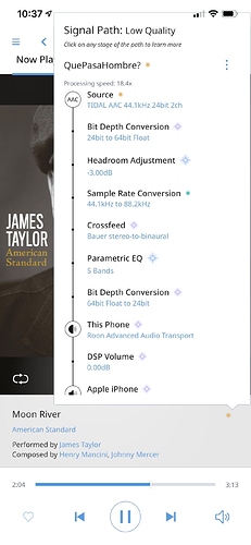

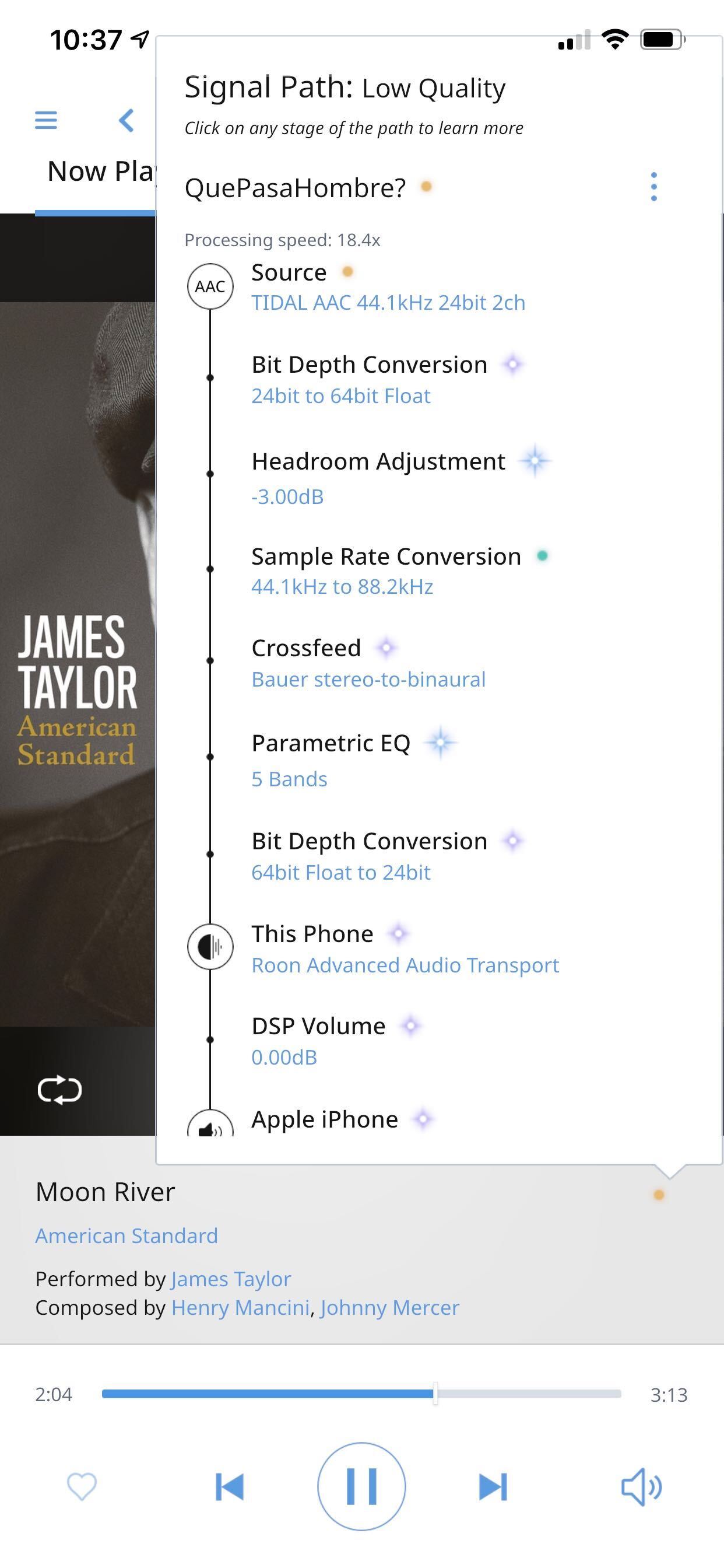

The decoder setting is enabled. Looks like Sample Rate Conversion is the bottleneck, which at least is consistent with the error.
Could you show an MQA track not an AAC one.
Well, that may be my problem. I’m clicking on the MQA version to play but clearly the AAC versions are playing. Try as I might, I’m unable to get the correct version to play. I upgraded my Tidal account recently, and I know the upgrade happened because, as I said, I can listen to MQA in the Tidal app, but perhaps I need to do something different in the Roon app.
Ok. Fixed it. Your questions led me right to it. There’s a setting in Services, Tidal for Streaming Quality. This was set to High; it needed to be set to Master.
