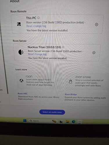

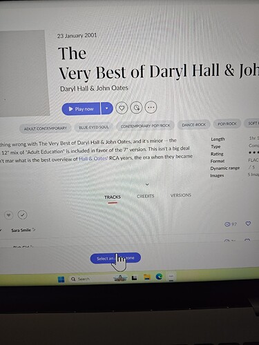

I have a Windows 11 laptop and a newer Android phone which are having the same intermittent issue of losing connection. The music stops, preamp shows DSD64 and a slight clicking noise is heard from the speakers. On the laptop the connection is lost and a bubble pops saying choose device. If I go to settings the Titan flashes on and off as there, and then gone. I rebooted everything multiple times. Latest OS on Titan. Wired connection to modem.
