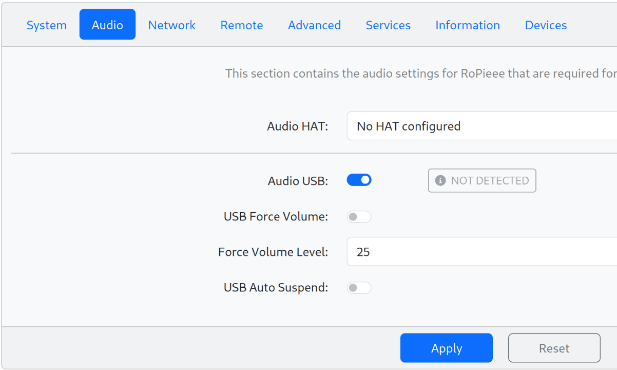

I finally figured out that the USB DAC was not showing in RoPieee AUDIO. USB AUTO SUSPEND was disabled for some reason? I upgraded the RoPieee to 2025.01. This did not change the behavior.
I re-enabled USB AUTO SUSPEND. Did not change behavior.

@spockfish I’ve got the same issue again. RoPieee 2025.01 on Raspberry Pi 4b, 4Gb RAM, 32GB SD card. The Topping E30 II connected via USB and is displaying OFF on it’s screen and Roon doesn’t see the RoPiee endpoint at all. In RP, there is no USB DAC detected. However, since my original post I have not turned on the USB auto-suspend:
I have not rebooted the RP node yet. As always, it is hard wired to my network with a static DHCP entry. This does not appear to be a network issue. I’d like to listen to music but I will leave it in this state until I hear back. Thanks for the help, and Harry, I really am appreciative of your efforts in giving the community this software to help us all enjoy music. Feedback code below:
