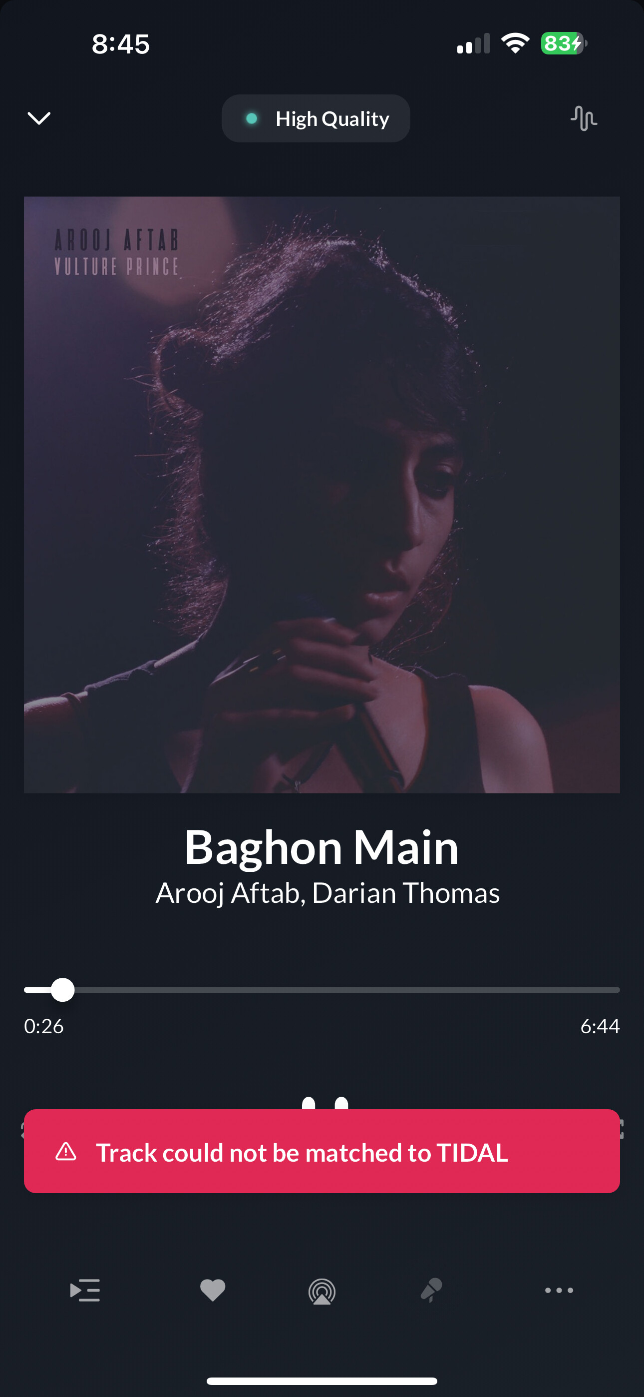

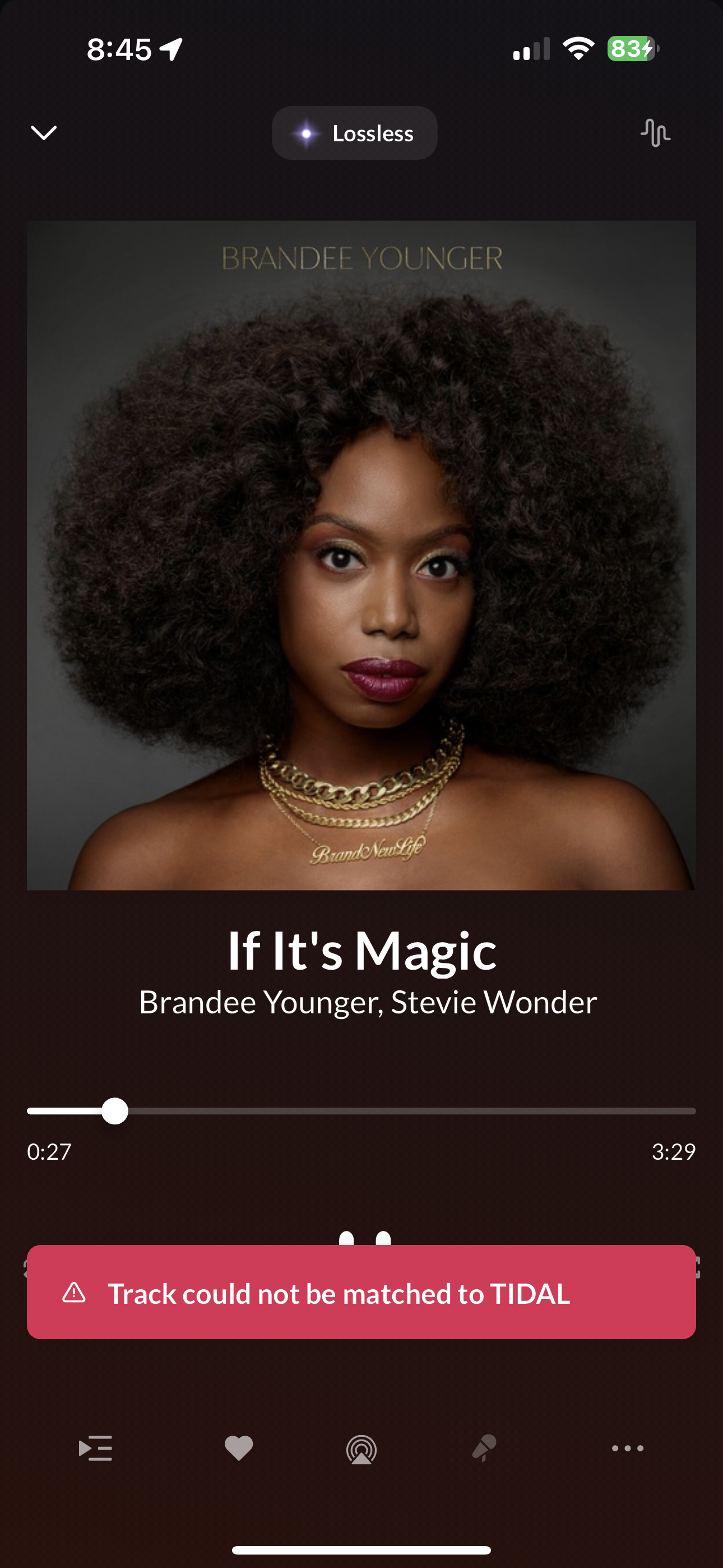

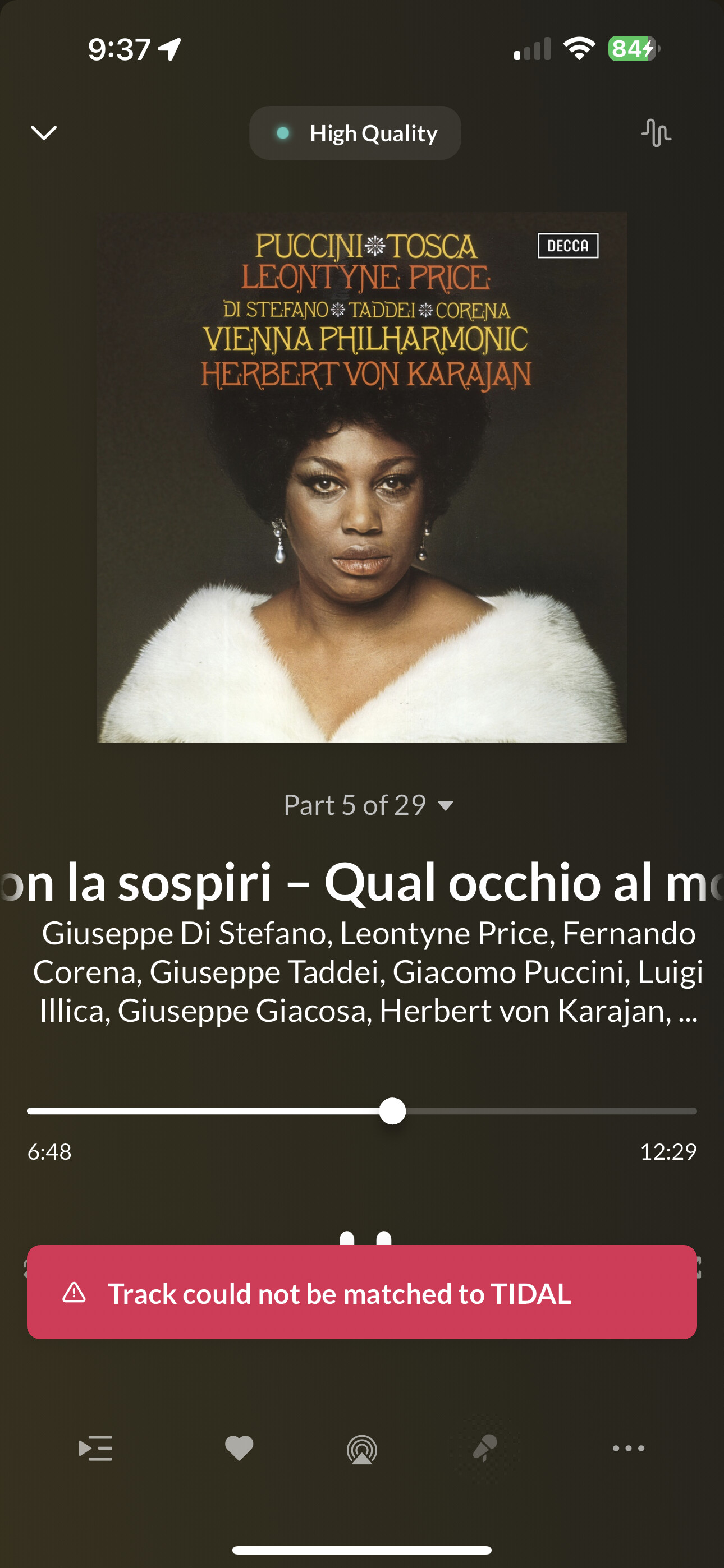

Track could not be matched to Tidal (ref#9RATLT)
Error message: Track could not be matched to Tidal
Linksys mesh, Asus router

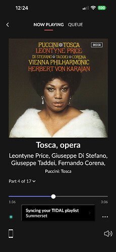

These tracks and albums are available at Tidal. I have not been successful at transferring them to a Tidal playlist although I’m experiencing no difficulty with Qobuz.
It doesn’t appear to function at all with Tidal following several attempts.
This appears to be an issue affecting Roon ARC only.

Hey @Singleton,
Thanks for the follow-up and for your patience! We’re seeing repeated rejections from both Tidal and Qobuz’s API, likely resulting in the failures you’re seeing.
Have you made any recent changes to your Tidal account? Have you recently logged out and refreshed your sync with Tidal through Roon? How is your server connected to your local network?

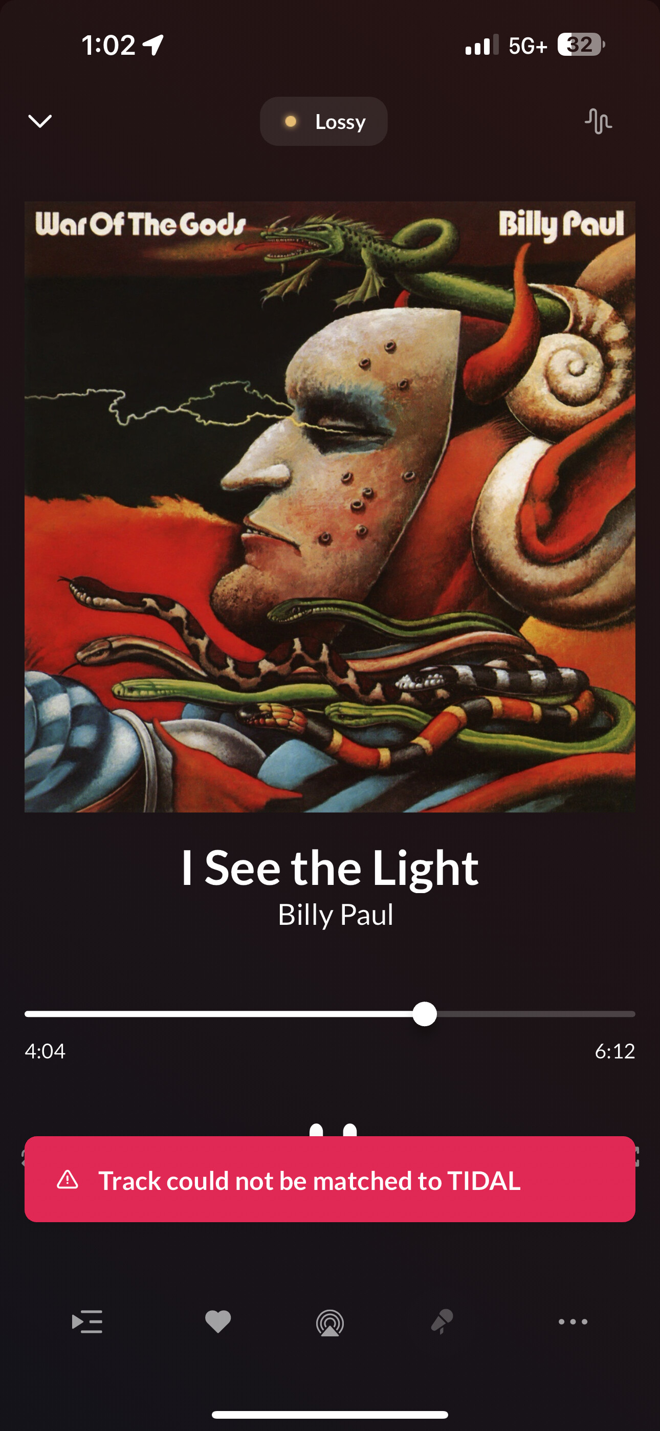

I have a work around and I was more concerned with bringing the issue to your attention. You just reminded me of the issue and I’ve looked at it more closely and I may have some clues.
Maybe I’m in error and don’t understand how Roon should properly work in this fashion. Here’s what’s going on:

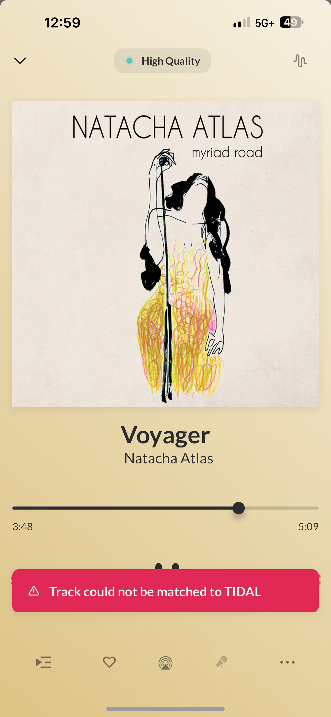

Qobuz is my default service but if I attempt to save an album or track to Tidal while listening to a Roon library Qobuz track the previous error occurs.
If I add the same album/track from Tidal making it a part of my Roon library and I attempt the same excercise of adding it to a Tidal playlist my experiment will fail that is if I do so while saving from a “Qobuz” library element.
I have to open the newly downloaded album/track Tidal then save to a Tidal playlists to succeed.

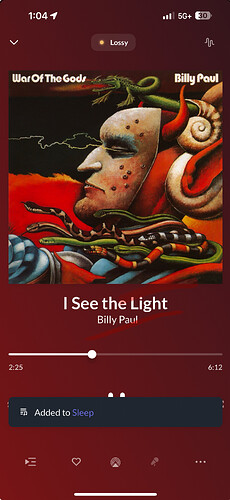

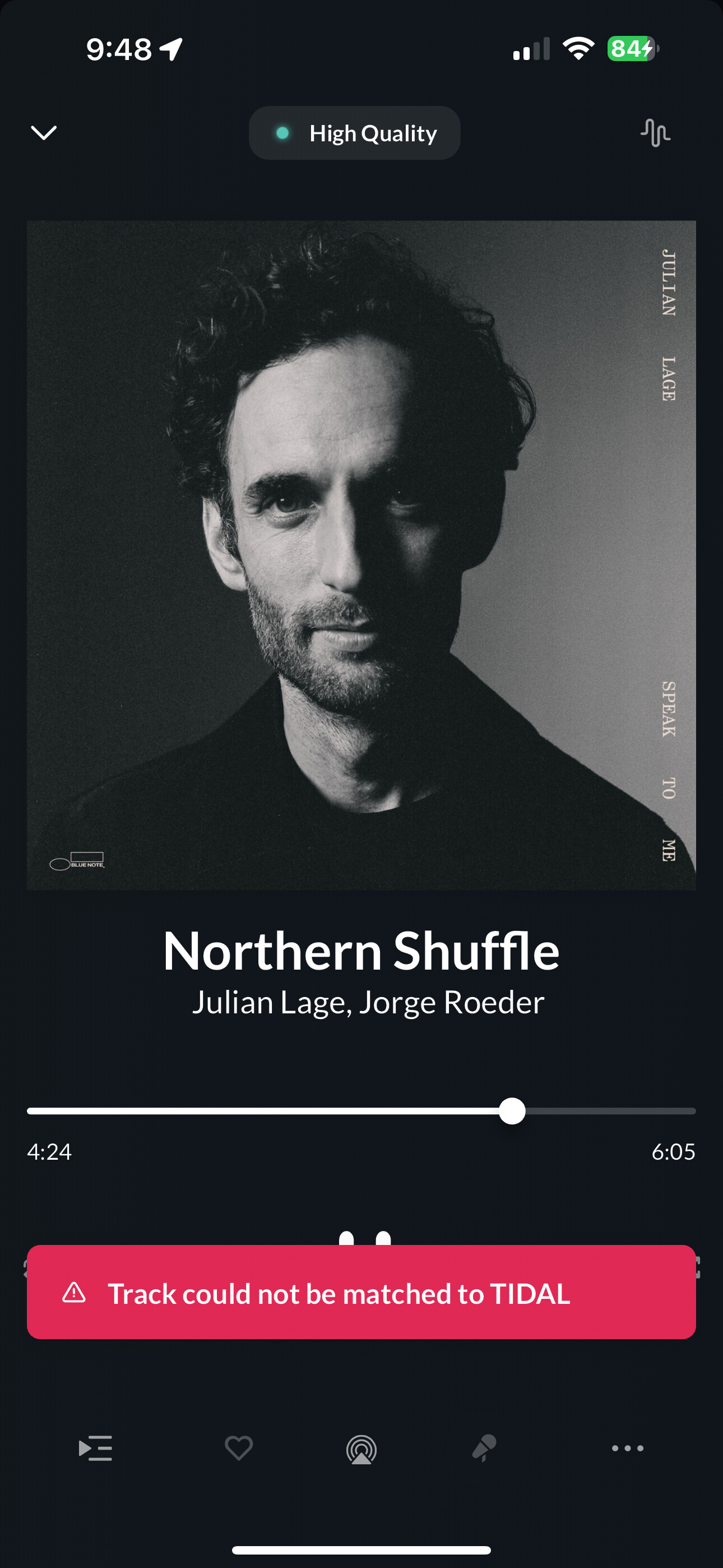

Failure following adding Tidal album

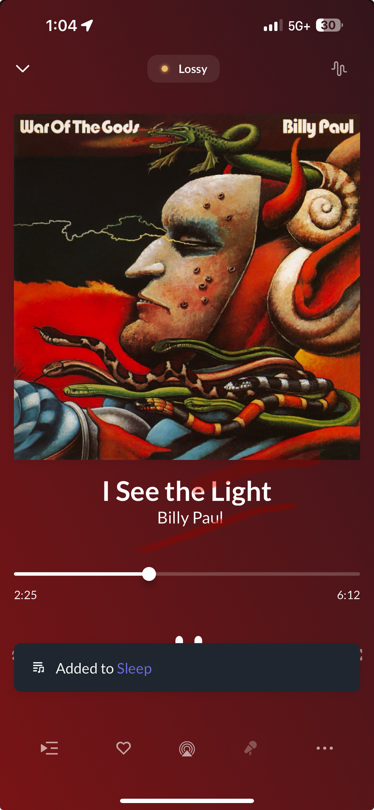

Success following saving “from” newly added Tidal album
