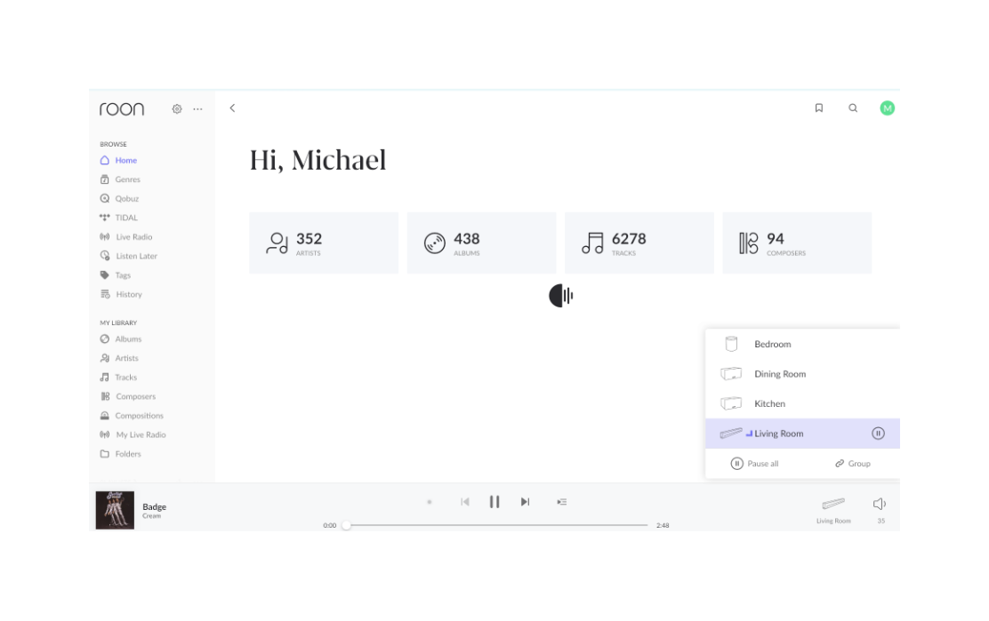

I tried to start a track from the beginning and it froze. Roon was saying the track was playing but it wasn't. I'm connected to 4 Sonos speakers and they're all frozen. I've tried unistalling and re-installing Roon. I've lost all content now but it's still sayinghte track is playing.
Virgin router. Sonos speakers. Track was from Qobuz.

According to the logs your zone “Living Room” is where the problem originates.
That speaker is next to the router. So the mesh extender won’t be coming into play.
My living room speaker has a position timer out of place. Can you clarify what that means? The speaker is a playbar and was the speaker I was using when roon froze. Are these things connected? Would re-booting the playbar help?
