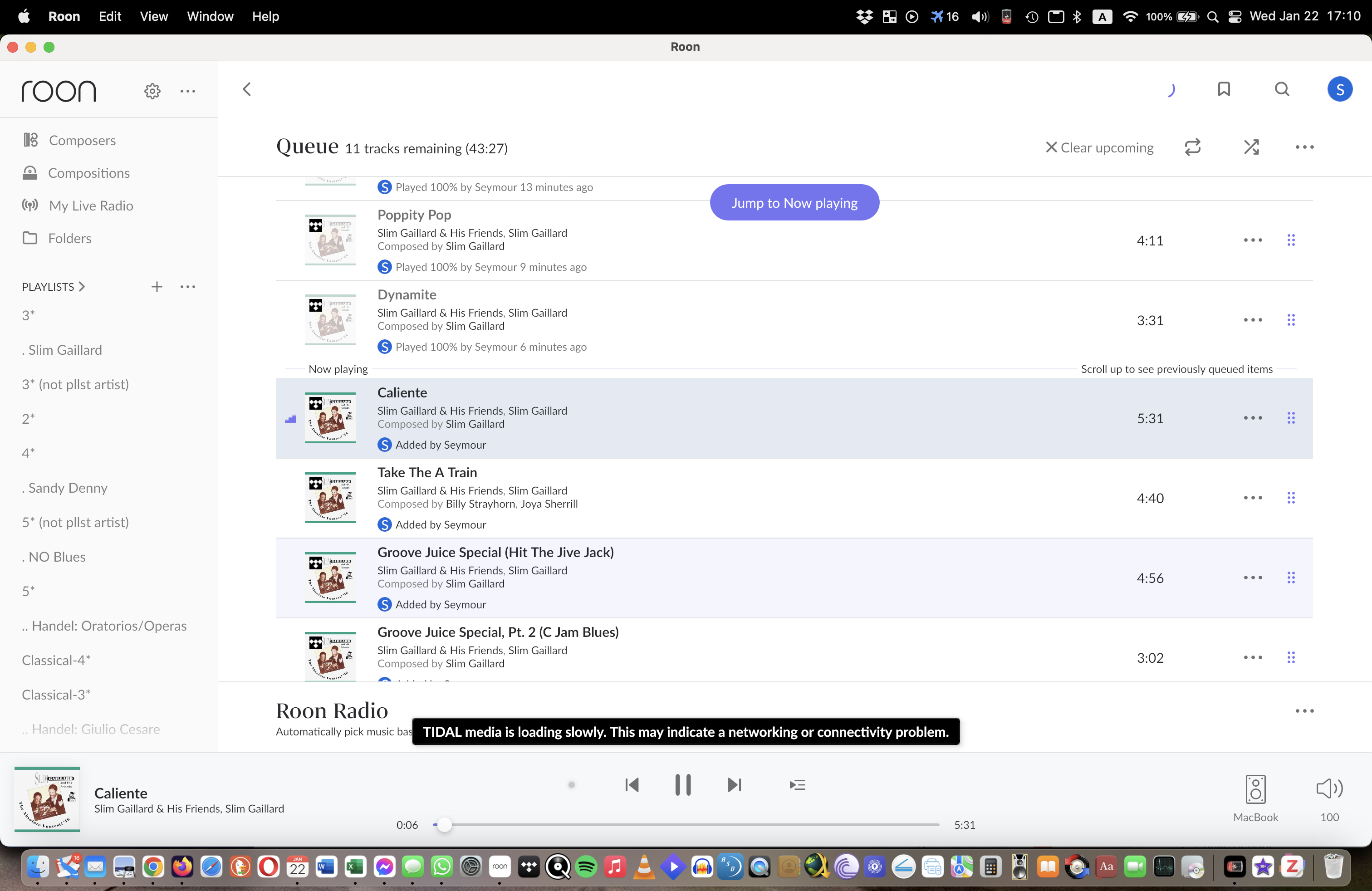

When I pause a track even for a few seconds and then press play, or drag the time bar a bit, one of three things will occur: Either it takes up to a minute to resume playing, stays frozen until I restart Roon, or it shows the “Tidal (or Qobuz) loading slowly…” message and skips to the next track. Rebooting the core doesn’t help.

We see RoonServer establish an initial connection to Tidal and begin to download the content to RoonServer’s buffer cache. However, requests to streaming servers almost immediately begin to time out - furthermore, RoonServer reports that samples are dropping out in the stream from Tidal, and it begins to re-request these missing samples. In some cases, the missing samples never arrive in time, forcing Roon to tear down playback. This occurs more frequently when the cache doesn’t have a large amount of data stored, like after scrubbing the playbar, rapidly skipping tracks, or pausing/resuming.
To troubleshoot this efficiently, we’ll need to know the network pathway between ROCK and the internet, including any WiFi-reliant components like access points or mesh nodes. I recommend changing the assigned DNS server in your router to Cloudflare (1.1.1.1) or QuadNine (9.9.9.9), to verify that the Tidal API addresses are resolving reliably.

I changed the assigned DNS server in my routerto Cloudflare (Primary 1.1.1.1; Secondary 1.0.0.1; Host: mynetwork,monreseau,home). This appears to have solved the problem.
