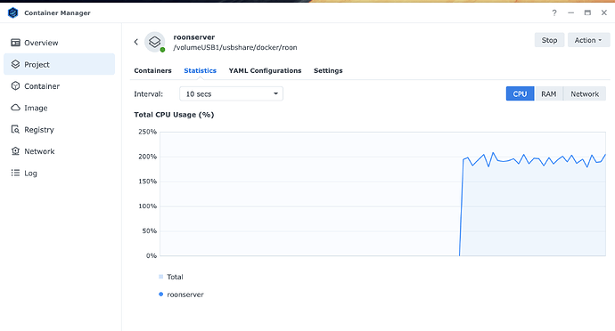

Please take a look at my logs around 6:09 PM on July 22. My CPU is being cooked and I’m just sitting here not playing music at the moment or browsing Roon.
Hi @yuhyuhariana,
Thanks for the follow-up! We haven’t yet pushed the additional optimizations over to Production yet, so it’s expected you’d still be experiencing the same behavior until this happens.
You have our apologies on that!
I understand, I was just alerting in case it would help the team study the behavior
Absolutely, thank you for the thought @yuhyuhariana and for your longstanding patience here. :+1:
