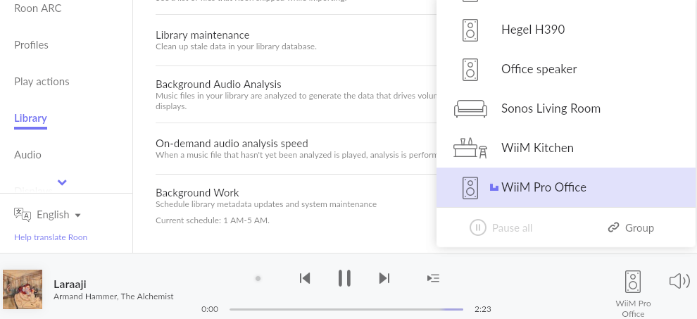

Is there any change in behavior if you try to navigate to Roon Settings -> Library and set both Background and On-Demand Audio Analysis to Throttled or Off?
· No, the issue is still the same

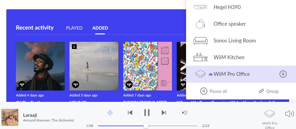

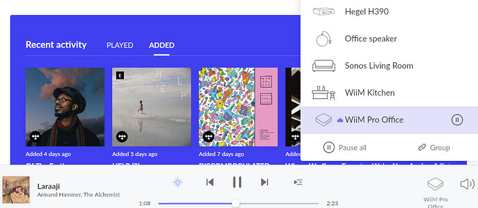

In my screenshot I’ve included the different end points to show that the catch-all icon for Roon ready/tested device is showing instead of the manufacturer model icon - I haven’t seen this happen before so thought it worth including.

A hard reboot seems to have done the trick. It didn’t take long to kick off a new track and the end-point images have been restored.
