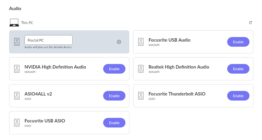

Enable the individual audio devices you see in audio, this pc then try.

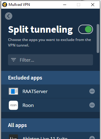

Googling this error “[zoneplayer/raat] failed to sync sender clock to endpointSystem” pointed me towards some forum topics about VPN software interfering, maybe blocking ‘clock signals’? :thinking:
Disabling my VPN didn’t help though, and Roon.exe was already in the VPN’s list of excluded apps. But… disabling the VPN and then also disabling and reenabling the audio device in Roon did work. So it did have something to do with the VPN… Then it dawned on me that Roon not only uses Roon.exe, but also RAATServer.exe :exploding_head:
Adding RAATServer.exe (in C:\Users\jp\AppData\Local\Roon\Application ) to the VPN’s list of excluded apps seems to have solved the problem! :partying_face:

Thanks, I already tried that. I enabled them all, the ASIO’s, the WASAPI’s… Focusrite, Nvidia and Realtek. When enabled they appear in the long list of audio zones of course, but none of them work, so I leave them disabled. Roon should use the Windows system device anyway, which usually is the Focusrite.
