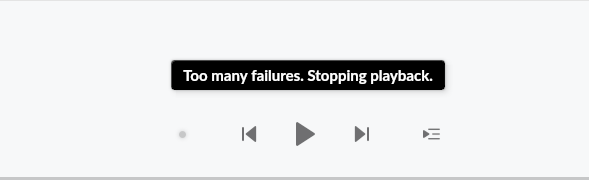

Tracks are skipping and stopping after 'Too Many Failures'
Single Router
I have attempted to play with the System Output audio zone with the same result. I have also used a different audio device entirely and have the exact same result. This issue began after downloading Ableton. I suspect it has something to do with conflicting control over the audio device, but the issue persisted even after uninstalling Ableton, uninstalling and reinstalling Roon, and uninstalling and reinstalling the Focusrite Drivers. All other system sounds and programs are able to play music without issue, including using Tidal with exclusive mode.

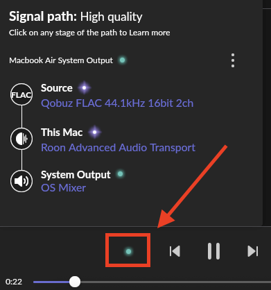

Hi @tim.brown92,

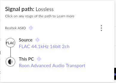

After you’ve started playback via your System Output - click the colored dot to the left of your play commands:
Screenshot 2025-04-09 at 16.02.40

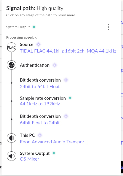

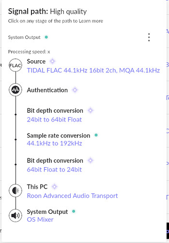

Thank you! Below is the system output mix:
Hi @tim.brown92 ,
Thanks for the screenshot. It is very strange that the processing speed is just listed as x and with no additional information, I have not seen this kind of behavior before. It looks like you have upsampling turned on, is the behavior the same when trying to play lower rates as well? If you set your system output in Windows to another output (like your internal speakers for example), does that work as expected?

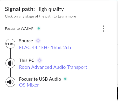

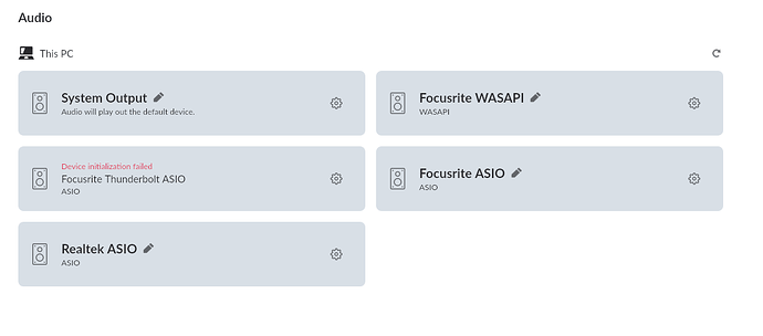

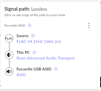

Hello,

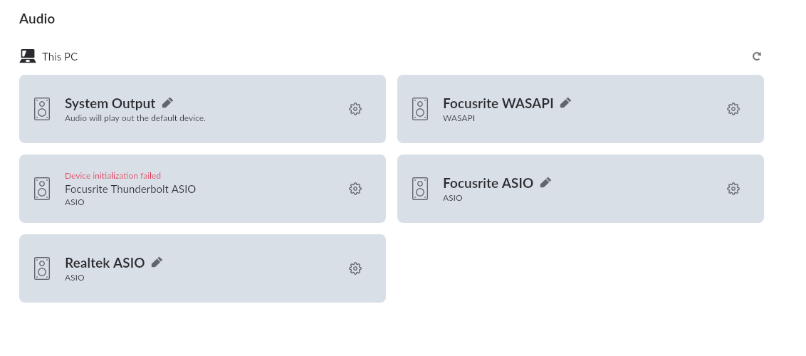

Attached are screenshots of all the output options I have and the path for each of them. Unfortunately, none are successfully playing music.
Focusrite ASIO
Focusrite ASIO Path
Realtek ASIO
Realtek ASIO
Focusrite WASAPI
Focusrite WASAPI
