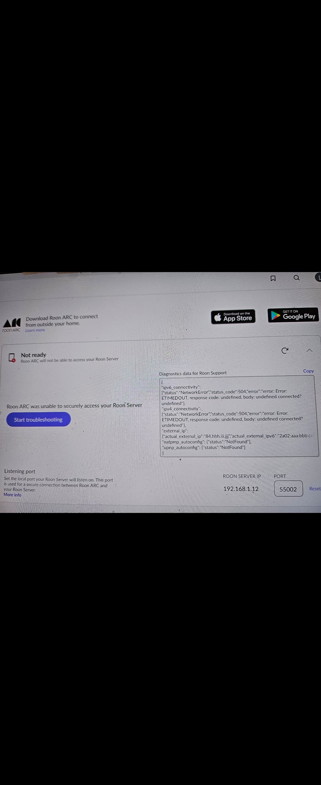

Can you please go to the Roon Desktop app and test Roon ARC connection like on the screenshot below and share same screenshot from your side to us ?

Concerning port forwarding, we’ll need to see the error message requested by my colleague @alex_h in the post above in order to know what’s specifically wrong.
