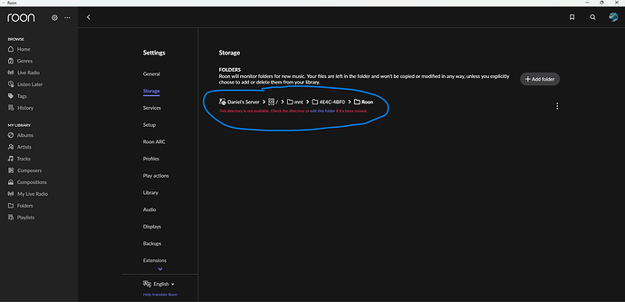

Did you also set your music folder up as a watched folder within your Roon Settings>Storage? If you can, please share a screenshot of your storage settings screen.

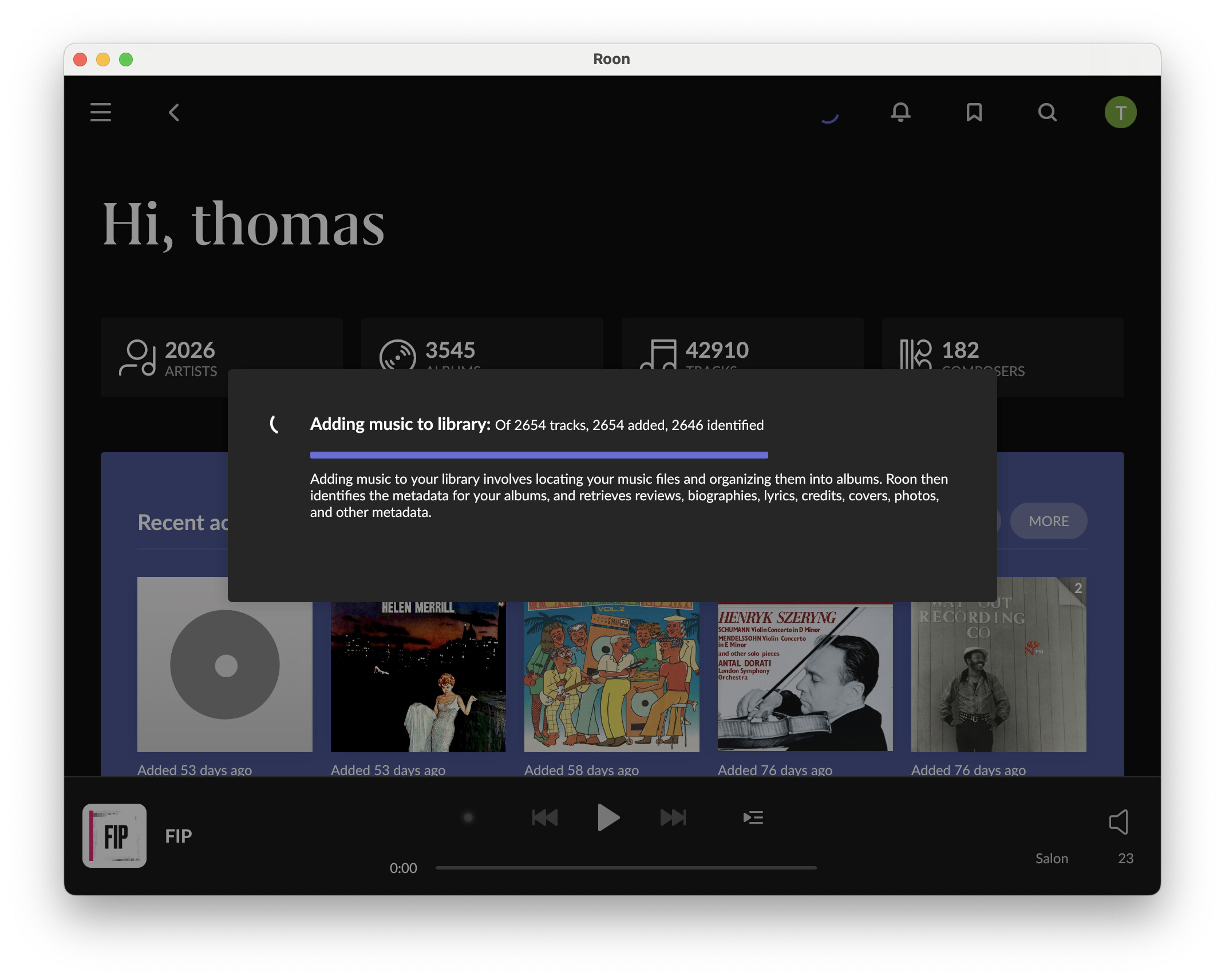

I’ve noticed that the wheel keeps spinning (see attached screenshot). Could this be related to the issue I encountered earlier? It has been spinning for several days now. Is there anything I should do to resolve this before transferring my library to the new Mac?

I have tried to follow these instructions but I’m stuck on the Preparation step ("Also, on your old server, please confirm that the import process has completed. You can monitor this process by clicking the spinner in the top-right. If you don’t have a spinner here, you are done importing.). I’ve been having an endless spinner for a week now.
I have tried quitting Roon and restarting but it keeps spinning. Please help.

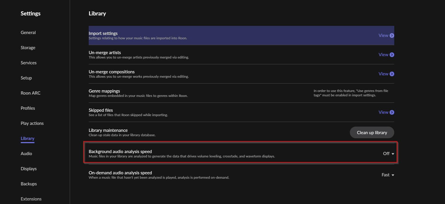

If you go to Roon settings → Library and set background analysis speed to off does the spinning stop?
