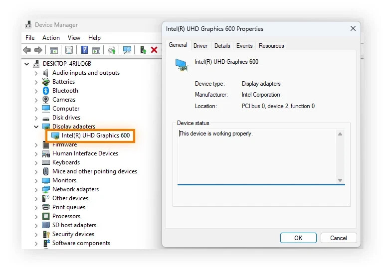

On Windows, you can do this in Device Manager, by expanding the Display Adapters section, right-clicking your graphics card, and choosing Update Driver Software. If this doesn’t work, make a note of your graphics card model, and visit your manufacturer’s Support page. Often you will find the newest drivers there.
If you’re still having problems and you believe your system is capable of running OpenGL 3.0, please let us know what graphics cards you’re seeing in the Display Adapter section of Device Manager, like this:
