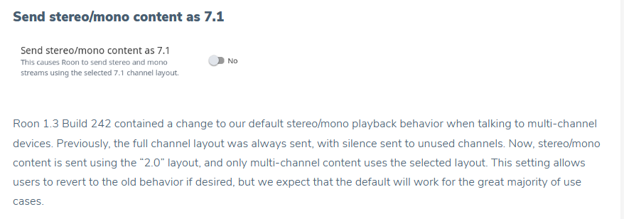

But, as ROON have an option to play mono/Stereo contents also as 5.1 or 7.1 MCh music,
i want to try that.I edit that in the (advanced) device manager in my Altitude32 source, but still getting only 2 channels out. So, as the Altitude32 can play MCh sources, i suspect that ROON doesnt make the “upmix” from stereo music to 5.1 or 7.1 music. Have you or anybody the same experience ?
What do i make wrong ?
You are correct. Roon does downmixing when necessary but does not do upmixing. You may be trying to use the Send stereo/mono content as 7.1 switch. However, as you can see from the below from the Roon forum, all this does is send stereo to L/R channels and sends silence to all other channels. It doesn’t do any remapping.
If you want to upmix stereo to 5.1 or 7.1 or even more, use the Upmix on Native feature in the Trinnov.
