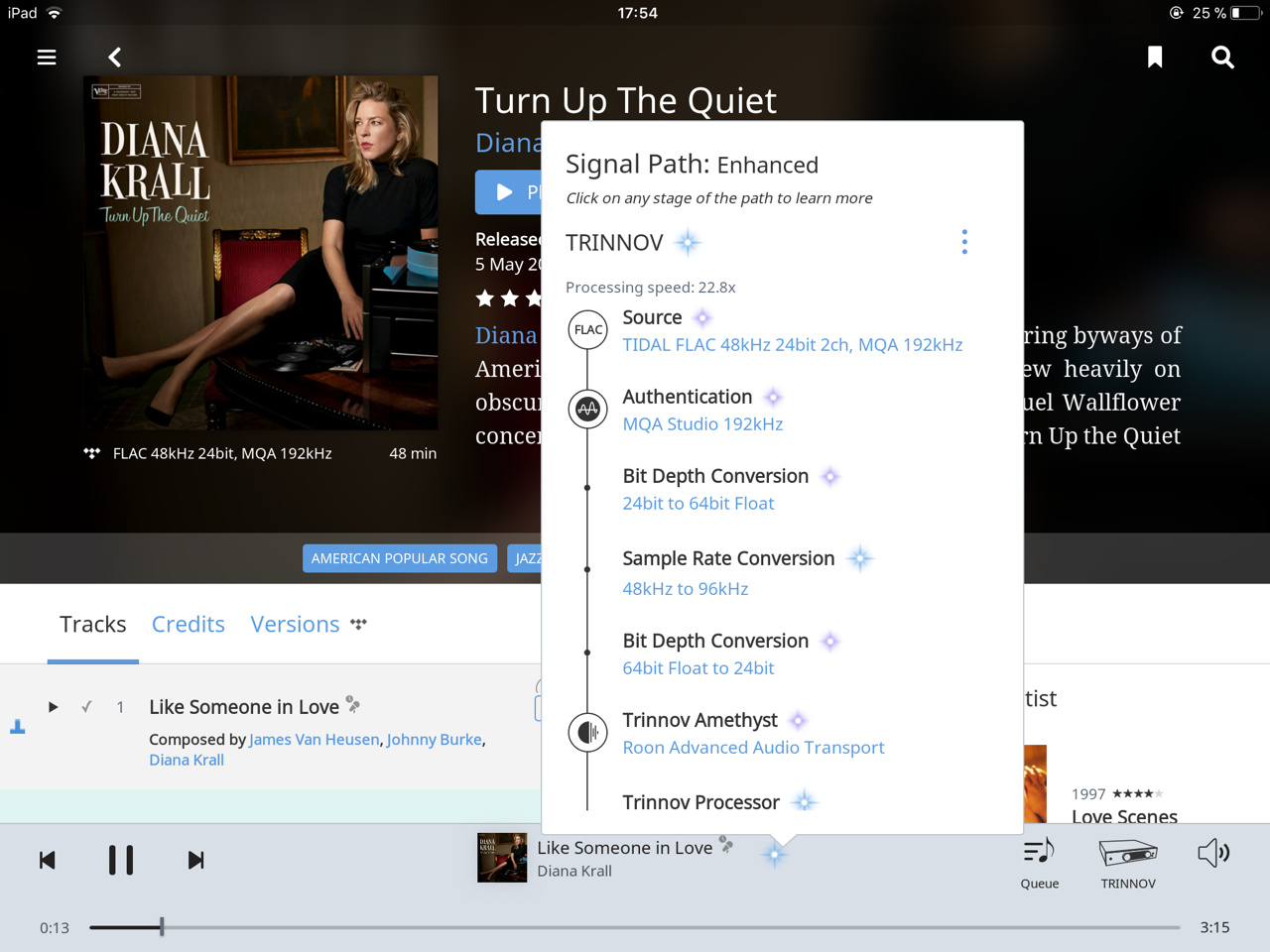

Enclosed are two “signal path” screenshots of a regular cd.
The Trinnov is there, but not reported as “Roon ready” device.

Hello @RobertW,
  1. The Trinnov Amethyst is a “Roon Ready” device. This means that when playing to the Trinnov Amethyst over the network using Roon, you are getting the highest quality possible. Since you are using the ethernet connection to the Trinnov, you are using the “Roon Ready” functionality correctly. When playback starts from Roon, the device should automatically switch to the “Roon Ready” input.
  2. I believe the reason why some music isn’t playing correctly on your device is due to the fact that you have a master clock set to 88.2kHz. Many MQA files start off as 24bit 48kHz which is then unfolded to 24bit 96kHz by Roon’s MQA Core Decoder. In order to get the files to play on your device with an 88.2kHz master clock, you would have to resample the content to 88.2kHz for playback to work.
  3. Unless you have a reason to be using a locked 88.2kHz master clock, I would recommend setting the clock on the Trinnov to “slave”. This will allow the Trinnov to detect the sample rate of the incoming stream and change its clock setting to match.
  4. If you do have a reason to use the 88.2kHz master clock, you can use Roon’s DSP Sample Rate Conversion feature to resample all content to this rate. Open the DSP screen from the volume control pop-up, enable “Sample Rate Conversion”, and then set the configuration to custom. Here you can manually resample all content to 88.2kHz.
