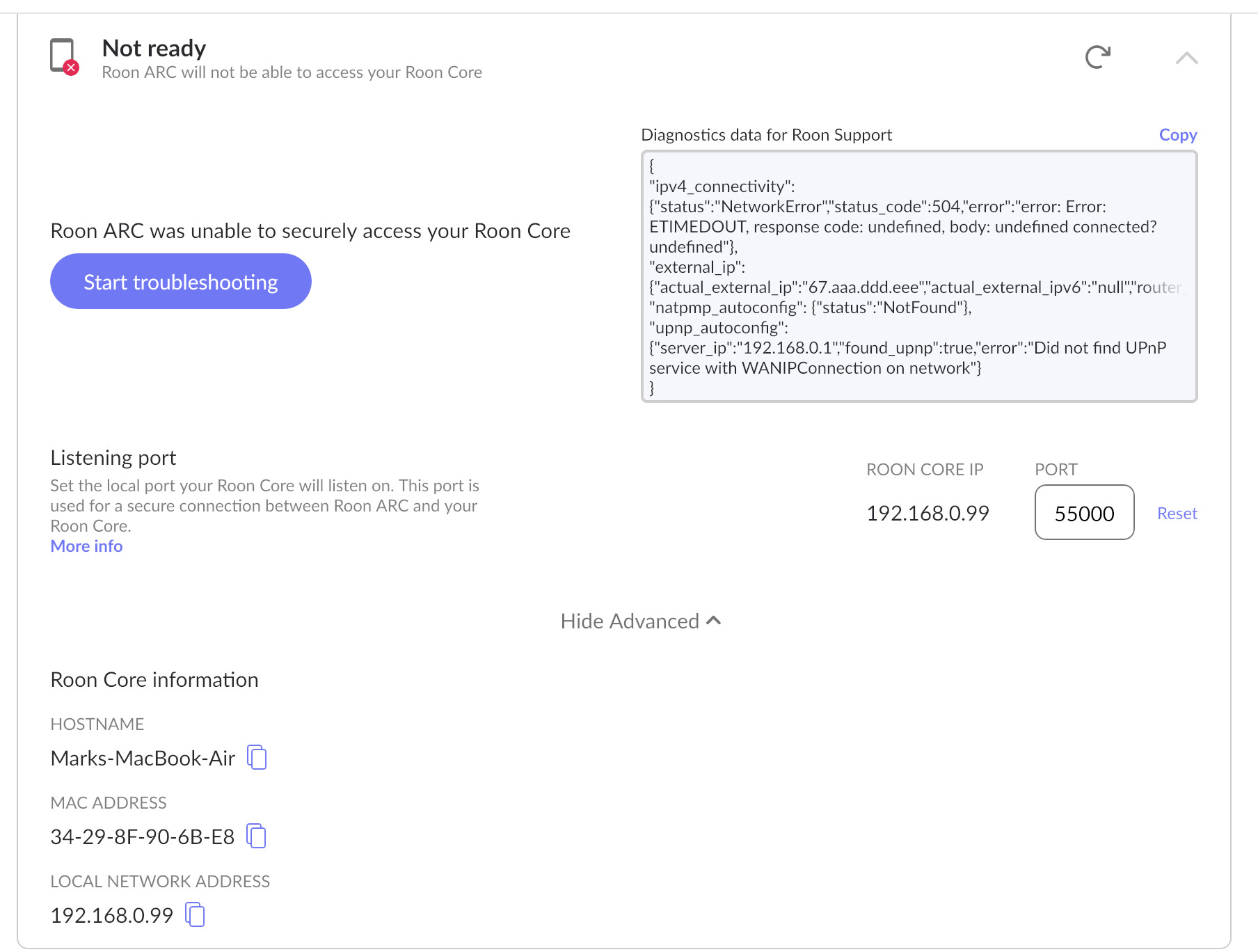

Cannot set up ARC on Roon to be used outside the home
I get this:
“ipv4_connectivity”: {“status”:“NetworkError”,“status_code”:504,“error”:“error: Error: ETIMEDOUT, response code: undefined, body: undefined connected? undefined”},
“external_ip”: {“actual_external_ip”:“67.aaa.ddd.eee”,“actual_external_ipv6”:“null”,“router_external_ip”:“null”},
“upnp_autoconfig”: {“server_ip”:“192.168.0.1”,“found_upnp”:true,“error”:“Did not find UPnP service with WANIPConnection on network”}
I have set up UPnP NAT on my modem. So they are enabled.

The diagnostics you’ve provided suggest that UPnP is not properly configured on your router.
Please first try the following steps:
  • Try to enable UPnP/NATPMP in the web administration interface for the router directly upstream from your Core
  • Try to manually open the port in your router’s port forwarding configuration
  • Make sure the IP/Port matches the Port listed in Roon → Settings → ARC
  • Check for any VPNs or Firewalls that might be interfering
  • Check if your modem is in Bridge mode
If you continue to experience difficulties, please tag the support team and include the following information:
  1. What is the make and model of your modem and router?
  2. Do you have any additional network hardware, like additional routers or managed switches?
  3. Who is your internet service provider and what is your geographic region?
  4. Is your Modem configured in Bridge Mode so that it operates only as a modem or do you have the ports forwarded on both?
Thank you. I have done some of what you suggested but not all of it yet. I will have time to look at it this afternoon and will report back. Thank you again.
