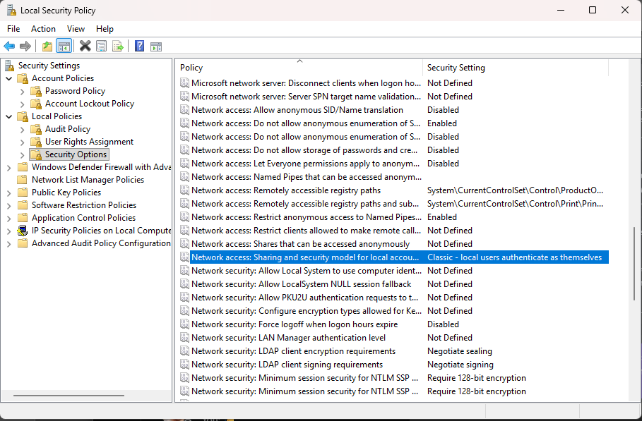

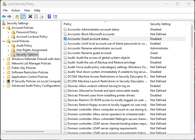

[SOLVED] Hi again,
I have gone back to this and got it working in Windows 11 Pro 24H2/25H2.
In addition to steps 6 and 7 in the above MS advice, you need to change settings as follows via Local Security Policy (type this in taskbar)/Security Settings/Local Policies/Security Options:
Accounts: Guest account status > set to Enabled
Network access: Sharing and security model for local accounts > set to Guest only - local users authenticate as Guest

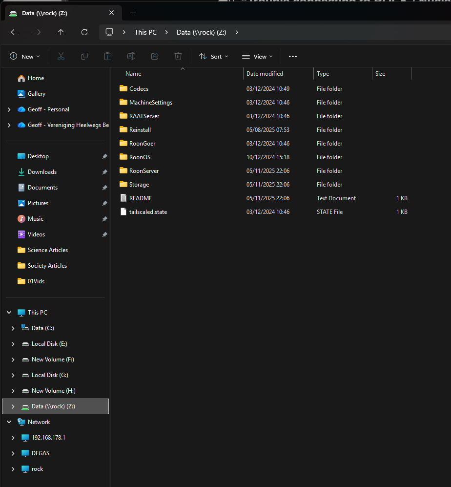

Then map a network drive in This PC, entering a drive letter and the path \ROCK\Data (two backslashes before ROCK, only one is appearing in this text box).
As well as having Reconnect at login checked as standard, also check Connect using different credentials. After clicking Finish, enter Guest as user name and password.
The drive is available in This PC, but ROCK still does not appear in Network, I gather because MS’s method of network discovery is not supported by Roon.
I hope this helps.
Windows File Explorer tends to forget about certain non-Windows devices. Just type \\ROCK into the address field (not the Search field) of File Explorer and it will show up.
