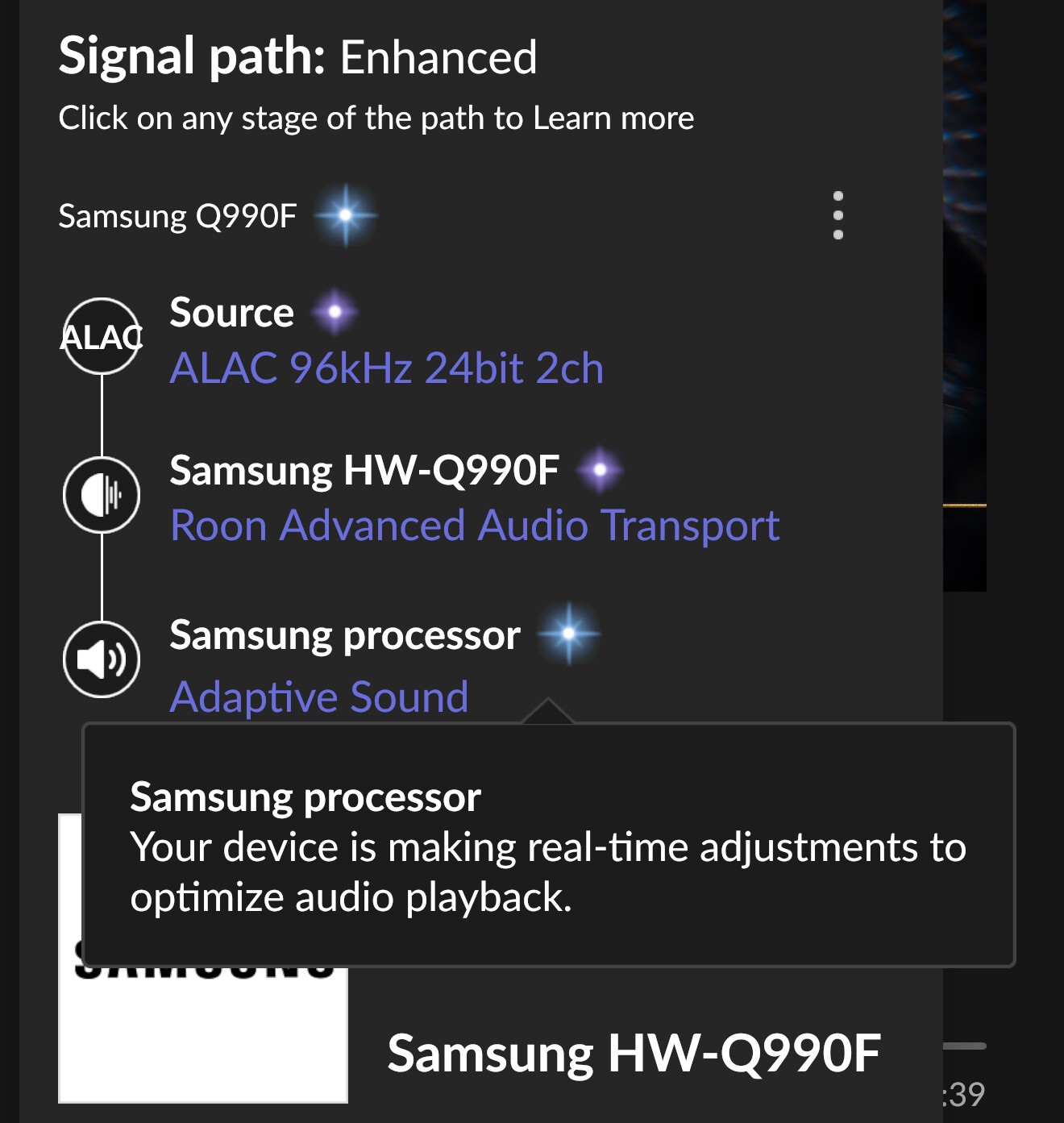

It should then say “Enhanced”. I also have the q990f and I don’t know how to disable the Samsung ai processing which makes it not show “lossless” signal. I can set it to “Standard” audio mode and disable spacefit pro, but it still shows this.

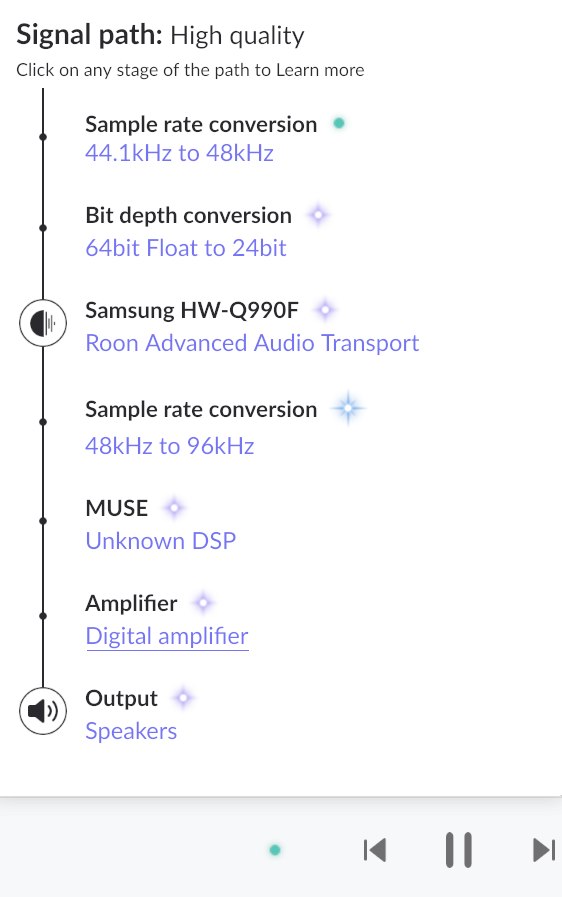

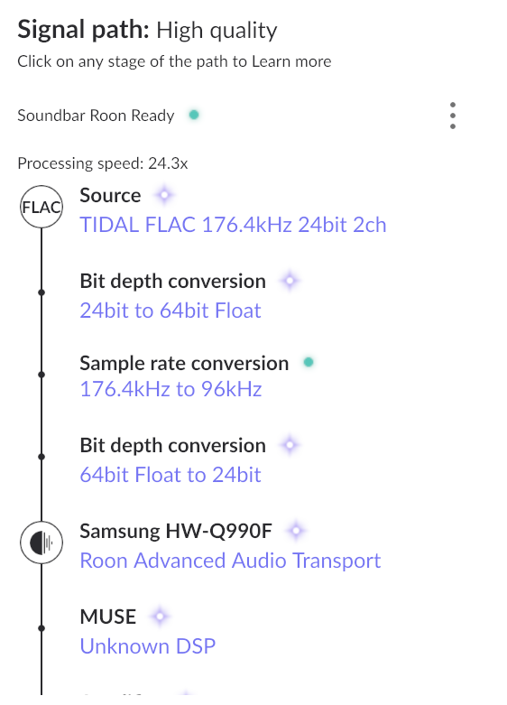

It would seem that the soundbar only accepts 48 kHz or 96 kHz sources (which are normally associated with video playback.) Roon resamples as it as computer (Roon Server) more precision than a solid-state device.
In the first example, 44.1 kHz was upsampled to 48 kHz by Roon (and subsequently upsampled to 96 kHz), and in the other, 176.4 kHz was downsampled to 96 kHz. This is typical of this kind of device, which applies its DSP to emulate multichannel with only a few speakers.
The clue is in the signal path. Roon has no control beyond the Roon logo.

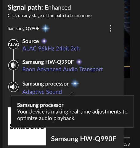

Yes, I can confirm that the Q990F via WiFi input using the “Roon ready” audio connection is limited to 96kHz, while the soundbar itself can handle up to 192kHz audio signals via hdmi (and possibly optical connection? Haven’t tried that yet).
Your mileage may vary with using usbc to hdmi conversion; I did end up showing a lossless signal with ASIO4ALL using a usb-c to cdmi converter, but the sound was very thin and lacking quality. I tested output from usbc via both PC and iPhone, but didn’t have a different cable to try.
I believe if you use an exactly 96kHz audio sample that it will still not show “lossless” but instead “enhanced” because of the built in processing done real-time by the Q990F soundbar. It should be blue (enhanced) instead of green (high-quality) that way, but not purple (lossless) for the signal path indicators. You can click the colored indicators to read more info.
