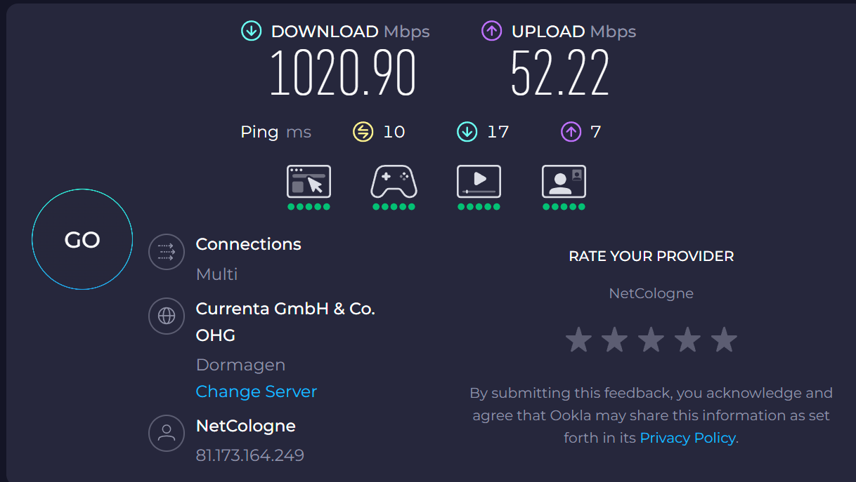

  • Internet upgraded to 1000 Mbit

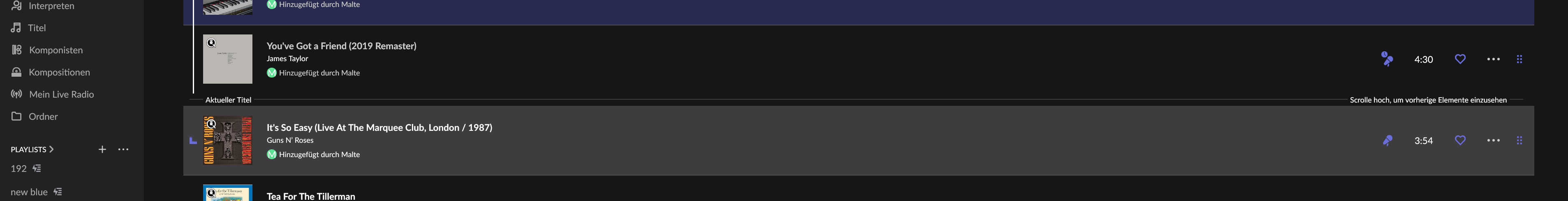

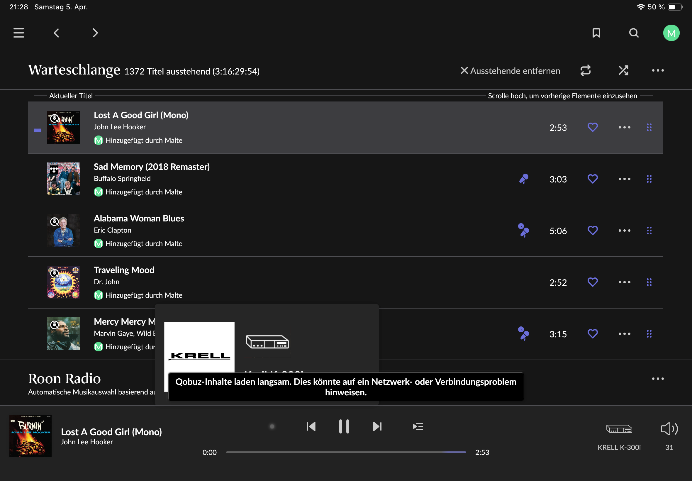

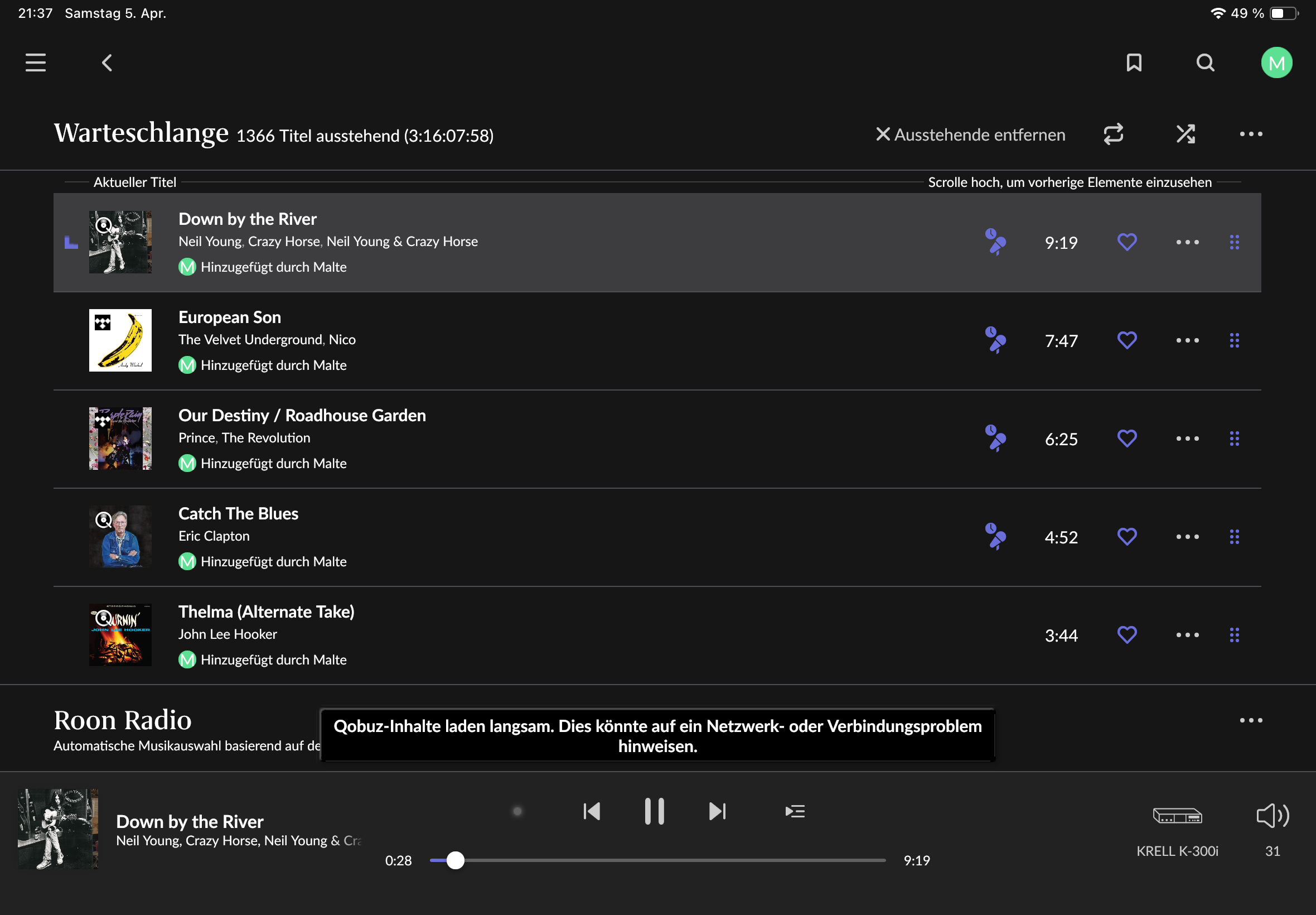

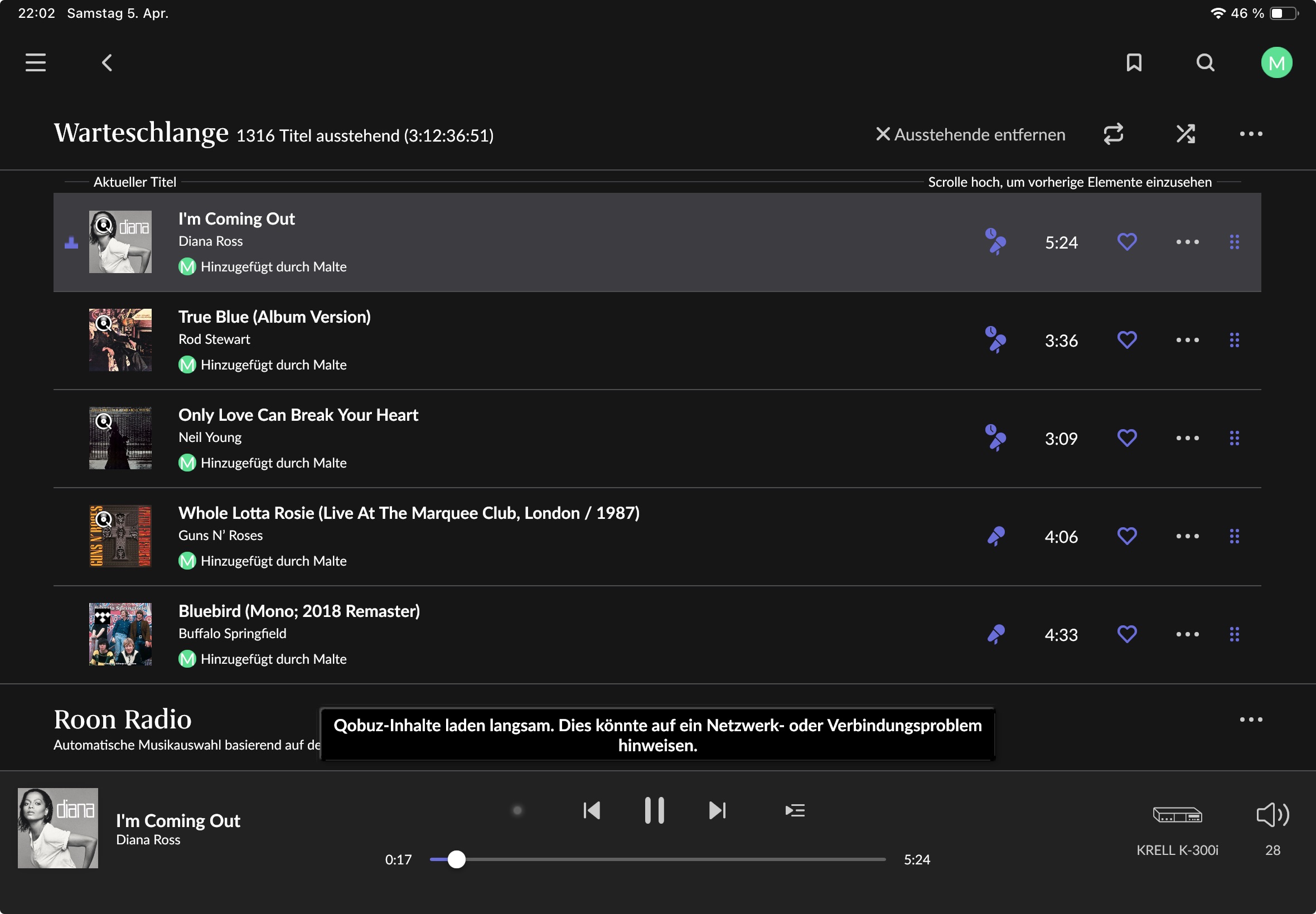

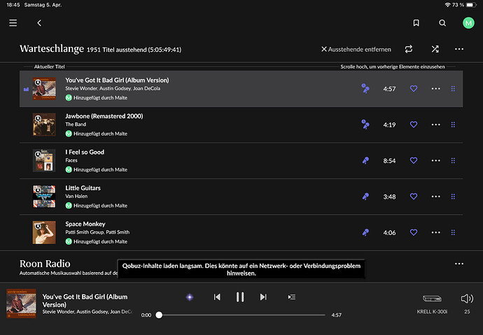

Update#1: 06:48 pm - in Germany
Error was on the Song before, not in screenshot :“The Middle - Jimmy Eat World”
Update#2: 08:52 pm - in Germany; this time I was not fast enouth to get a screenshot
Update#3: 09:28 pm - in germany; screenshot see below - again you’ll see the next song, error was at the song:“Eddie Money - Two tickets to paradise”
***Update#4 09:37 pm - in Germany; this time I was fast enouth to get a screenshot of the song where the error was :slight_smile: ***
***Update#5 10:02 pm - in Germany; this time I get it agian at the right time - to get a screenshot of the song where the error was :slight_smile: ***

Above u’ll see normal “hires” weekend of a “lifetime”-member :face_exhaling: in the last years.

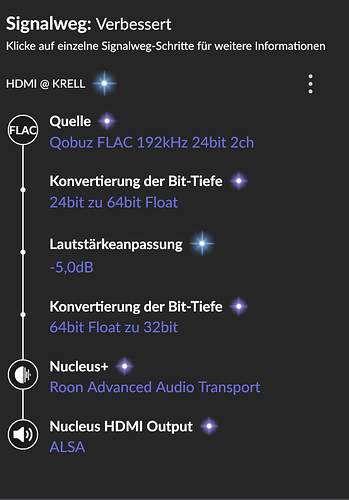

If you try to play back to the Nucleus HDMI zone (even if there is nothing connected), I wonder if there will be errors that show up in logging.

  1. I don‘t use the HDMI, I tried to connect the Nucleus to the Krell via USB, but there where the same issue. —> So I think it‘s Not the path between Nuclues and Krell, I think its the internet Connection in latency or a Router Setting.

You wouldn’t need to have anything connected to the HDMI, if you can just play to it with nothing connected, then we can take a look to see if there are errors in the logging.

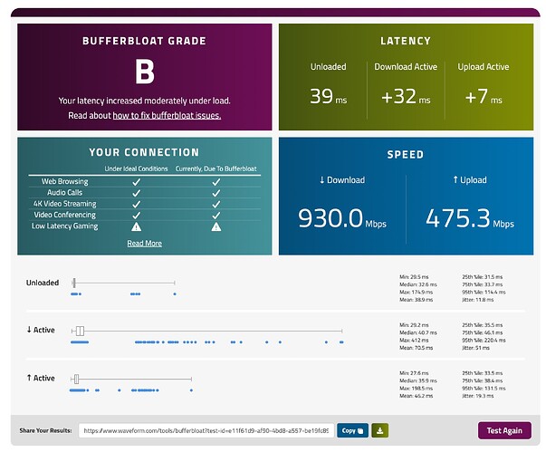

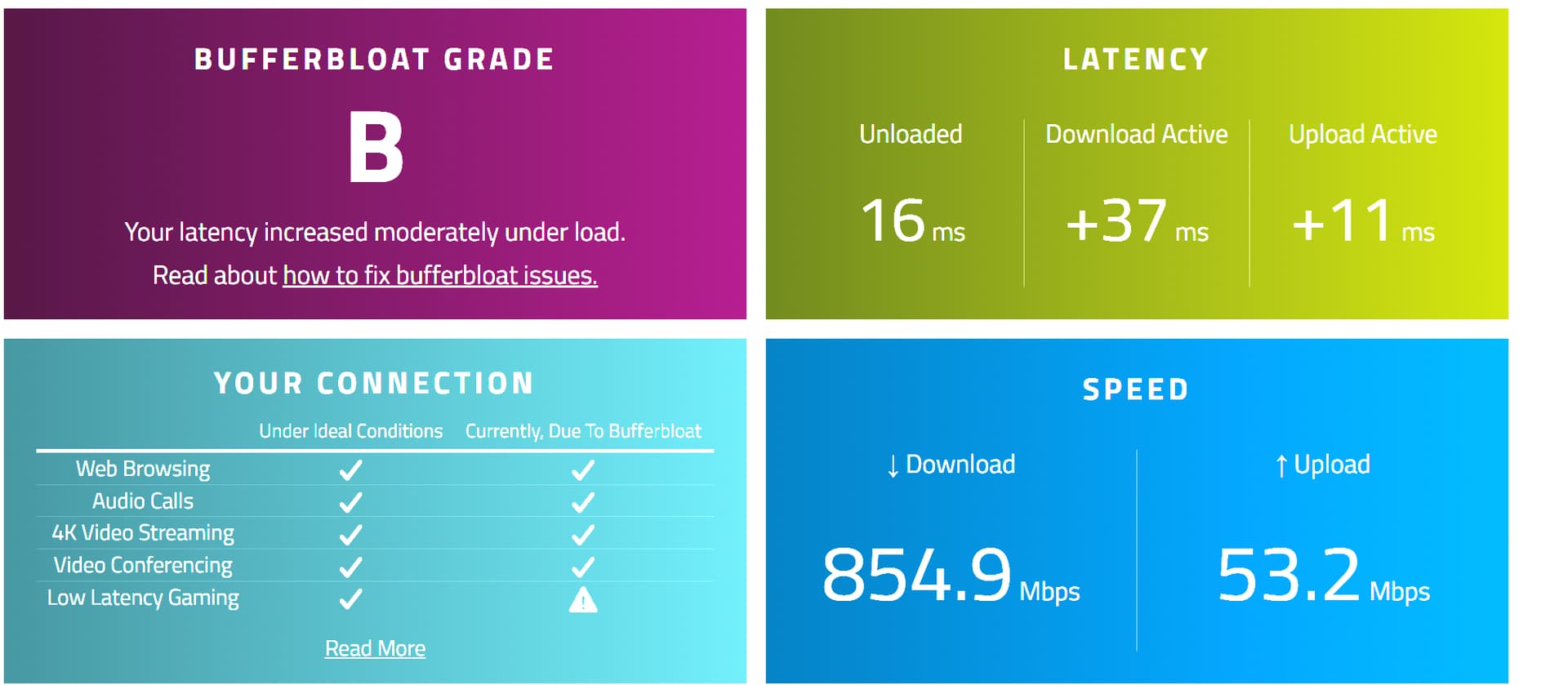

I wonder if this could be an issue with Buffer Bloat, where specific data can’t make it through in time when the network is saturated:
https://www.bufferbloat.net/projects/bloat/wiki/What_can_I_do_about_Bufferbloat/
Do you by any chance have any SQM or QoS settings on the Fritzbox you can try to enable? I found the below guide which may help:

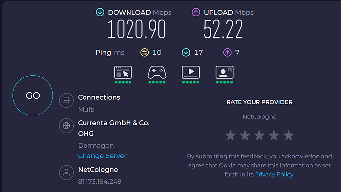

Hello Noris, I’ve already tested all the settings for device prioritization! I haven’t noticed any significant benefits in my network. Maybe it is useful if devices with high network traffic are operated!

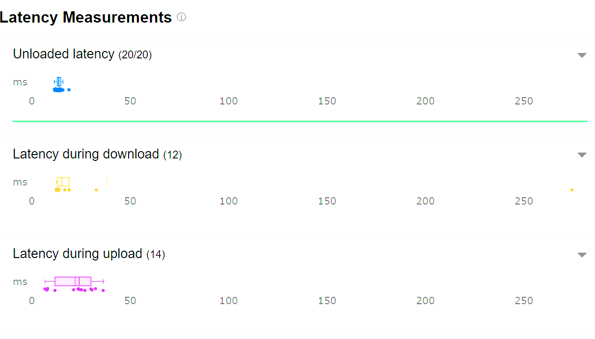

Hi Norris,
here a few replies according to bufferbloat - seemed to be not the best but okay.
Maybe as a shared medium there’ll be the problem dorung peak-time in the evening.

I didn’t have to wait long, at 03:33 pm round about; short after the start of the song: " You’ve git a friend" - James Taylor; it skipped the first time with HDMI.

I can stream 24/192 Qobuz flawlessly all day every day with similar buffer bloat numbers. I even use wireless to my Auralic Aries G2, in fact all my playback devices are wireless.
I currently use a piHole for DNS with cloudfare behind it. Everything was fine without the pihole so that’s not it.
I run an Asus AX88U Pro router. I’m thinking it’s something to do with your FRITZ!Box as @noris has already brought up.
