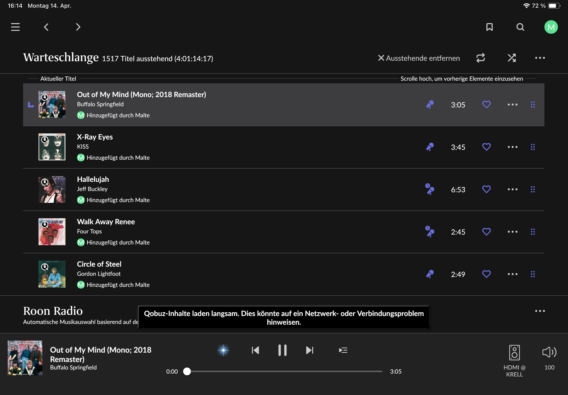

Trouble sometimes with 192khz Audio (Tidal/Qobuz)
So there it is to be sure:

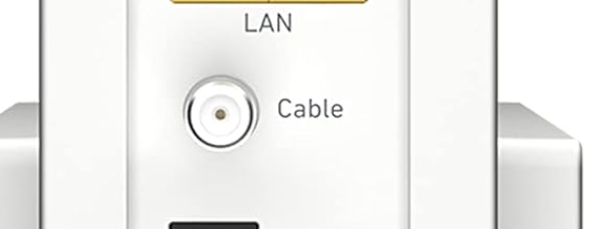

I don’t know if rout or internet provider - to be sure lets make clear what I mean if I called it “cable router”:
This coax connection - is my way into the internet:
And from this type of routers - there are only one firm in germany “AVM” with its “fritz box cable” to join the internet. I wait for the next gen router for year to switch - but I still wait.
I’ll try to find a “cable modem” - router combination in future - check this.

I’m just wondering, why all other combinations like streaming via bluesound/mconnect/audirvana… are working fine - I only got probs with roon.
I assume they implement better buffering and maybe even better error handling.

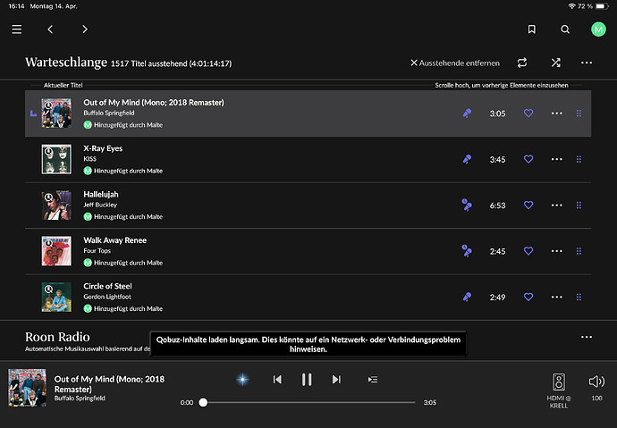

There is no reason Roon shouldn’t improve the server side pulling from Qobuz and Tidal. The number of users that report issues with Roon only is very very high. Some of these issues are from the overhead of RAAT and the users local network. In your case it’s clearly on the Server to Qobuz which you have proven by reproducing the issue via outputting to HDMI on your nucleus.
Hey @Malte_Weber,
Thanks for sharing the HDMI timestamp! We can confirm that we see network bandwidth allocations dropping to zero, and download speeds below the required threshold for smooth playback of the file.
My apologies if this has been glazed over, but perhaps investigating any options to allocate specific network priority to your Nucleus may help here? Fritzbox support may be able to help you with specific steps to do this.
