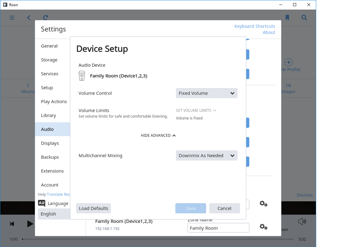

Here is a screen shot of the settings for the PR5 -
