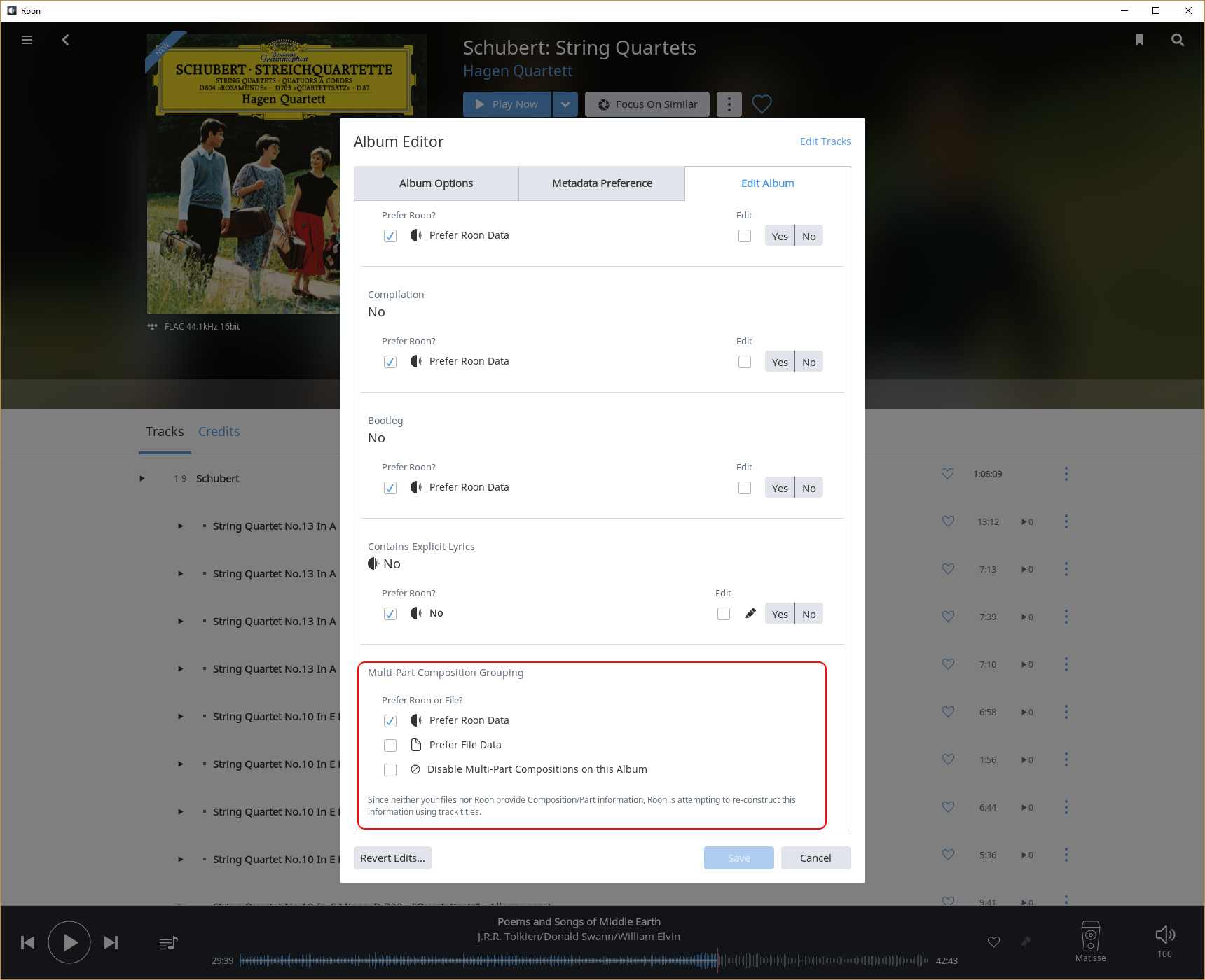

I suspect the only way this can be improved is to flag such albums to Roon ( @joel ) . Because these are TIDAL albums, there is no local metadata that can be tweaked using a metadata editor to give Roon a helping hand.
