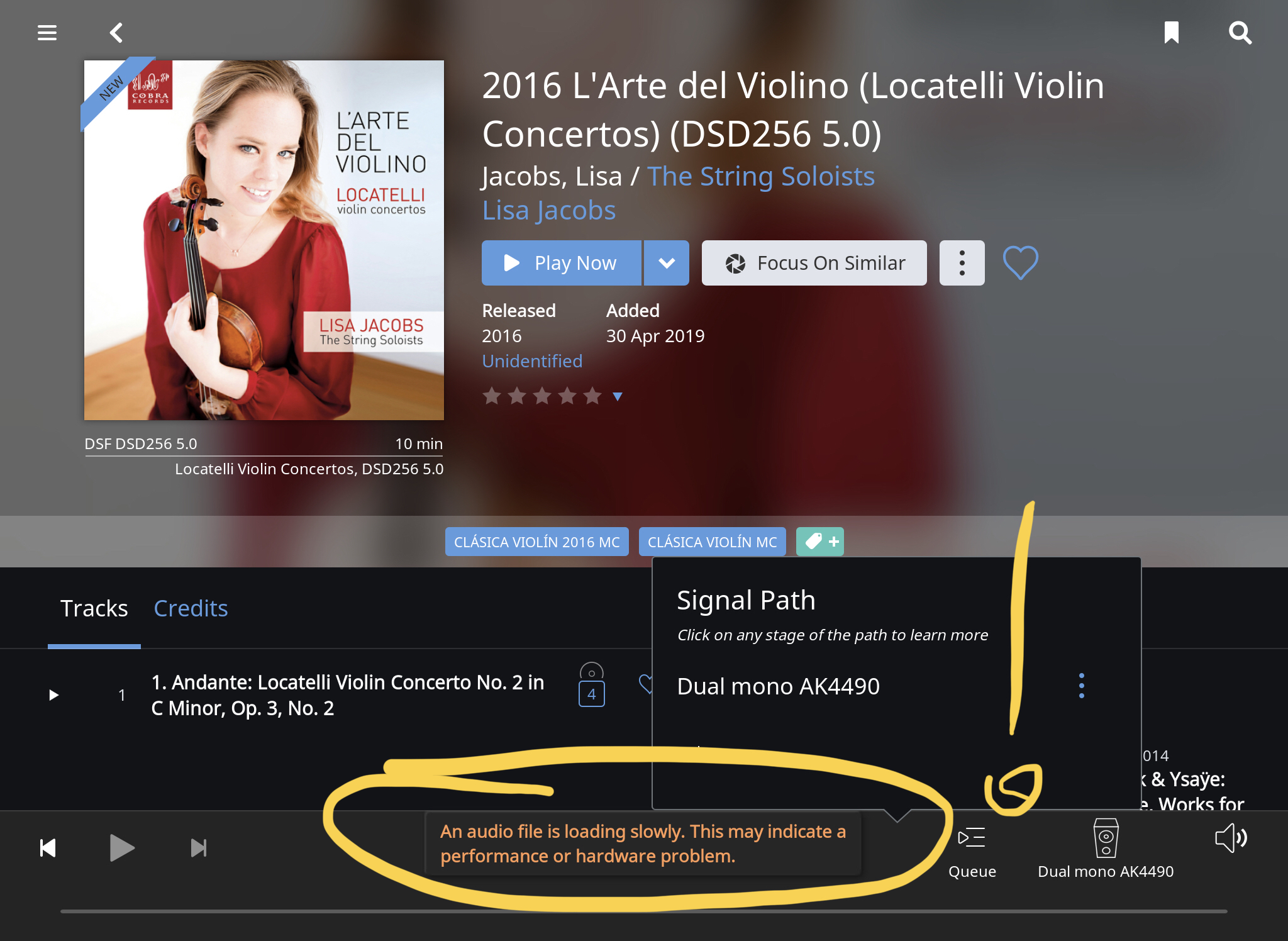

I have a DSD256 5.0 album that I purchased and am unable to play it on my Nucleus+. It will start to play fine but then breaks up and stops with a message of “a file is loading slowly.” Initially the album resided on my Netgear ReadyNAS 516 with the rest of my music. I copied the album to the Nucleus+ internal storage (it was 33GB and took about 8 minutes.). Set Roon to monitor the internal storage of the Nucleus and forced a rescan. Tried to play the album again but got the exact same thing. So I take it that Roon can’t handle this size of file?
I have noticed a general slowness since installing the Nucleus+. Like when I press play it takes about 10-15 seconds before I hear anything. When my core was on my PC playback would start almost immediately. And it seems like I spend a lot of time staring at the Roon logo while the software is trying to do something. I was hoping that with the Core I7, and a dedicated operating system that the Nucleus+ could handle just about anything but maybe not?
