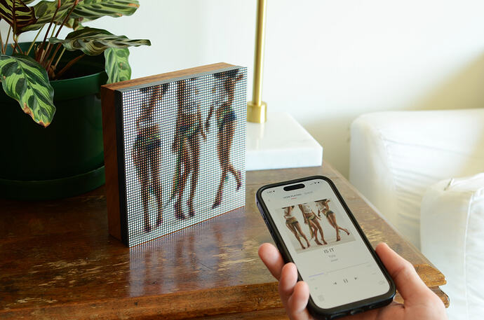

Tuneshine album art display now supports Roon
After a few months of hard work, I’m excited to let you all know that you can now set up a Tuneshine to connect directly to Roon. Tuneshine is a lo-fi album art display that’s meant to be a tasteful, understated, and joyful addition to your living room, office, or anywhere else you listen to music.
A lot of Tuneshine users have been using last.fm as a bridge between Tuneshine and Roon, but I’m happy to say that you can now set it up directly to talk to Roon over your LAN. The integration is completely cloud-free and does not require an account, and the art updates in about <1 second with a couple of options for animated transitions.
I have more info on my dedicated Roon integration page and I’m happy to answer any other questions in this thread.
