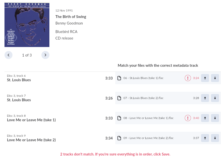

Tracks on discs that are two takes of the same song (both file names & meta data have take numbers in song title) are see as non-matching tracks. It highlights a mismatch on track length, though my dbPowerAmp CD Ripper certified the tracks as matching AccurateRip database. This happens for several songs that had 2 takes. This part of a larger problem where Roon refuses to see the 3 discs as part of a single album.
Hi @Michael_Arones,
Thank you for your post.
Rather than relying on file tags or track lengths for identification, Roon compares each album to canonical versions from its metadata providers, which include expected track order, disc numbers, and track durations. Your rips are accurate, but because Disc 1 contains two takes of several tracks with durations that differ from Roon’s reference metadata libraries for the 1991 BMG release, the system separates it from Discs 2 and 3 and flags the tracks as non-matching.
Once you force Roon (for this particular album) to either prioritize file-based tags or a unified metadata identity, Roon will group everything correctly and stop flagging alt takes as mismatched.

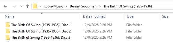

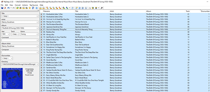

Prior to importing the albums files into my Roon server, I placed the files for each disc in its own folder underneath a common folder that has a folder name matching the name of the 3-disc album (in the metadata). I have done this with many multi-disk sets without problem.
see the below images:
Also, just noticed that sometimes “The Birth of Swing” had “Of” instead of “of”, so I changed that to “of” everywhere in the metadata and file names.
Still grouped as 2 albums, except the Roon album that only includes Disc 3 is now seen as newly added, while the Roon album with Discs 1 & 2 still is positioned back at the original add sequence position (still remembers the old add date?).

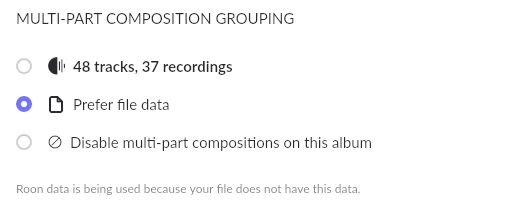

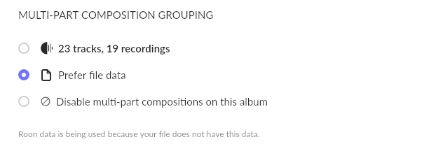

If you navigate to Album Editor screen once more and click on the Edit Album tab, what do you have selected under “Multi-Part Composition Grouping” down at the bottom of that page?
Can you share a screenshot here?
Concerning the Date Added discrepancy: RoonServer retains a database entry for the object even after you deleted it from your library, so unless you fully dissociate the newly imported album from the one you deleted, it will “remember” the first import date. You’ll need to edit the Import Date in the Track Editor dialog window (click on the three dots for this track in the browser → Edit).
Here is the screen shot for the album that contains Disc 3 only
And here is the screen shot for the Album that contains Discs 1 & 2
They are set to prefer file, as previously instructed .

I renamed the sub-folders (one for each disc: Disc1, Disc2, & Disc 3).
The Birth of Swing (1935–1936)/
 Disc 1/
 Disc 2/
 Disc 3/

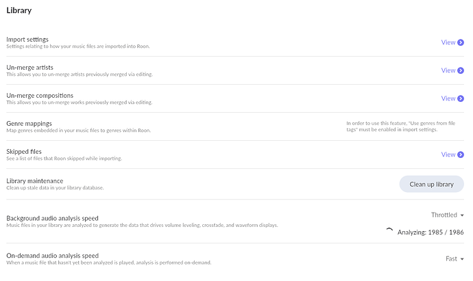

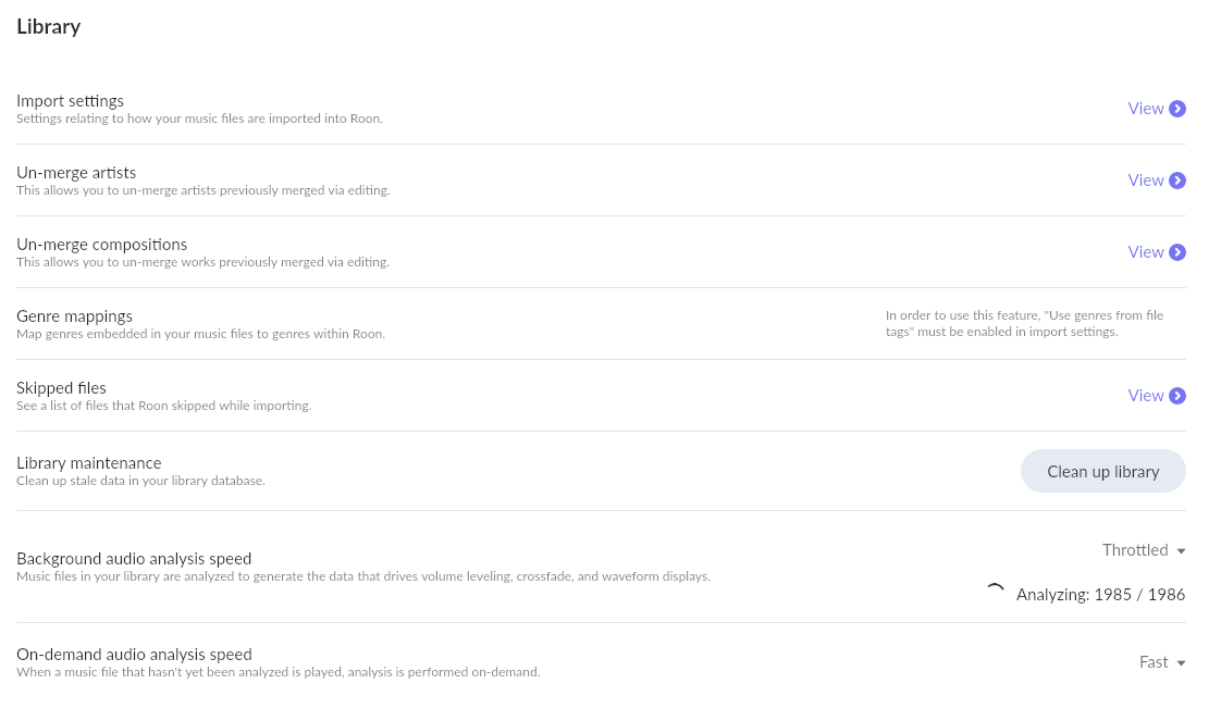

How long should it take to do a “library cleanup” with 2,200 albums residing on the Nucleus One provided internal storage?
Just for planning purposes …
Library clean up removes releases from the database, so it should take seconds not minutes.
Thanks for the advise. I need to add a task of “Library Cleanup” to my workflow for each & every time that I delete an album to make adjustments before re-adding.

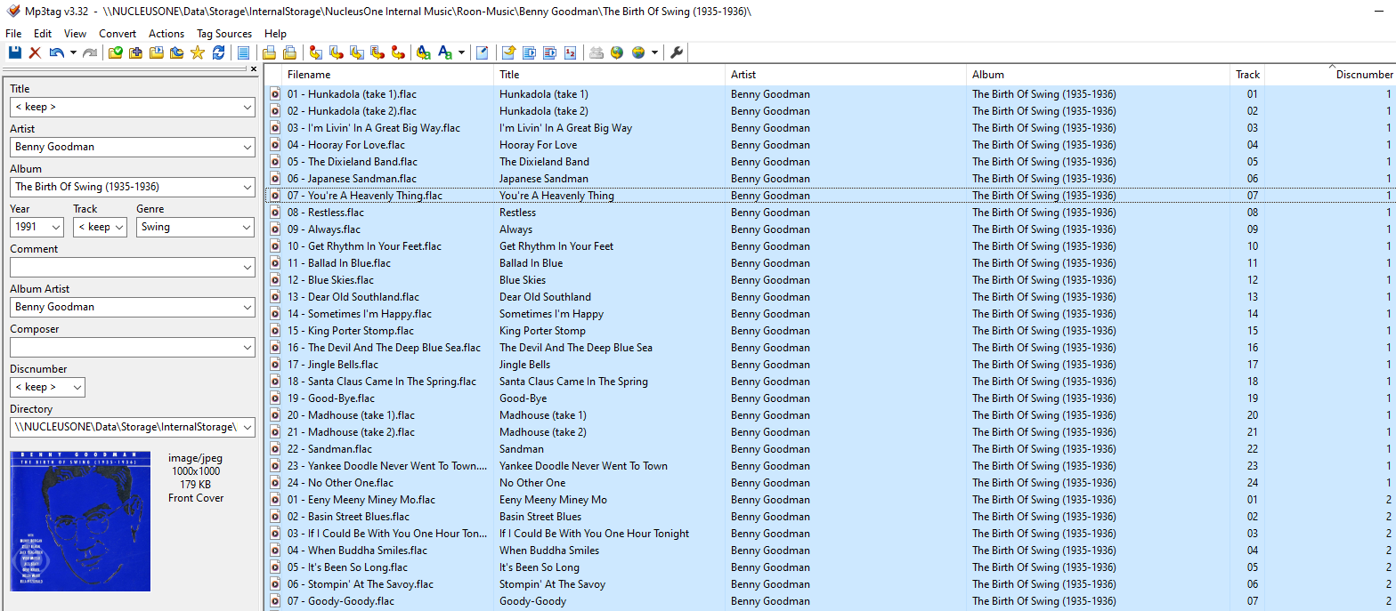

I understand that can happen if the folder hierarchy (with correct file naming) and file metadata is not carefully setup for Roon software to properly process.
But I have reviewed everything (including metadata via mp3tag) and do not see any issues.
