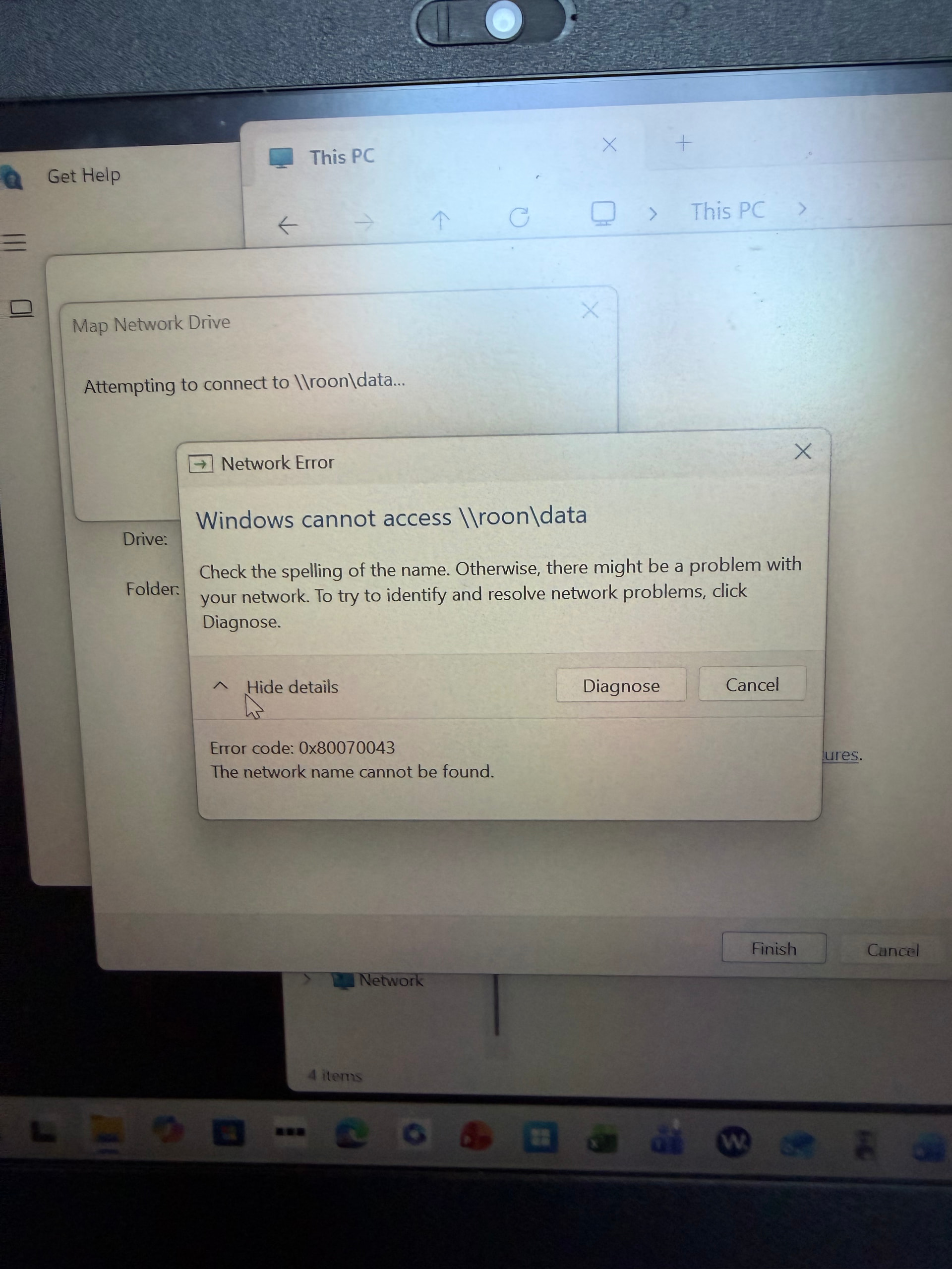

Only issue (there is always an issue) is that the (new) roon rock does not show up on my windows pc. Somehow I had mapped the previous server but the pc just won’t play ball. My PC had the various settings amended that “the internet” recommends to enable network sharing but keep getting nowhere - see photo attached.
Is this a common issue with Windows?
I have a Mac as well and can see the server through this, but as I use the PC to rip CDs to the hard drive attached to the room rock I really need to be able to access it from the PC.
Any (more) sage like suggestions?

Thanks for reaching out. Based on your description, it looks like Windows is blocking access to the Nucleus/ROCK internal storage due to its security settings regarding “Guest” access.
This is a common behavior in recent Windows updates (10/11), where the system automatically blocks network shares that don’t require a password. Since Nucleus is designed to be accessible without a password for convenience, Windows essentially puts up a barrier.
We have a step-by-step guide on how to adjust this setting in Windows so you can copy your music files:
Please give those steps a try and let me know if you are able to connect afterwards!
Hi Vadim, after lots of trial and error I have a (currently) working fix. I used the roon rock’s fixed IP address to map the drive \\[RockIPaddress]\data and that seems to be stable. I retried \\roon\data and it does not work but guess I should be happy to have a solution. Thanks for your help.
I don’t know why this should work. For ROCK the default path is \\ROCK\Data (see the guide linked in the post above yours).
Sorry - I meant \\Rock\data does not work. Apologies for my mistake.
