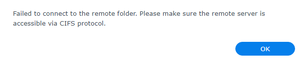

Currently for some reason I am unable to access my ROCK NUC device using CIFS (it worked fine in the past). When I checked the ROCK settings, I noticed that the DNS server is set to 0.0.0.0 (I have it on DHCP), the gateway and rest is fine, but the DNS is odd…I doubt this has anything to do with the CIFS access issues but thought to check with you.
The error that Synology throws back is:

Hi, I managed to access the Rock device after modifying the Windows Policy settings to allow anonymous access. I also figured out why accessing the Rock device via Synology CIFS remote folder option was failing.
I was using \rock\storage\data as the path, and it kept rejecting this, it was only after I used \rock\data instead of \rock\storage\data as the path that it worked.
