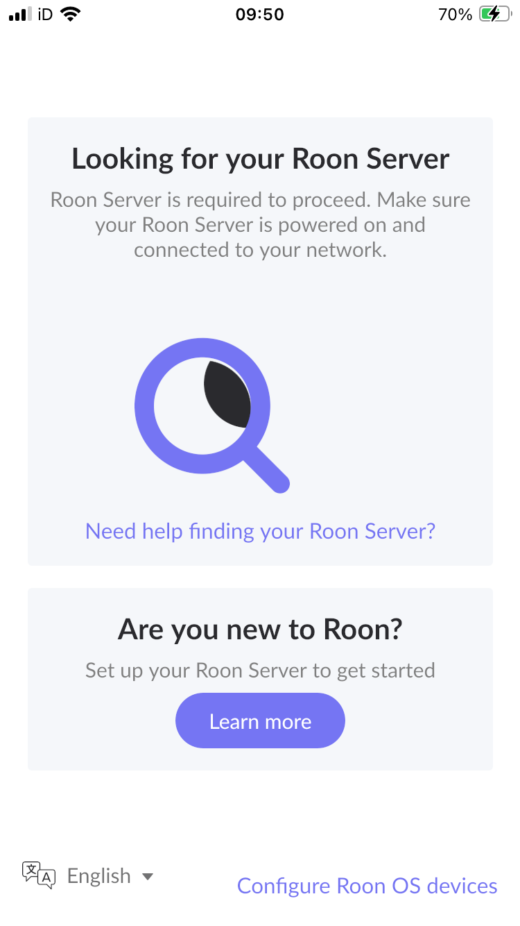

Basically the interface is flashing
and here we go again…
so the server was updated and i got the flashing screen on everything that I try to access Roon on, phone, mac etc
So then I reboot the server and yet again it defaults back to the older version of the soiftware, and so begins another 4 rounds of updating, flashing screens, not able to play music, reboot server and returns to older version
This happens on every single update

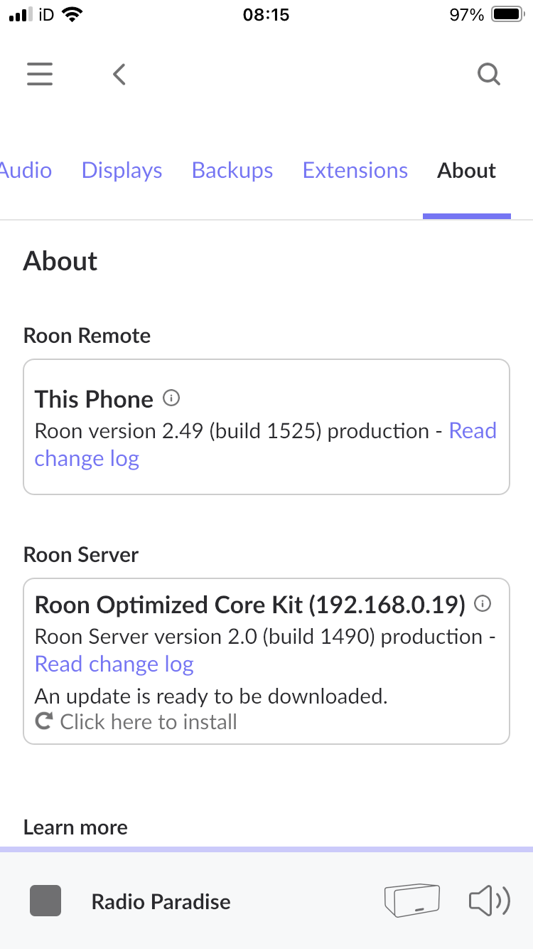

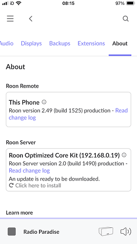

Just to confirm, it reverted back to build 1490, as it did in the past? I’m looking over your latest log set from the ROCK, but there is no indication that the update past 1490 took place. Can you please create a Backup of your database and then try an Operating System reinstall via the Web UI?
Thanks. I have done this but please note I did this last time there was an update and whilst its working perfectly now i will wait for the next update
